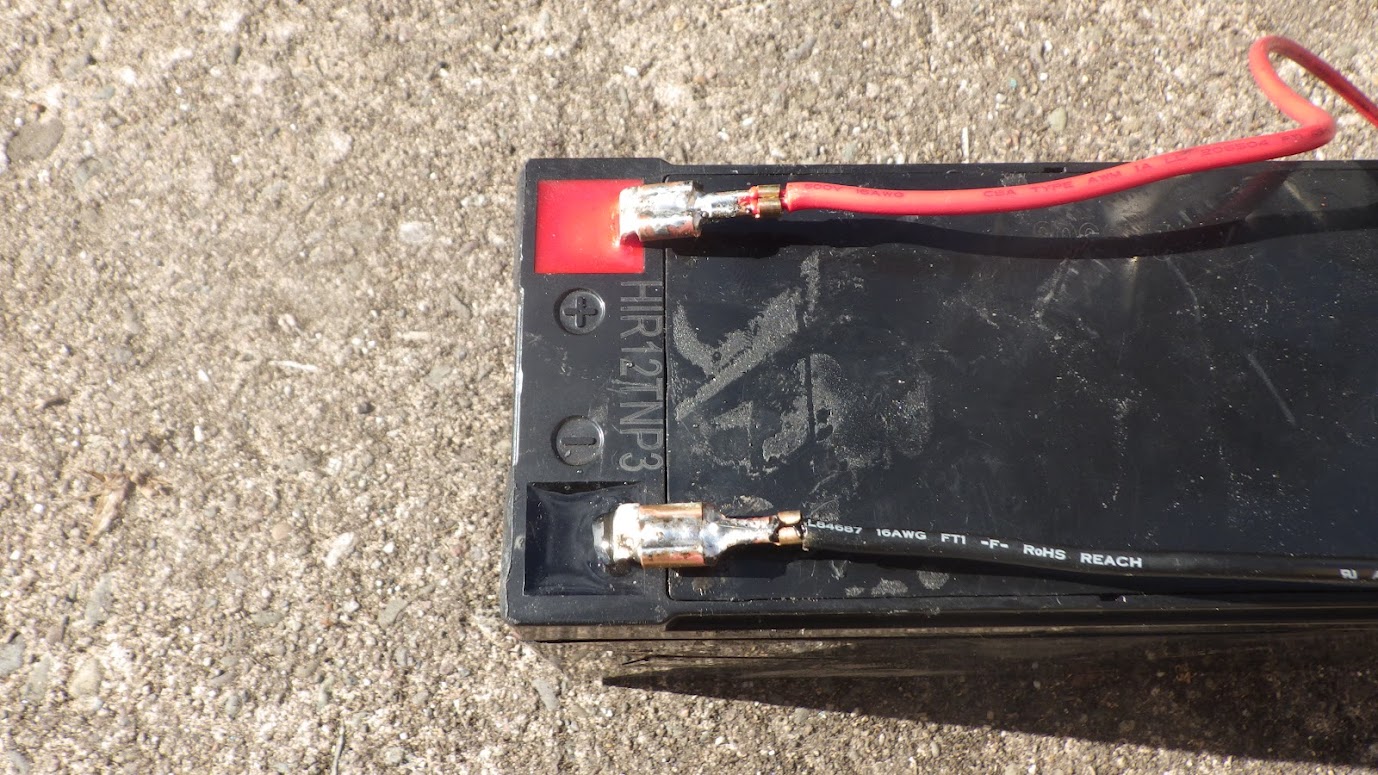

Would you believe it, got 20 miles from the ferry and it conked out, in almost the exact same spot!. This time though it was quickly traced to the battery lead having come off. Two days later it conked out again because it turns out the intermittant battery connection had fried the reg/rec and I had been running on total loss. No matter, a spare battery was procured and I just charged it every night. Fantastic tour of the picos and Portugal and the bike ran brilliantly.
https://lh3.googleusercontent.com/pw/AL9nZEXuQSbK2yqPQ5dKx8_hoAvIkrzDqBT3ZRXJeKuy2KmqNU3rEVjfAPJUWZwZu47wNinoFOHaascq0Eo7B-OpzPGog-oZE4VUFeATew4RiuZ0tBoth45k3sQFwD9QJ2cClGTAahxTHoxGCVh9d5JQfpFv=w1378-h776-no
Made sure the battery leads wont come off again!
