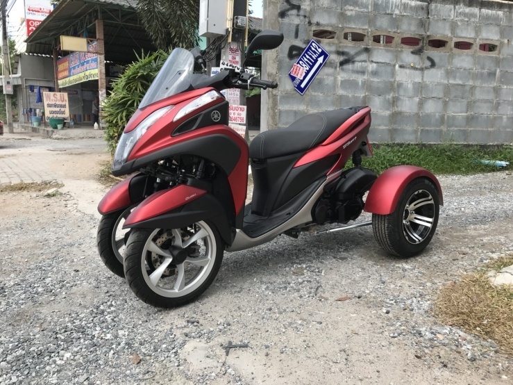

Thanks for your reponse, There is actually a company named Ozimoto that makes these Trike conversion kits for the Tricity. (Pic down below). however the problem is, is that the Tricity is leaning like the Niken. So giving it a static back axle makes it very dangerous to ride, much like a quad. Also it makes it more impratical since it will be much wider.
https://tweakers.net/ext/f/RHxsCBbLhEMAVLnAVEv5SaQJ/full.jpg
My best bet would be, since I doubt spacers would exist is to find Rims that have suitable size and have mounting points that are up to 4 cm more deep. This way the tires will be 4 cm further from the middle of the bike, which is the distance that is measured. This way you would avoid adding any unnessary parts to the wheels. But I am curious whether such rims exist.

I was thinking about the licencing/registration too.
However, that aside, I will drop these nice pics in for discussion. The idea should be clear enough. Tricity/Niken. Niken/Tricity. I expect there would be "interesting considerations". Don't strain yourself thinking or say fork off Smile
What, so no-one's pooh-poohed the idea yet?
