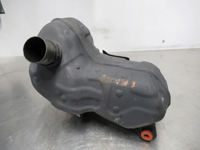

I'll have another swap about with the contents of my shed plus a few minor bits I have on order but another alternative might be to put back the damper box:
https://i.ebayimg.com/images/g/CpwAAOSwbd1jq343/s-l640.webp
And then skip an end-can altogether:
https://www.pro-race.co.uk/wp-content/uploads/2022/10/HUSQVARNA-VITPILEN-401-2018-2019-GP-S1-SHORTY-GP-EXHAUST.jpg
BTW The cat's in the OEM front section, the box is just a series of chambers. I would leave this option as a last resort as the box is pretty heavy, neat look though.
