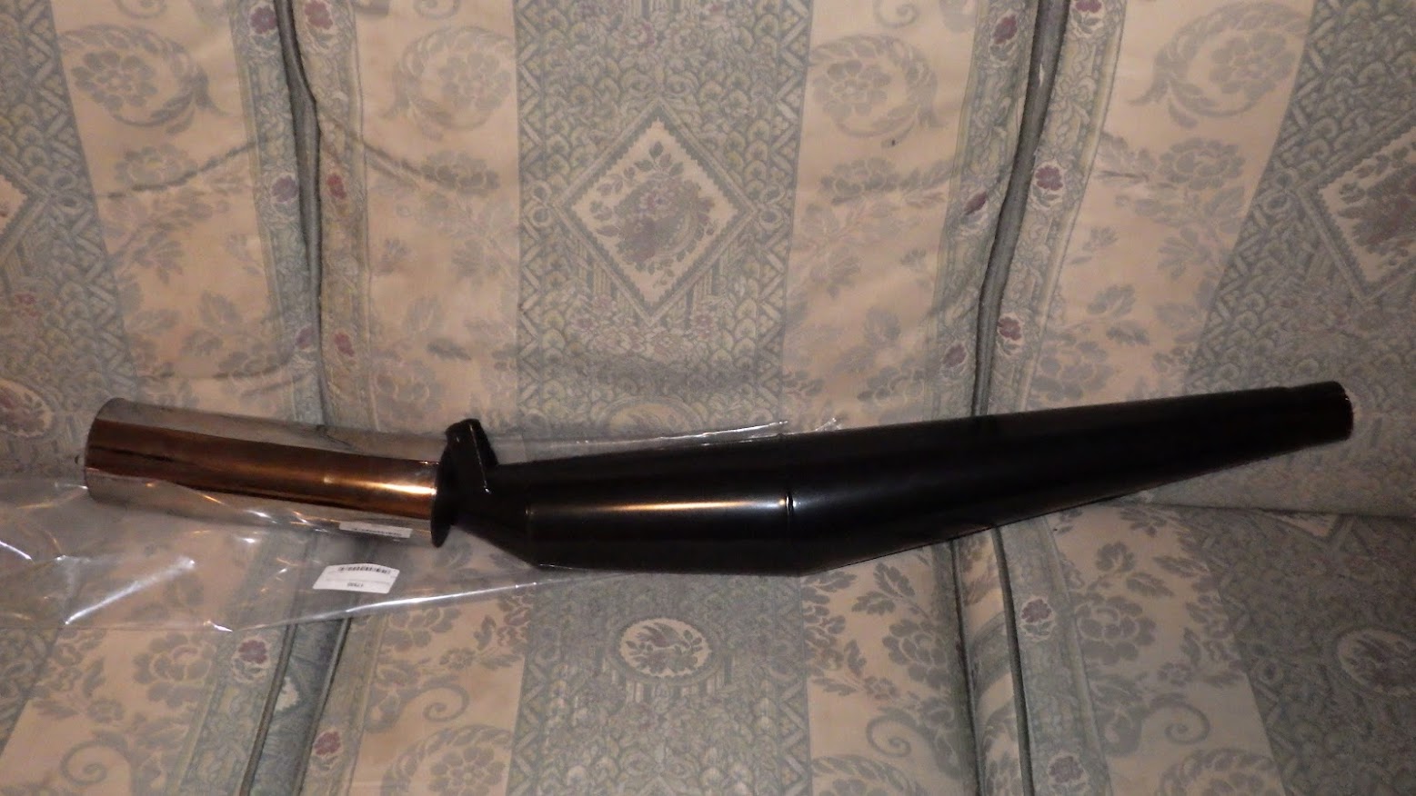

PostPosted: 19:47 - 29 Aug 2024    Post subject: Reply with quote
Since the Minsk and MZ125 are both based on the same WW2 DKW design, I did some looking. Bore, stroke and port timing are identical. So the pressure wave dynamics should also be identical. They race MZs. So I got to wondering...
... Apparently yes they do. And only £55 delivered from Germany. Header is the same diameter, bracket is about 3" out. I feel my future may involve some plug chops.
https://lh3.googleusercontent.com/pw/AP1GczM7_P3s-I9oSXIGKRBRaiEyvocUD1iOg44EmgeMRj5YKX4Aau0LOqULjX8TCE0JphX0SHILyXKuh8Ra927qKvPMLbcQxCrFhFLrjuecqsIYbAr1hr33NEY0FAhbzO8H6inLKNtbbi6bj2iwSwYND2D3=w1557-h876-s-no

PostPosted: 20:38 - 29 Aug 2024    Post subject: Reply with quote
MarJay wrote:
I had one of those on my MZ. Sportauspuff!
I'm not sure it did a great deal, but I liked it.
Got to be better than what's fitted, the existing baffle is coming apart, I farted the rear cone back on with my welder but it was wishful thinking, there wasn't much actual metal left and it's now making the classic hitting a baked bean can with a pencil noise suggesting the seagull shit weld has left the chat.
This whole system cost less than a baffle from Ukraine.

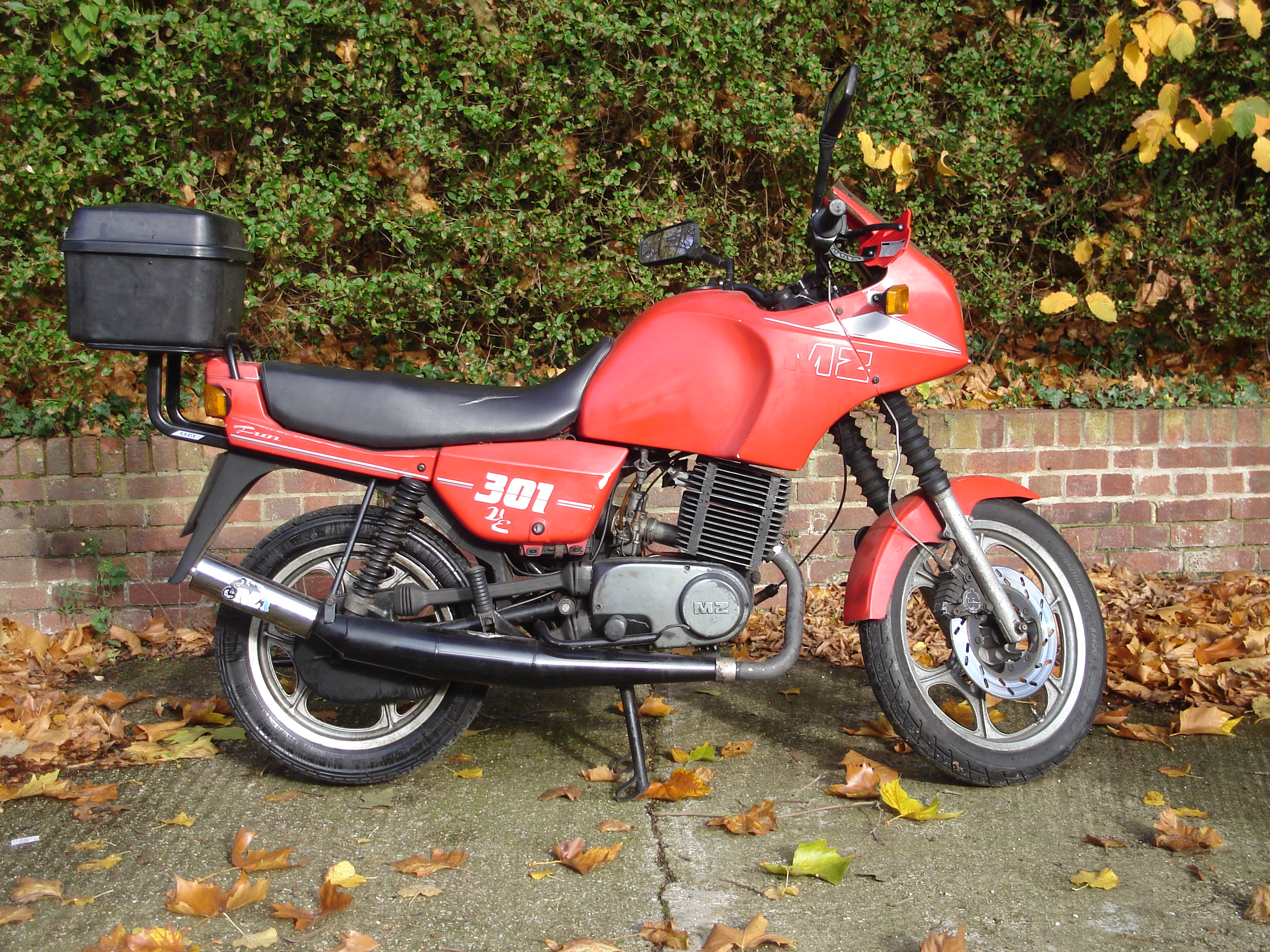

PostPosted: 17:41 - 16 Sep 2024    Post subject: Reply with quote
I found this pic the other day...
https://www.bikechatforums.com/files/dsc02021.jpg
British beauty: Triumph Street Triple R; Loony stroker: KR1S; Track fun: GSXR750 L1; Commuter Missile: GSX-S1000F
PostPosted: 10:53 - 17 Oct 2024    Post subject: Reply with quote
Well, the exhaust bolted right on with a very simple bracket. It rode fine, not much different to the original one in fairness.
Out of curiosity, I decided to take the end can apart to see what was going on in there. Turns out it's literally a metal cylinder stuffed with fibreglass packing. Doesn't even have a baffle tube in there, there's just a long spring to stop the fibregalss from completely obstructing the gas exiting.
So no stinger on the end of the expansion chamber and a surprisingly wide exhaust diameter. I decided to make a baffle tube. Used a piece of alloy tube, necked it down with a steel insert at the exit from the expansion chamber so the diameter is the same as the standard, then a 12cm stinger section then perforated the rest of the way. All bolted back together easily with the packing round the outside of the baffle tube.
Immediate transformation. Crisp, rattly exhaust note which I associate with a properly setup 2t exhaust. Way quicker off the throttle, fewer "bung-bungs" on the overrun which means it's scavenging well. Had to wind in the idle screw significantly so it might need a larger pilot but frankly, it hardly ever uses low revs unless you're stopped in traffic and the idle is very stable. Picks up well from no revs and pulls much better through the midrange, I can stay in top gear up hills I was having to downshift for previously.
It would probably stand an extra tooth on the front sprocket now, although I might do some light offroading on this bike becuse it's very capable on dirt so I'll probably just leave it as-is.
A plug chop showed a nice clean, brown electrode but I tried the next jet size up just to see. That was too much main, caused it to bog between 3/4 and full throttle unless it was absolutely flat-out so went right back to standard jetting.
Saw 50mph on it, which is a first. Money well spent, although the standard setup on that exhaust was very shonky. I'm guessing it's for noise reasons because it is a tad on the loud side now. Probably not enough to have people tutting as you ride past but if you were doing laps of the town square all afternoon, I could see people getting annoyed.
The postman says he loves the smell coming out of my garage when he delivers the mail. Smile
