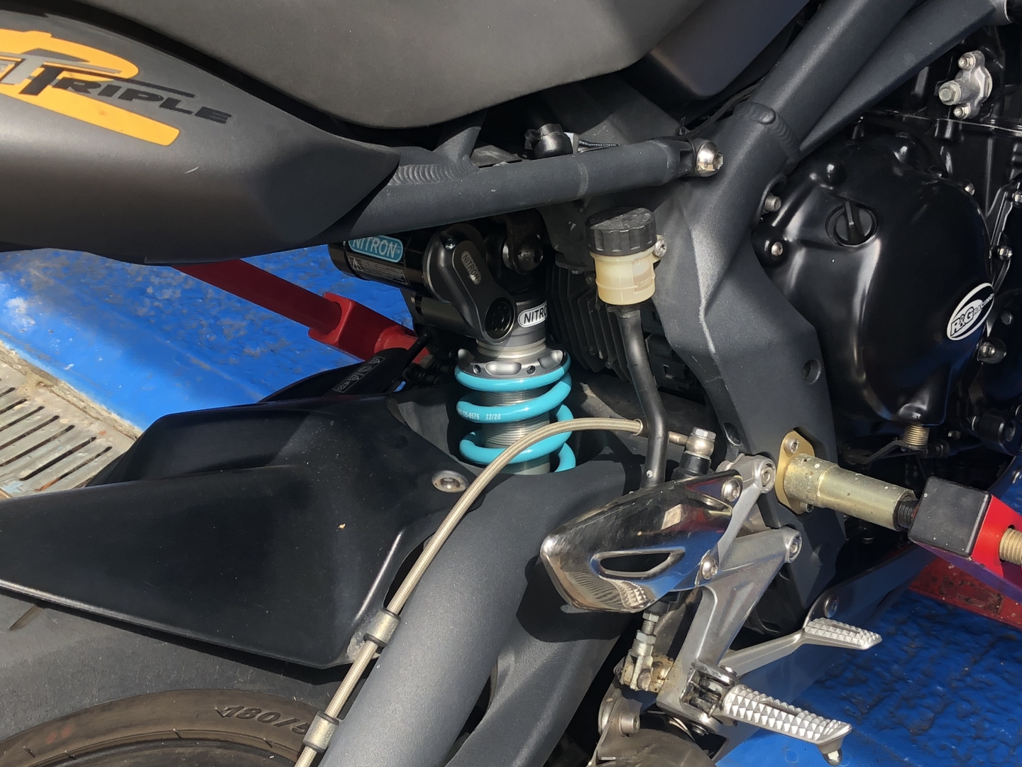

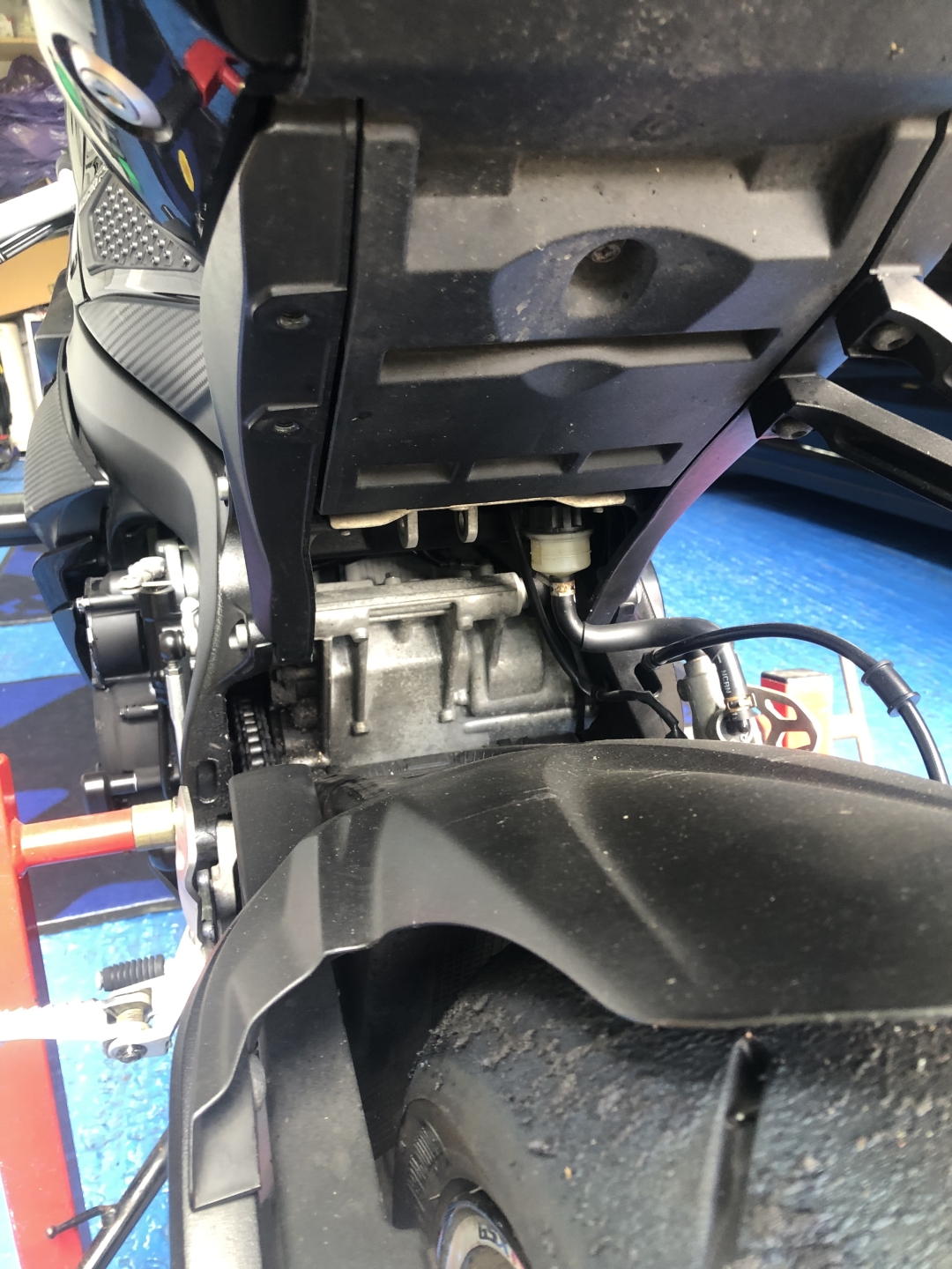

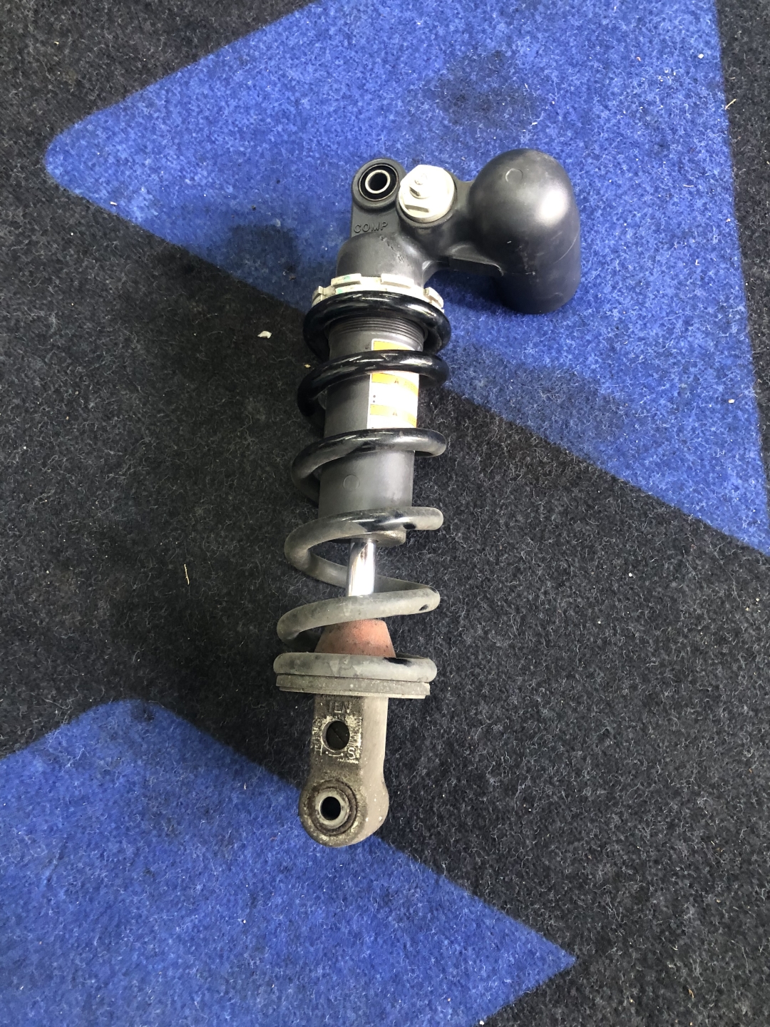

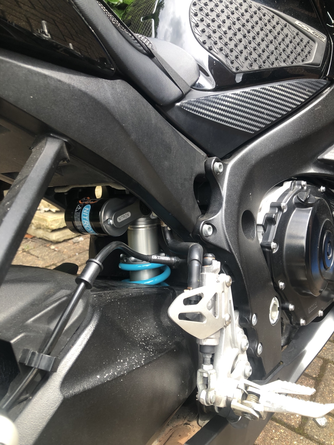

PostPosted: 07:43 - 15 Jul 2024    Post subject: Reply with quote
A story told in pictures:
A pile of boxes
https://www.bikechatforums.com/files/1440img_8381.jpg
Oh no! Something is missing from the GSXR!
https://www.bikechatforums.com/files/1440img_8387.jpg
Ah, there's the offending item!
https://www.bikechatforums.com/files/1440img_8386.jpg
There. I fixed it!
https://www.bikechatforums.com/files/1440img_8388.jpg
Another bike seems to have had the same issue:
https://www.bikechatforums.com/files/1440img_8390.jpg
Next week the same will hopefully happen to a Suzuki GSX-S1000F. Although the removal process looks a LOT harder because of the location of the shock top bolt...
