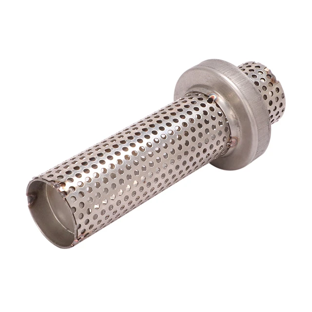

Slightly quieter but I didn't like the tone Thinking Then I tried this sort:
https://ae01.alicdn.com/kf/H7054d2fa8da64809b90681ef4e564b98Q.jpg_640x640Q90.jpg_.webp
Which sandwiches between the link pipe and the end-can. The result, audibly, was pretty good - not so loud you can't talk over it at idle but nice and meaty with some throttle. BTW I had the seat off while testing and there's a lovely induction note with the new air filters Smile
