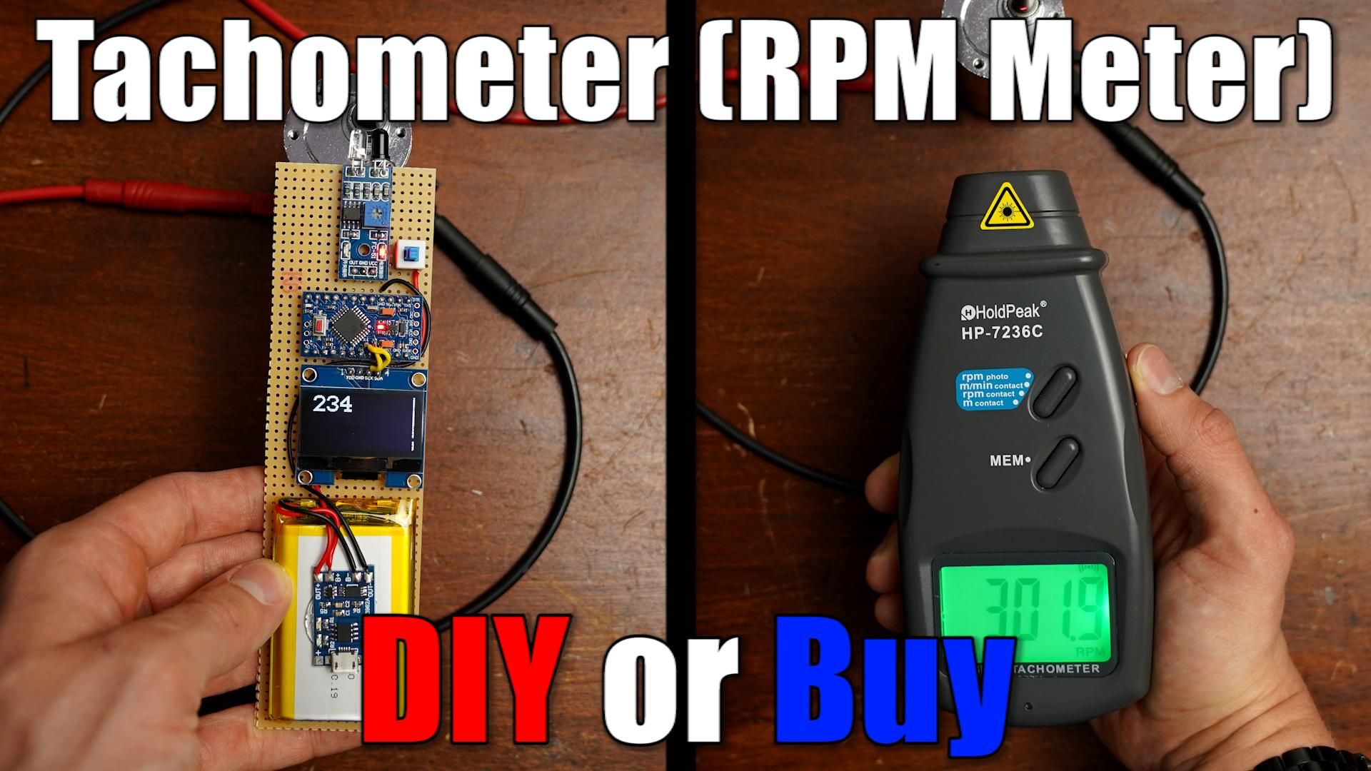

What about a flat pack lipo cell and the tiny PCB with mini USB port?
Like on the left of this pic
probably cos about a tenner for both max.
I think I got one in one of me 'electronical gubbins' boxes
You get 5V out of them but think the Pico will take a 5v supply.
That's an Arduino pro mini in the pic by the look of it
https://content.instructables.com/FSQ/FMIA/KEPOKYW0/FSQFMIAKEPOKYW0.jpg?auto=webp&frame=1&width=1024&height=1024&fit=bounds&md=MjAyMC0wOS0wNiAwNDozOTo1Mi4w
