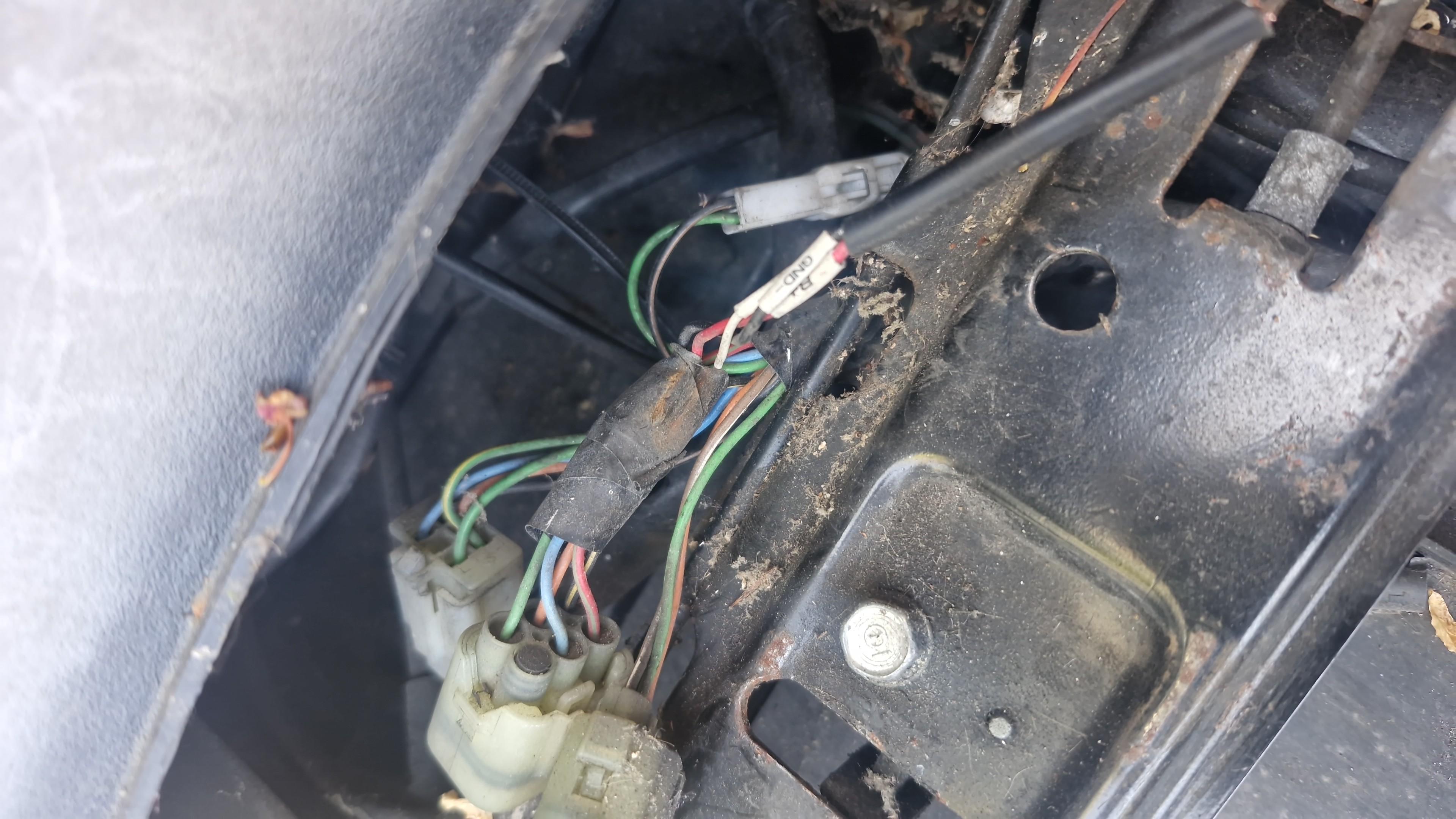

Rats nest under the seat
https://www.bikechatforums.com/files/20250109_160839.jpg
Multiple earths taped together
https://www.bikechatforums.com/files/20250109_160920.jpg
Multiple lives taped together
https://www.bikechatforums.com/files/20250109_160834.jpg

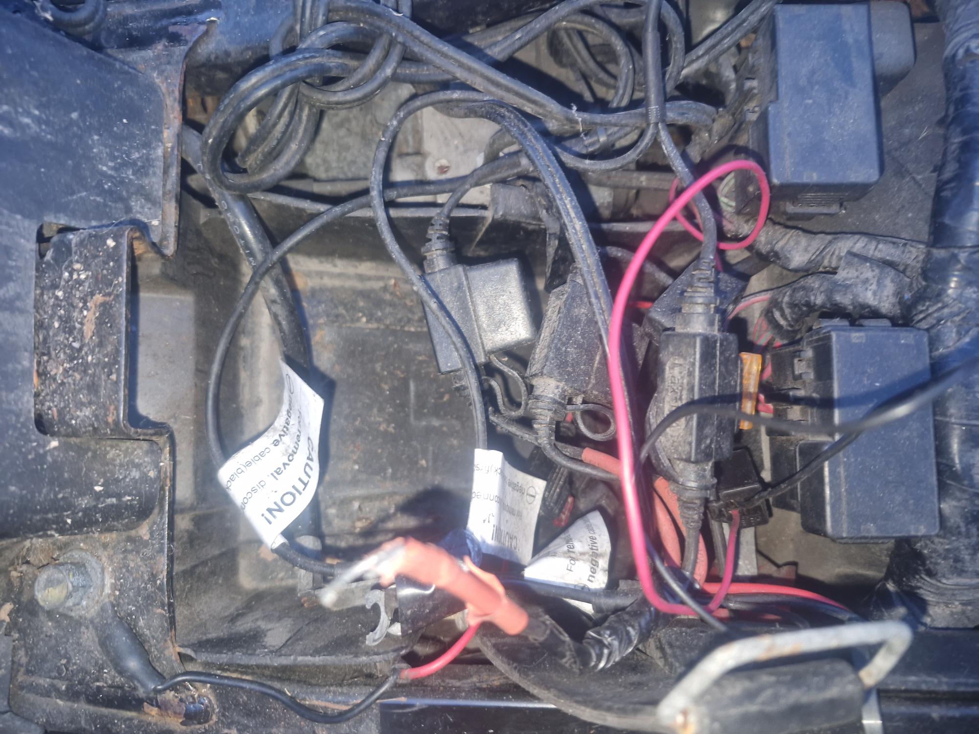

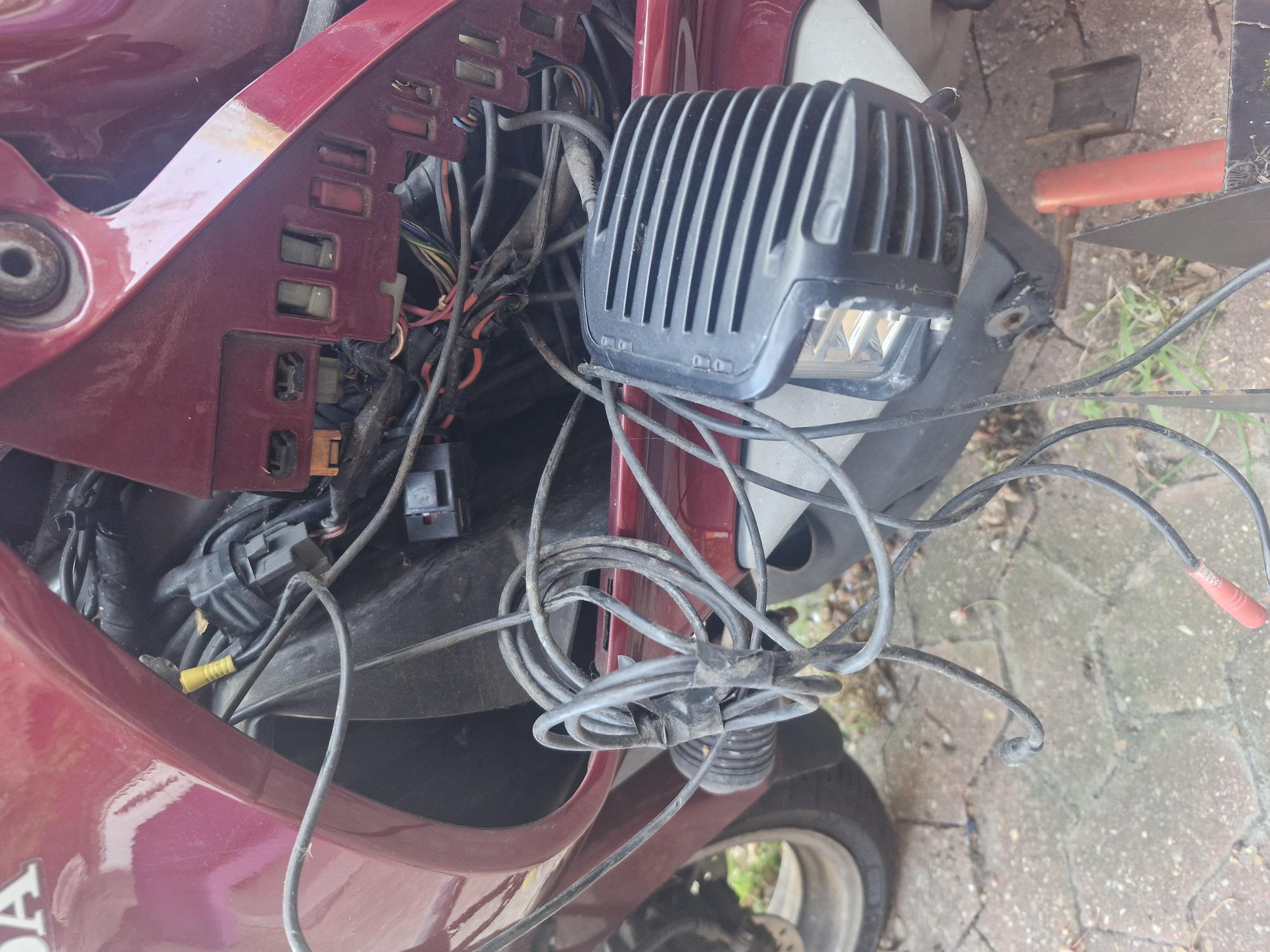

Had some more time today so started taking it apart and found more horrors. About 60%+ of the bolts are wrong, too long, too short, wrong machine screw etc and a fair smattering of panel nuts instead of the correct fittings.
There are cables coiled all over the bike, under every panel.
https://www.bikechatforums.com/files/20250429_154743.jpg

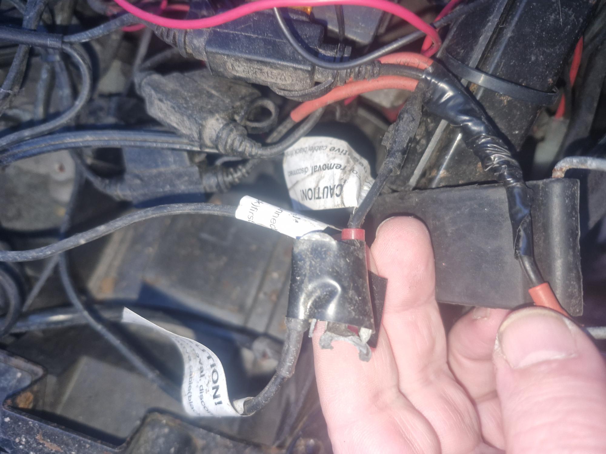

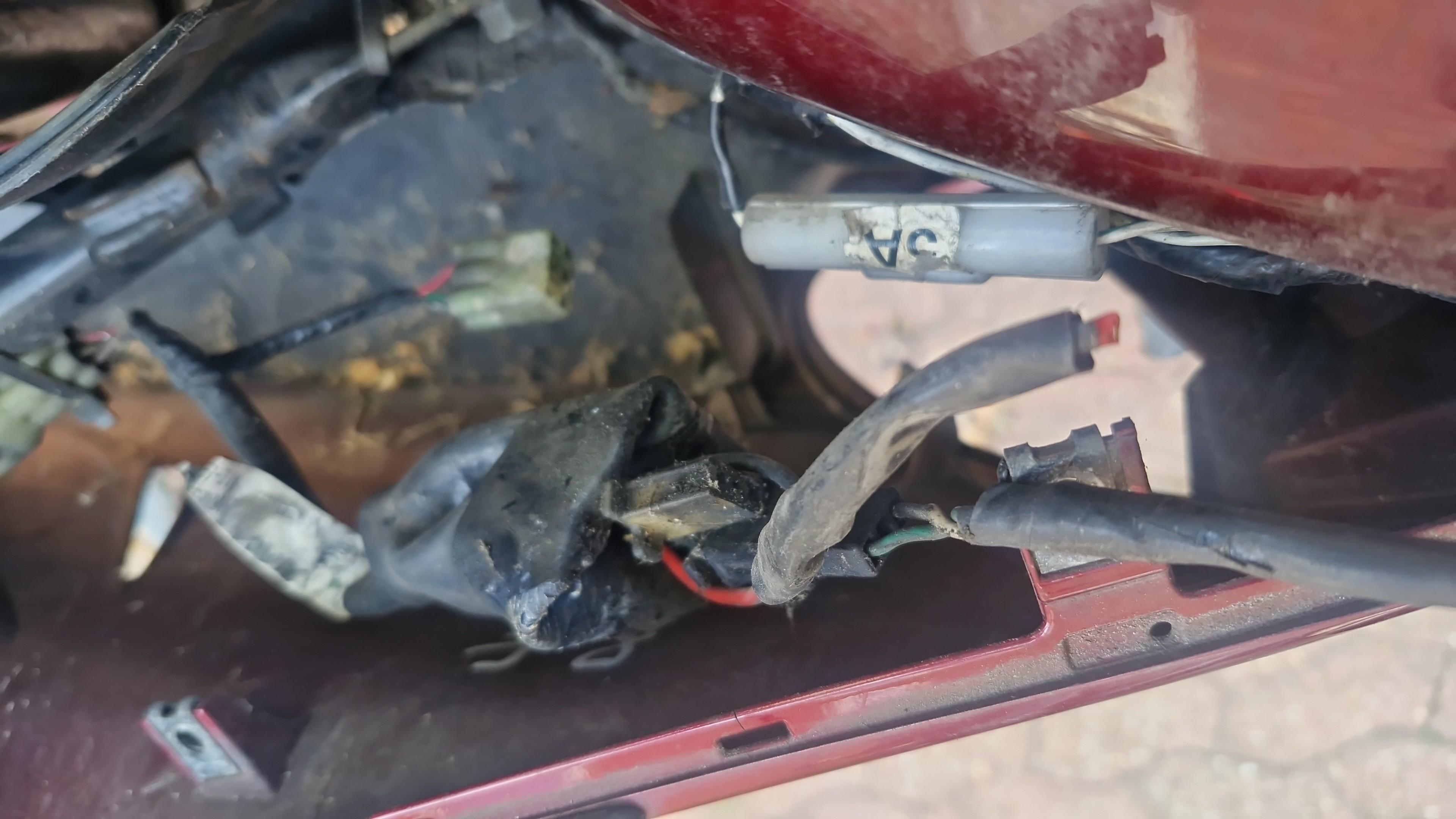

The mechanics who fitted the heated grips decide not to use the fitted multi connectors and changed them for 4mm bullets which are too big then wrapped them with insulating tape so there are snake bellies everywhere.
https://www.bikechatforums.com/files/img-20250429-wa0010.jpeg
The heated grips were so badly fitted that although they had a mount to bolt the controller to the front brake master cylinder, it was cable tied to the handlebars.

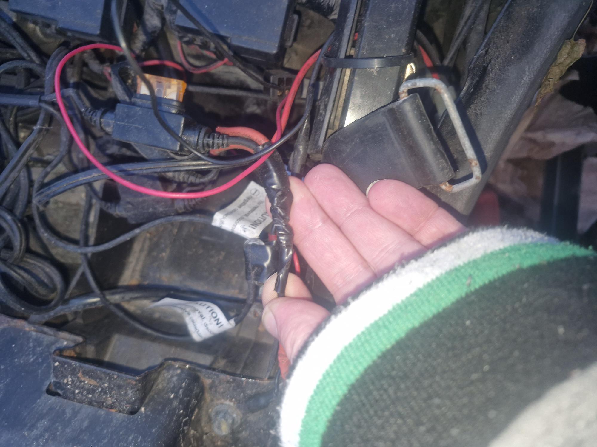

Deauvilles have an accessory called a 'Quartet harness' that plugs in and gives 3 powered points to add spot lights, heated grips etc. Instead of using this fully, it has one fitted, the previous mechanics hacked into the loom.
One item was plugged in the Quartet harness and then another bodged into it.
https://www.bikechatforums.com/files/img-20250429-wa0016.jpeg

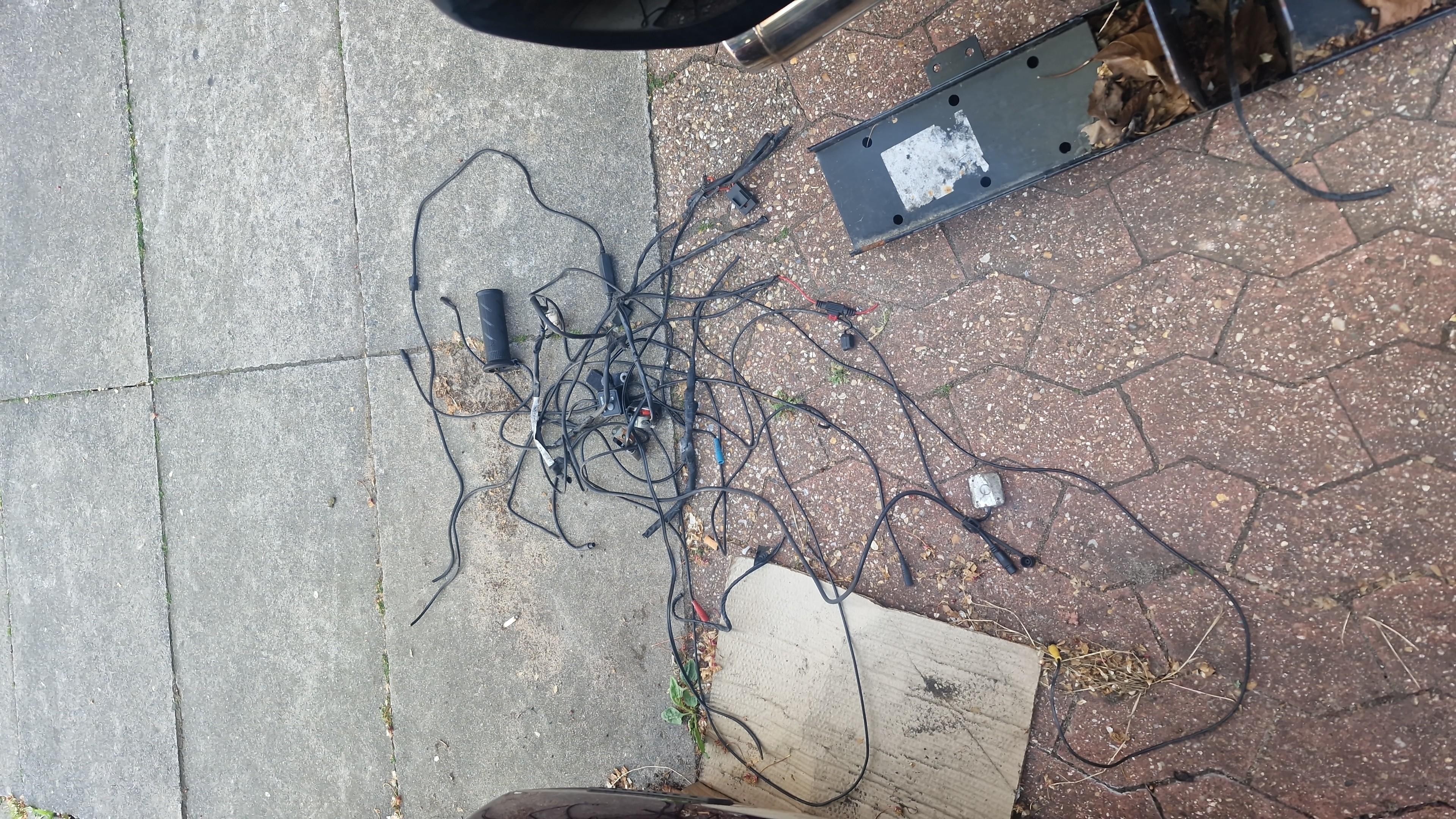

In the end, I removed all of these cables from the bike, easier to just remove them all and start again.
https://www.bikechatforums.com/files/img-20250429-wa0018.jpeg

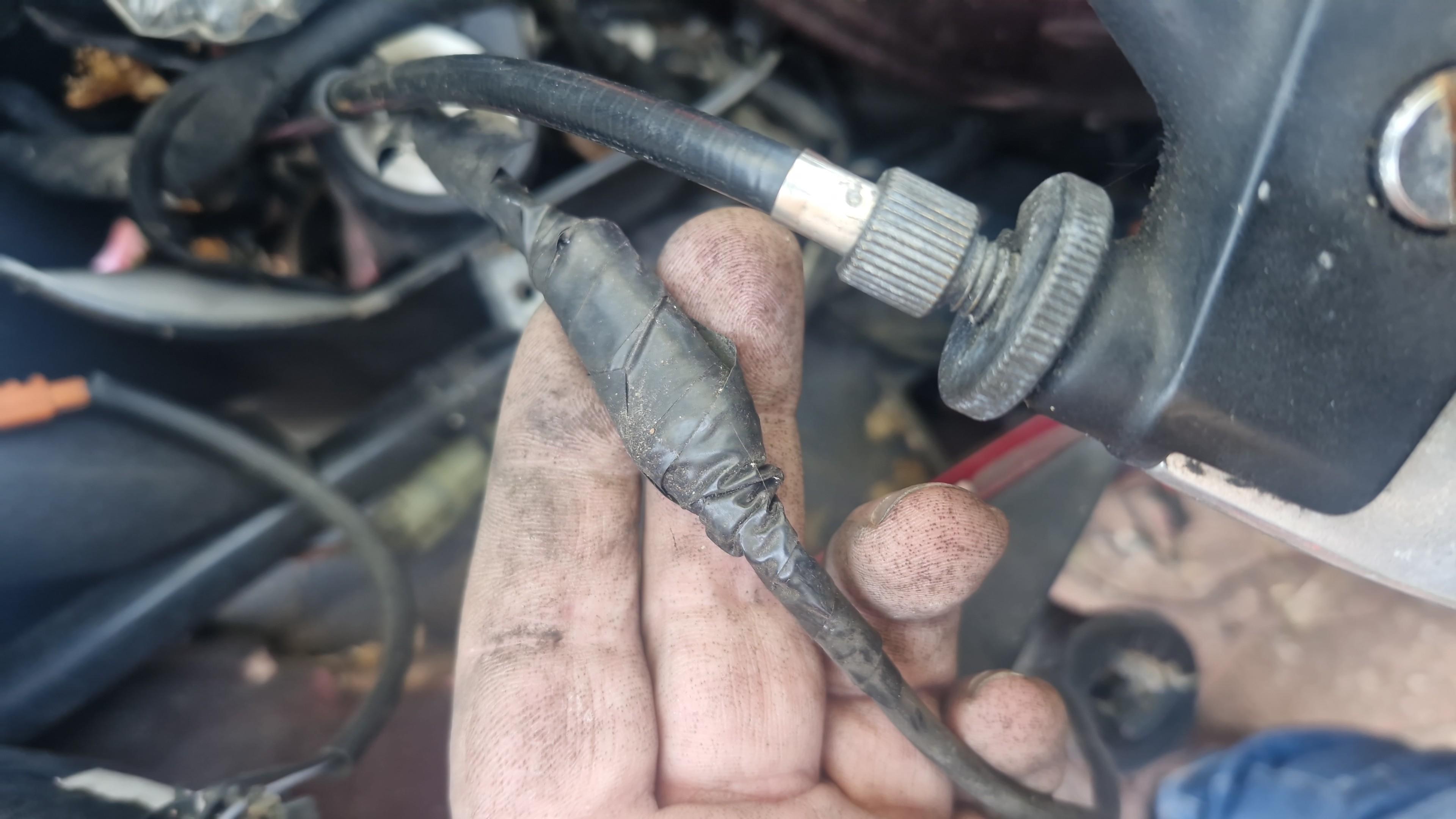

There is a take off (that isn't in the wiring diagram) at the rear of the bike for the Honda Averto Alarm, this was used for the camera system fitted to the bike. Again, instead of using a plug and just plugging in the previous mechanic hacked the loom.
https://www.bikechatforums.com/files/img-20250429-wa0005.jpeg
The belly pan kit on these comes with rubber well nuts. Instead of using them the previous mechanic knew better and used panel nuts. This is of course inside the fairing so pretty hard to get to.
https://www.bikechatforums.com/files/img-20250429-wa0020.jpeg
