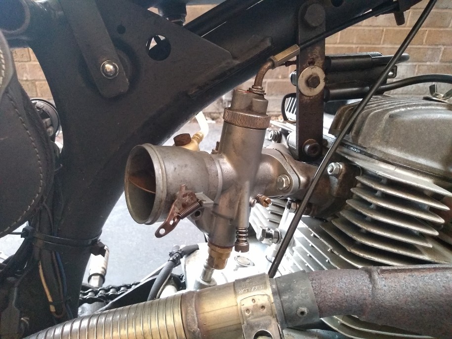

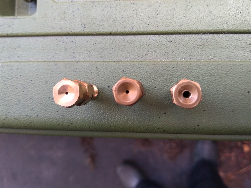

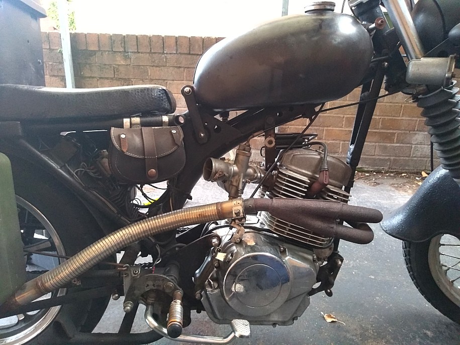

Well it seems to be working pretty well now, but I can't figure it out. Look at the pic of the jets. That's a 100 on the left, a 150 in the middle and whatever the Hell THAT is on the right, which is what works,
I also changed the idle jet to a 30.
Turns out this was a 375/33 carb before I got my hands on it. Still using the two stroke spray tube and a "B" needle which is probably standard for this carb on whatever British two stroke it came off of. But those points don't seem to matter much. It's the massive change in jet size that finally worked and I have to say it works very well (so far).
I just kept running little drill bits through one of my spare jets until it finally seemed to work well. The final drill bit measured 1.91 with my calipers. I have no bloody idea what size jet THAT would equate to.
Anybody know what that thing is I'm using for a choke? Never seen one before but it fits the carb if you hammer it on with a mallet and works a treat.

Yeah I sort of expect that from a piston port two stroke but I'm not sure it should be happening here. But have you seen the massive jet I'm using? That's not right. That can't possibly be correct jetting but it actually goes very we!!. I can't find any evidence of an air leak so I don't know what's going on.

There can only be one reason that the massive jet works (1.91 for lack of a better reference), and that must be that the airflow through the carburetor throat is so abnormal the standard jets cannot pass enough fuel to create a combustible Air Fuel (AF) ratio. I think the airflow through the carburetor is much higher than the design parameters of the venturi.
How can that be if the OE engine was a 250cc two stroke? I don't know, but I can think of a few possible explanations:
1) Usable cylinder volume. The Honda Rebel clone 4 stroke utilizes the full vertical travel of the piston on the intake stroke (or at least until the intake valve closes). As opposed to a 2 stroke engine, which loses a significant amount of effective stroke due to the location of the cylinder ports. Reduced usable cylinder volume might equate to reduced intake flow, even though the number of power strokes per second is doubled.
2) The Rebel clone draws the AF mixture directly past the intake valve into the combustion chamber. The two stroke aspires through a circuitous path past a reed valve, into the crankcase, and up to the transfer port and into the combustion chamber. The crankcase volume might act like a plenum, and reduce the velocity of the intake AF flow. I think that the direct intake of the four stroke is probably the biggest reason that you need such a large jet on the Amal carburetor.
Have you put the engine under load yet? Seem plausible that the carburetor throat is sized too small for the engine AF requirements, and that performance might suffer in the higher rpms of the power curve. It will be interesting to see how performance is affected at speed.

Ah bloody heck. I have just found THIS information about how Amal jet numbers correspond to bore size:
https://www.coventrysparesltd.com/Amaljetssizes.htm
The problem is, the jet I'm trying to find would have a bore size of roughly .075" (around 1.91mm drill bit size) which isn't on that chart so I'll have to try to figure out how to use the info there to expand the chart until I can get to a jet of my size, and even then I don't know if Amal actually even made one that big. But at least it's a start.
Anybody have a clue what number jets I should be looking for? The rocket science is making my head swim.
I need to guestimate what the one on the right is.
https://i.postimg.cc/SjF6jL6q/c.jpg
After looking at that chart and scribbling on some paper my very rough guess is that I should be looking at somewhere around a 420+ jet. Of course this all goes to pot once I fit a 106 jet tube as opposed to the 105 I currently have, but I appear to be all alone in this wilderness. No sensible person would try to fit an Amal two stroke Monobloc to a slightly modified Chonda engine.
jeffyjeff
Joined: 02 May 2020
PostPosted: 21:08 - 17 Aug 2025    Post subject: Reply with quote
lingeringstink wrote:
...Anybody have a clue what number jets I should be looking for? The rocket science is making my head swim.
Well it's not rocket science, but at least a somewhat educated guess.
Assuming that Flow in cc's/minute corresponds to jet number size.
1: Convert jet orifice diameter to square millimeters area. 2: Then divide that into the flow to arrive at a constant flow rate of approx. 170.08cc per minute per millimeter of jet diameter. That constant varies slightly over the range of jet sizes, but is relatively consistent at the higher orifice diameters. 3: Then working back, 170.08 cc times 2.865 (the area in square mm for a 1.91 orifice diameter), results in a flow rate of 487cc's per minute. Probably a 490 jet size....maybe.
https://live.staticflickr.com/65535/54727372454_bf9e4846c7_c.jpg
History shows again and again how nature points out the folly of men - BOC
lingeringstin...
Joined: 01 May 2014
PostPosted: 23:56 - 17 Aug 2025    Post subject: Reply with quote
Yeah I came up with a ballpark figure for somewhere over a number 400 jet using less specific logic and outright guesswork. I actually thought it might work out to about a 430 or so but your method is going to be closer.
However, I think I have an easy out. Tomorrow morning I'm going to go to the industrial estate where The Old Geezer with the machine shop dwells and ask him if he's got any old Amal jets knocking about that I could measure against my drill bit. He works on vintage Brit bike engines and used to race a bit back in the day so chances are he might be able to help me better pin down the size of the jet compared to my drill bit.
I just want to know what it is in case I end up needing to buy a bigger or smaller jet while I'm faffing about with this carb. Like I said before, it's ALMOST right but not perfect yet and I want to see this little experiment through. If all else fails I'll bite the bullet and order something like a 460 jet and see what happens. Jets don't cost a lot so it's no big deal if I don't get it quite right the first time.
