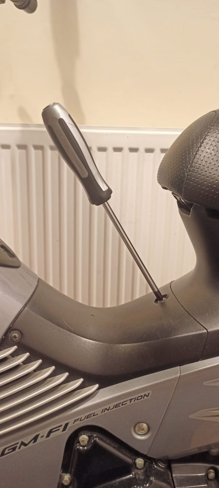

No 2 son has just moved from A2 to full power.
His bike is a Honda 650R which was new in Autumn, the dealership had fitted an A2 restrictor for him. (The dealer is more than 1 hour away).
My son has taken the tank etc and gotten to where the restrictor is.
Its in a really fiddly location and he has said no screwbit will go in to it.
On closer inspection, it looks to me like the dealer has somehow bodged it and not used a JIS bit or used too much force.
I've ordered a JIS set as we don't have any.
But I'm reluctant that they will fit, if you look at the picture.
I'm not quite sure how to attack this, the air intake next to it and tight angle also makes me weary about using a dremmel.
I know the obvious thing is to get the bike back together and get it to either the dealer who did this or someone with more knowledge than a computer programmer (moi).
Any advice appreciated.

I would tap in a screwdriver bit but if you're short on mechanical sympathy then you might break the casting it's mounted to. Why does the bracket need to come off? Can you not just remove the cables from the bracket and re-fit them later?

Yes they are JIS, the screwdriver you get in the bikes toolkit is a JIS.
Yes, they look fairly chewed but a proper JIS bit usually gets a decent hold.
I agree with Pete., you almost certainly don't need to remove that bracket. If you back off the cable adjusters, you should be able to unhook the end of the cable from it. I've never had to remove that bracket on any of my bikes when fitting/removing a push-pull throttle cable.

I think the bracket is OE and a plate has been inserted under the screws with an arm which extends to the right and limits throttle movement. Hard to see if you’re viewing by phone. I think it’s that plate which has to come out, although I doubt that’s the only restriction.
These guys use the same image for all their kits but I reckon you’ve got the equivalent of the item at top middle. I could be wrong. https://a2restrictors.com/products/honda-cbr-650r-2025-a2-restrictor-kit-cbr650-cbr650r-650-r-018?_pos=7&_sid=dad606524&_ss=r
It’s surprising how many cross-head types there are. Since they’re already mashed (perhaps deliberately since derestriction isn’t supposed to be easy) I’d start with;
Arrow trying whatever cross-heads you already have in your tool box
Arrow see if a flat-head can get any grip
Arrow if the screw heads are soft I’ve had success with pliers
Arrow use a Dremel to notch the edge of the screw and then drive that anti-clockwise with chisel taps to turn it
Arrow cut a groove across the face and try a flat-head screwdriver again
Arrow an impact driver might do it if the bracket and what it’s screwed to can take it.
Start with the intent to use minimal force and maintain as much of the existing metal as possible, then gradually ramp up.

Both of the screws in the picture are JIS. They both have a dot on the head.
JIS screwdrivers fit both JIS and Phillips. In fact, they work on Phillips better than a Phillips does because they don't torque out as easily.

PostPosted: 08:34 - 29 Dec 2025    Post subject: Reply with quote
Kawasaki Jimbo wrote:
I think the bracket is OE and a plate has been inserted under the screws with an arm which extends to the right and limits throttle movement]
Yes this is exactly it, it was also very close to the air intake and not the best place for a Dremel.
Anyway, they are out.
Attacking from a distance from outside the bike was the answer.
I now own a foot long socket 1/4" bar and JIS bits. (Isn't Amazon just ace, literally next day).
I'm really annoyed at the dealer for this. I won't name them, but they were in a right state.
Thanks all
