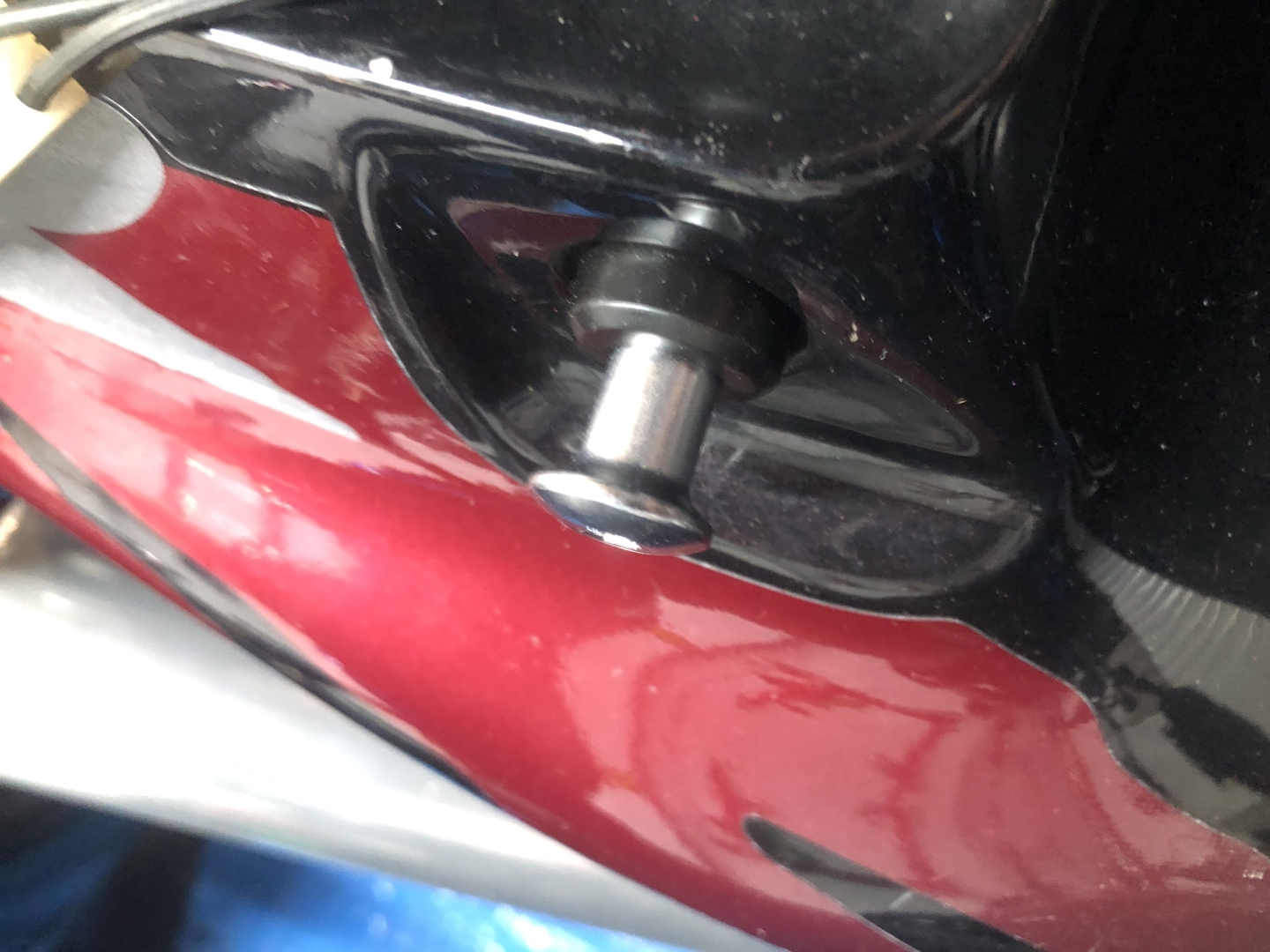

I fitted a new bolt to the right hand lower fairing, which was fairly easy.

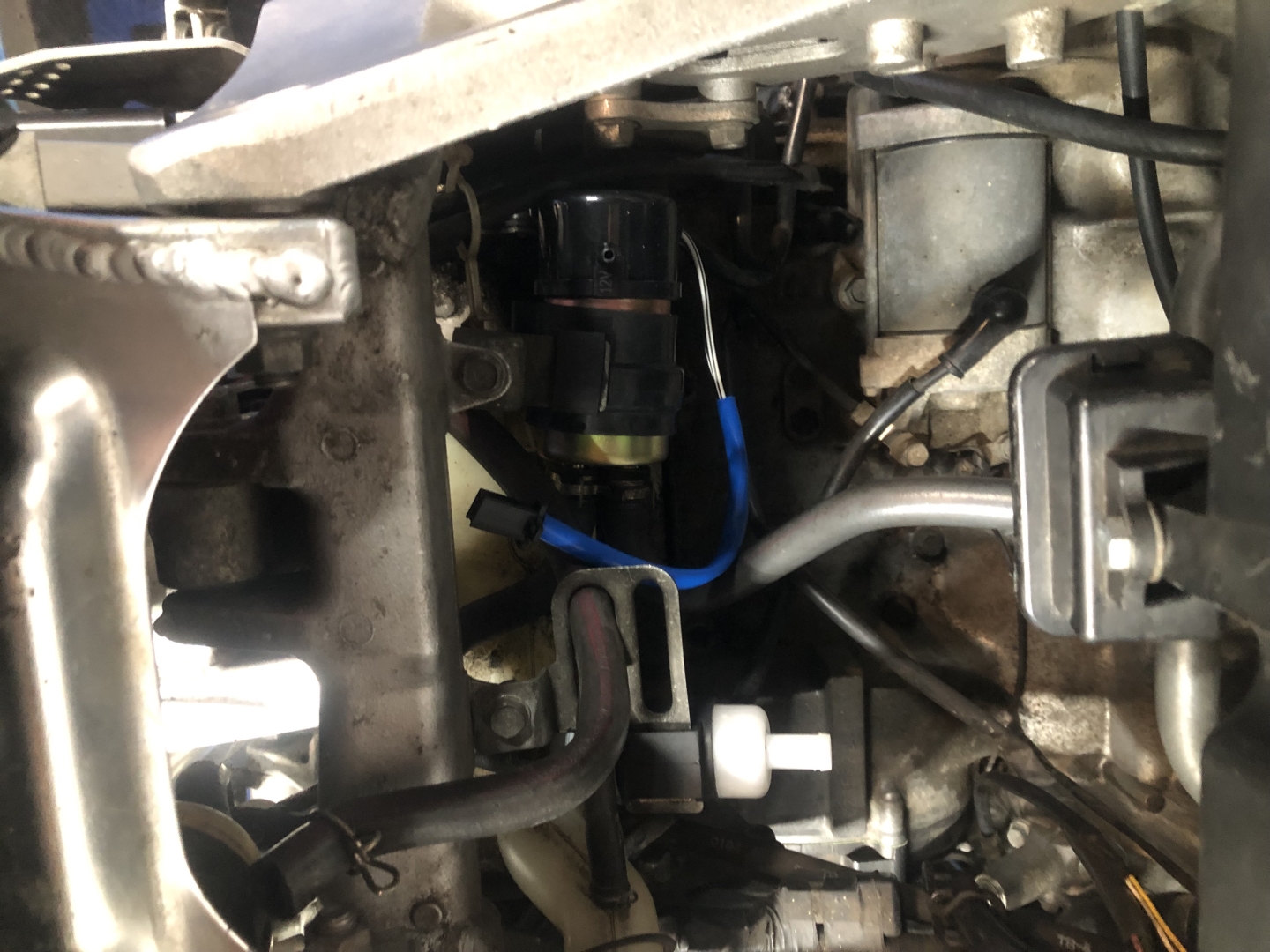

I then decided to crack on with the bit I'd been dreading, replacing the fuel pump. The previous owner had bypassed and removed it, so I had no idea how it was supposed to go together. I was also affected by my previous experience with my aforementioned CBR600RR, on which I replaced a cracked throttle tube. In order to do that, I had to remove the fairing, the tank cover, the fuel tank, the engine ECU, the steering damper ECU, the air box lid, the inlet trumpets, and the airbox base which took approximately an entire day. As former BCF Member Goose once said: "Damn the Japanese and their tiny hands!".
Turns out, my previous trauma was not relevant to this particular work. The riders seat is removed with two bolts hidden under the flexible rear corners of the seat, and then the tank is removed by two bolts, one under the seat and one behind the headstock. The whole thing took about ten minutes, the majority of which was removing the hose clips and hoses from the base of the tank.
Once off, there is a cavernous gap between the back of the rather small airbox, and the front of the subframe where the seat and tank mount. No airbox removal for this one, because the space is where the fuel pump is contained. I assume, anyway. I did find one image online of the fuel pump in place but it was not especially helpful as it did not show the hose routing or the electrical connections. Luckily the previous owner had given me a wodge of paperwork, an owners manual, a service book (including a little credit card thing with what seems to be the second owners name on it), the original fuel pump, and a replacement he had tried previously (but possibly broke trying to run the bike without the fuel switched on) and crucially both Haynes and Clymer manuals.
https://www.bikechatforums.com/files/img_0156_103.jpg

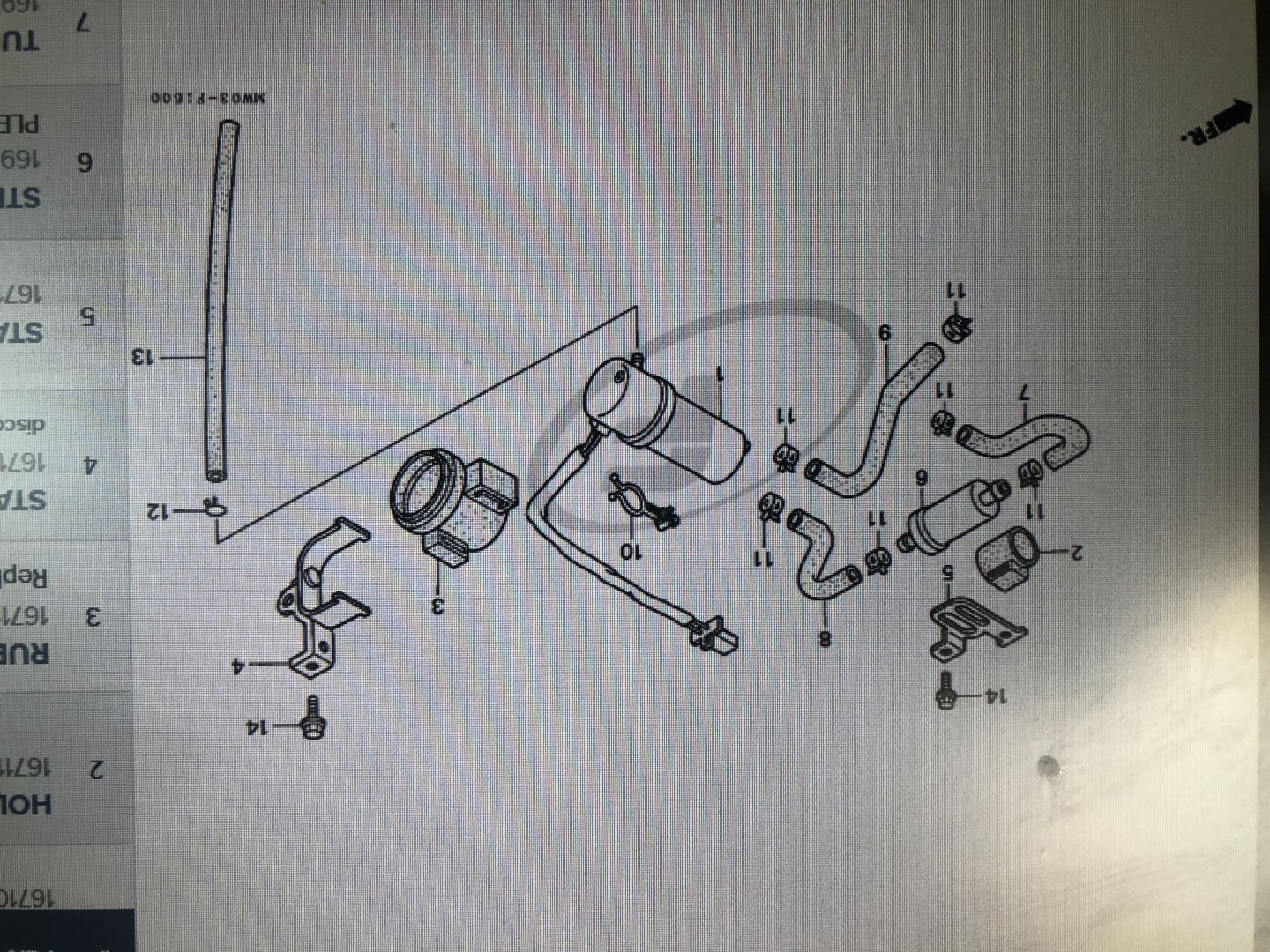

The Haynes manual has a small black and white photo of the fuel pump in place, with no hose routing, and has a line drawing of the fuel pump in place, with a dotted line that fades out showing the hoses on the pump, but no routing. Rats.
I faffed about a bit trying to work out what might go where based on the existing hose setup, and what was attached to the removed fuel pump, and then remembered the Clymer manual. I've never had one of these before, but just assumed they were an inferior American version of a Haynes. It seems that's not *quite* true, as it has twice the number of pages as the Haynes at least, and happens to contain a line drawing showing both the hose and wiring routing for the fuel pump. Phew. I had to do some 3D translations in my minds eye to work out which hoses were actually meant to go where (as they are all pre formed and will only fit one way) and with the help of the Fowlers parts fiche on their website, finally worked out how the pump should probably have been fitted, and how the fuel filter, fuel tap and carb inlet pipe should fit in relation to that.

I fitted the ebay tastic Chinesium fuel pump, re-using the mounting rubber from the previous owners attempt, and ensuring that both the top and bottom slots in the rubber were mounted over the clip. No bolts here, just a T shaped stamped metal bracket top and bottom, that the rubber slot in the mount fits over. I suppose this passes for light weight in 1995, this is not considering the massive waste of space under the tank and between the exhaust downpipes and the front of the engine...

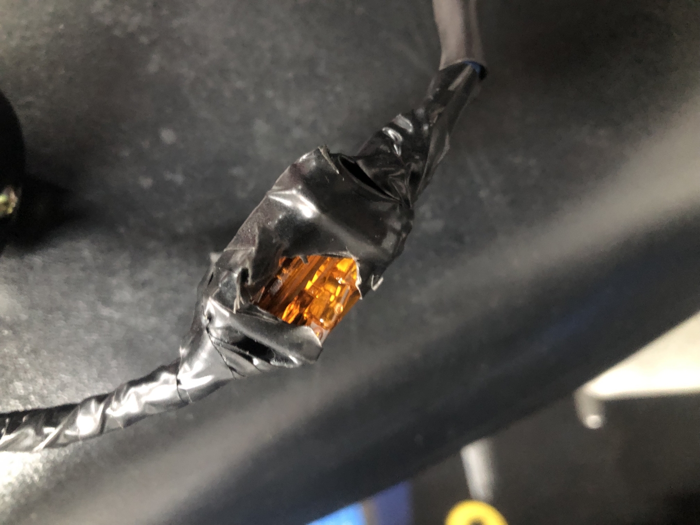

I went to connect up the fuel pump, but initially could not find where the cable goes. After more checking of the Clymer manual I found that the cable on the pump is far too short. I returned to the previously fitted fuel pump that the owner had given me, and found a strange lump about where the connector is on the new ebay special. I peeled back the electrical tape and discovered one of those awful snap electrical connectors... They had cut the cable off of the OEM fuel pump and used it to extend the cable for the replacement fuel pump...
https://www.bikechatforums.com/files/img_0150.jpg
https://www.bikechatforums.com/files/img_0149_188.jpg
So at present the tank is off, the fuel pump is fitted in the way I *think* it should be using the Haynes, Clymer and Fowlers drawings, and I've ordered a 2 pin Honda style connector so I can re use the OEM cable but build an extension so any new pump that I buy (if the Chinesium one turns out to be bad) can be quickly swapped out without any crimping or soldering.
https://www.bikechatforums.com/files/img_0148.jpg
I'm on hold until such time as this connector arrives in the post, but I did also notice that the existing fuel pump control module (it's not a relay, but it's not much more advanced than a relay apparently) has a misspelling of the OEM manufacturers name... The manufacturer being Shindengen

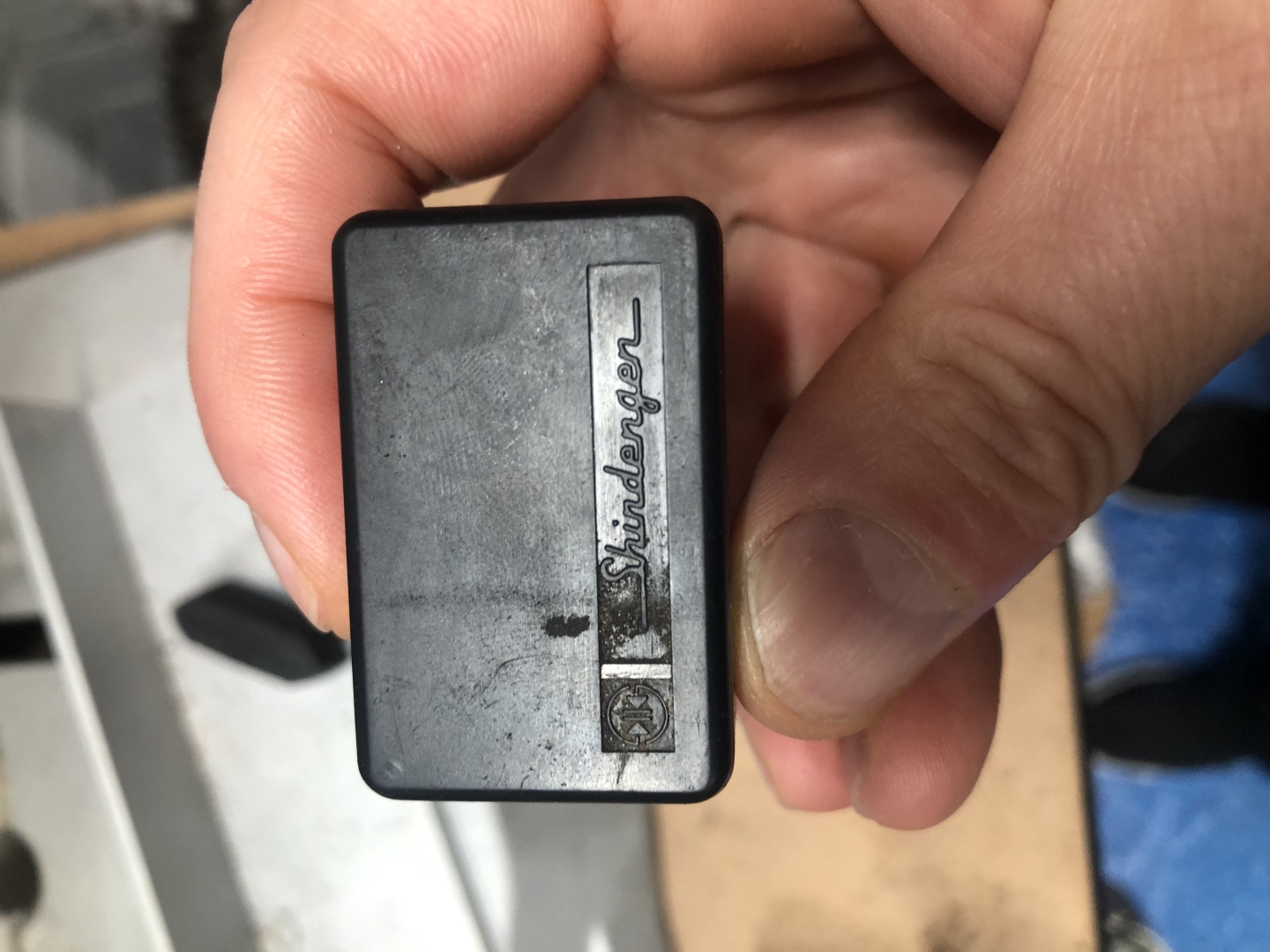

This is the OEM part (not currently fitted to the bike):
https://www.bikechatforums.com/files/img_0157_200.jpg
The currently fitted part has Shundengan written on it in the same font. Could this also be a chinesium copy perchance? I think so.

A copy of the actual honda manual would be handy for you.
Among other things, they have detailed diagrams of the routing of hoses, cables and wiring. They also give you the order of operations to get bits on and off, which are sometimes counter-intuative. The example I give being the rear shock on my VFR which first tells you to remove the seat, battery and starter relay. This is because it comes up and out through a hatch in the bottom of the battery box.
It also has very detailed specs like camchain wear measurements and which lubricants/sealants to use on what fittings and torque specs for everything.
So if I wanted to know about the hose and cable routing for the fuel system on a VFR, I'd have this diagram.
PostPosted: 16:43 - 05 Jan 2026    Post subject: Reply with quote
Yes, Good idea Stinkwheel! I have managed to obtain a copy of the Honda workshop manual. It seems the line drawings from the Clymer manual may actually be a rough reproduction of the drawings in the Honda manual... Naughty naughty Mr Clymer. It's obviously inked in a different way, but the cutoffs to all the hoses and so on are absolutely identical, and the exploded diagrams are all from the same isometric perspective with the same distance between the components...

Update: I pulled off the long cable from the previous fuel pump, and crimped on a 2 pin Honda connector to the free end. I noticed the insulation colours were different on one end than the other? So I hope that the pinout from the cable is correct. I then connected up the fuel pump.
I noticed on the previous fuel pump there was a huge sticker that said "Warning: do not mix up the polarity as it can damage the pump".
So I was a little concerned about the wiring when I re-connected the fuel tank, but after a bit of fiddling to connect up all the hoses onto the base of the tank I went for the fire up. After about 30 seconds it fired and ran! It then took an absolute age to warm up, but once it did, I turned off the choke and it idled nicely. The engine doesn't sound too rattly. There is a very subtle noise but I think that's probably the clutch.
