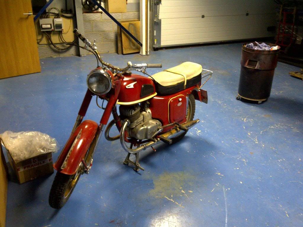

dialup_2001 wrote:
...So there I am in my mates scrapyard and an old guy pushes in this old fucking wreck of a shit soviet era!!!
https://i413.photobucket.com/albums/pp211/dialup_2001/Canterbury-20110409-00353.jpg
He takes his £31 and walks out. I fall in love and take it home!!!!
£31!! jammy git Laughing very jealous. thats the Voskhod-I, mine is the Voskhod-II, there was a MkIII as well.
