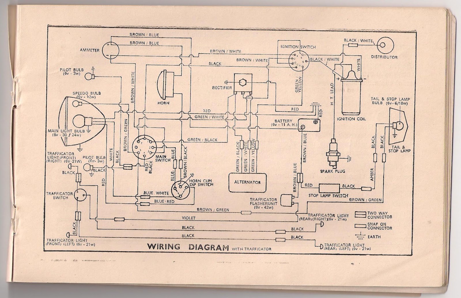

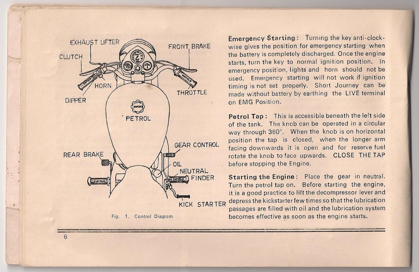

Page 6 of the Manual from '85 :-
https://3.bp.blogspot.com/-9AJGa4uvxkI/UWl_ckW2TiI/AAAAAAAAAIQ/DQsGBF7WwH4/s1600/Picture+006.jpg
https://oldraremotorcycles.blogspot.com/p/bullet-350-1985_13.html

And a mention from the G2 workshop manual :-
https://www.team-bhp.com/forum/attachments/motorbikes/2164339d1622923094t-royal-enfield-g2-bullet-story-screenshot_2021060601062965.jpg
PostPosted: 23:30 - 25 Jan 2023    Post subject: Reply with quote
...and a final breakdown of the switch contacts
PostPosted: 23:35 - 25 Jan 2023    Post subject: Reply with quote
Seemed to remember that when using the EMG position, the bike would start, but run lumpy as fuck, but was good enough to get to a point where it could be switched over and the bike kept running.
That's interesting and now makes me wonder if the bike would start if I just disconnected the battery which in theory would allow the reg/rec to directly feed the points. I only have a single phase alternator so it's a different setup to the one you've shown.
