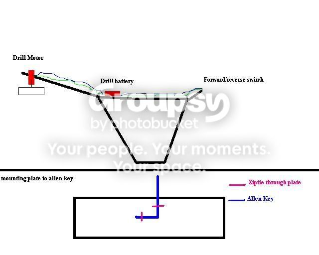

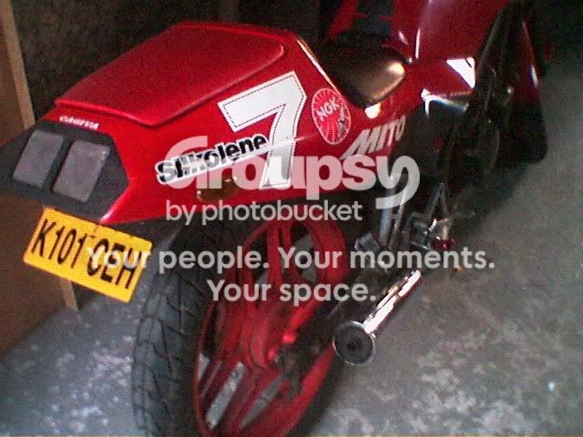

it was very easy do do, basically it's a Twist style cordless drill from BnQ
take the 2 parts of the drill apart, place the battery half somewhere suitable so it can be removed to charge the battery etc. and extend the wires so that it meets with the motor half
place the other half where suitable at the rear, mine was pointing towards the floor.
look for the left/right switch on the drill, remove it, and extend the wires so that you can mount the switch on your bars etc.
get an allen key that will fit in the socket part of the drill and amount your number plate to the L shaped allen key, then araldite it into place.
it's hard to explain it lol, in order to stop the plate from just spinning round and round I made a "stop" which involved a piece of metal a couple of inch's from where the drill poked through the undertray.
if i could find the pics etc. it would be easier to explain Thumbs Up

https://img.photobucket.com/albums/v707/lllN30lll/dayoutwithsean003.jpg
https://img.photobucket.com/albums/v707/lllN30lll/57NI0046.jpg
this is the forwards reverse switch mounted somewhere easy
https://w1.bikepics.com/pics/2006%5C02%5C06%5Cbikepics-516981-full.jpg

I hope this crap paint piccy helps
https://img.photobucket.com/albums/v707/lllN30lll/plate-1.jpg

Love the drawing, and its helpful, what bike you based that on? Looks like a CBR 600 to me! Smile
