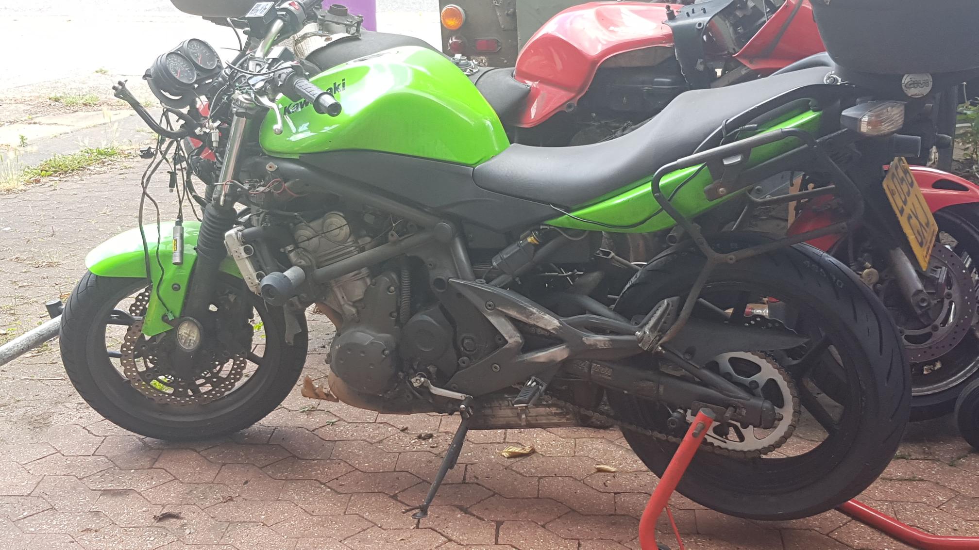

Had some time yesterday to strip the bodywork off.
One of the problems with ER6's is they vibrate a lot, its so bad that is wears out the bodywork tabs so that the body work resonates loudly. There was even a recall on the 2006-7 models for foam pads to be fitted between body panels so stop them rattling around.
As an example of how bad the vibration is on mine the two upper headlight mounts actually vibrated through and are held in place with zip ties.
https://www.bikechatforums.com/download.php?id=102527
This panel will be replaced with a new one to be ordered today along with a few other things, air filter, front sprocket washer and fork seals. One of the best things about this bike is the genuine parts are relatively cheap so this little lot only comes to £230.
I've always liked the looks of the ER6 without any bodywork, looks to me a bit like a flat tracker.

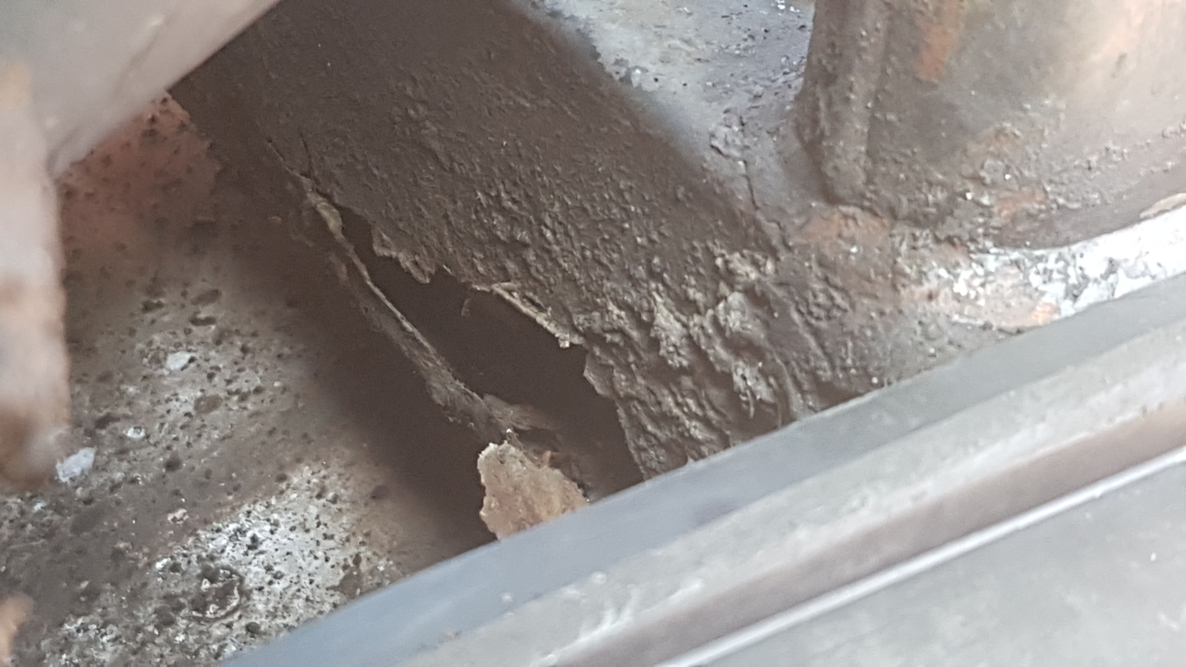

So just started working on this again. Had the rear wheel out and applied Dinitrol inside the swingarm which has a lot of corrosion in it. The swingarm fills with water on the right hand side in the rain and the drain holes in the adjusters are so small the water can't drain back out again.
The drain holes I have enlarged with an angle grinder, its not a stressed member so other than allowing water to drain won't have any adverse effect.

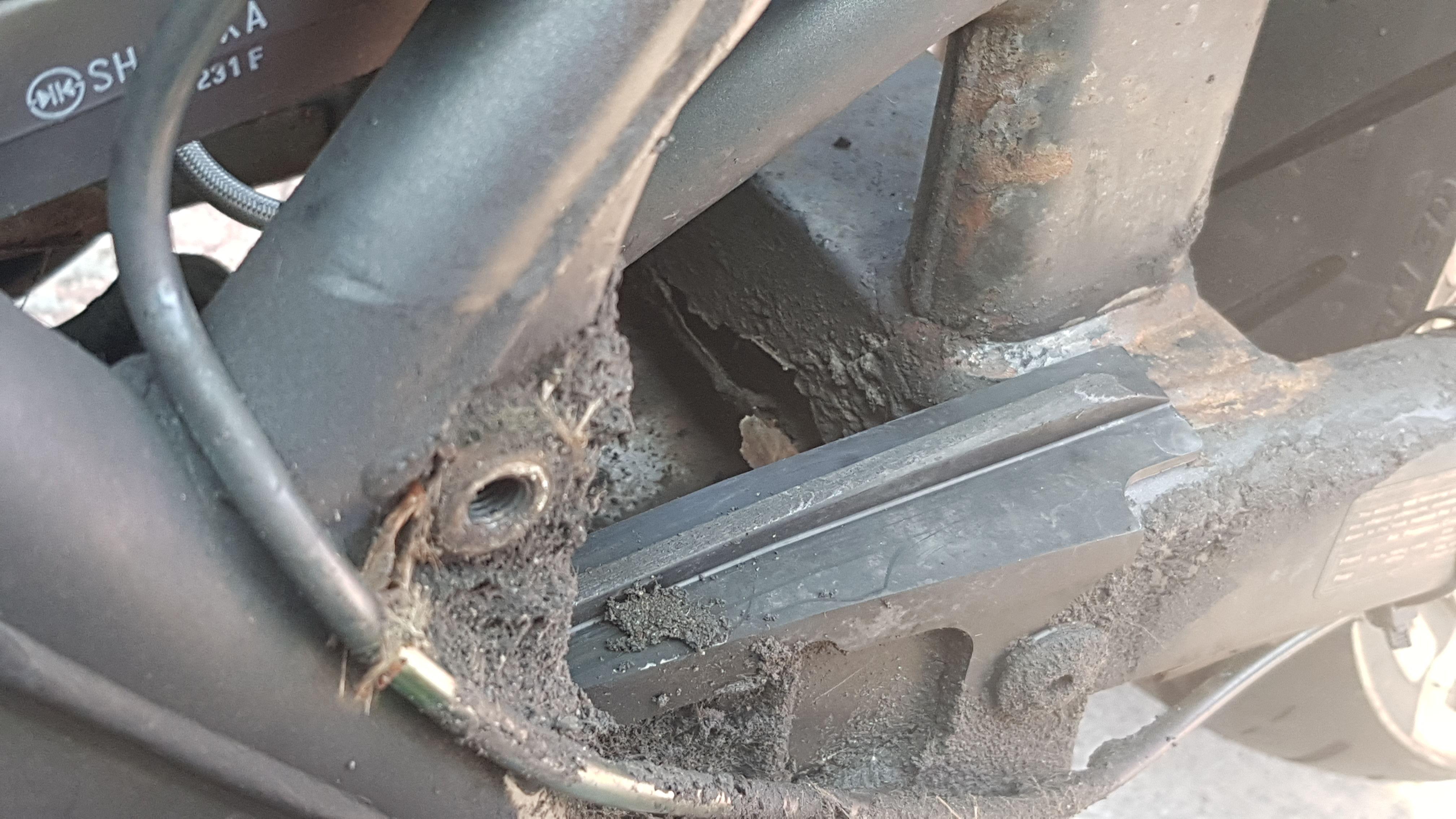

This shows the standard chain adjuster which plugs the end of the swingarm. As you can see once clamped up the drain hole is less than 0.5mm so nothing drains out.
https://www.bikechatforums.com/files/img-20200220-wa0006.jpeg
So the answer to this is to take a thin grinding disk and enlarge the cutout.
https://www.bikechatforums.com/files/img-20200220-wa0008.jpeg
You will get some water thrown up that'll enter the hole but at least it can drain out now whereas previously you adjusted the chain and got a wet hand.

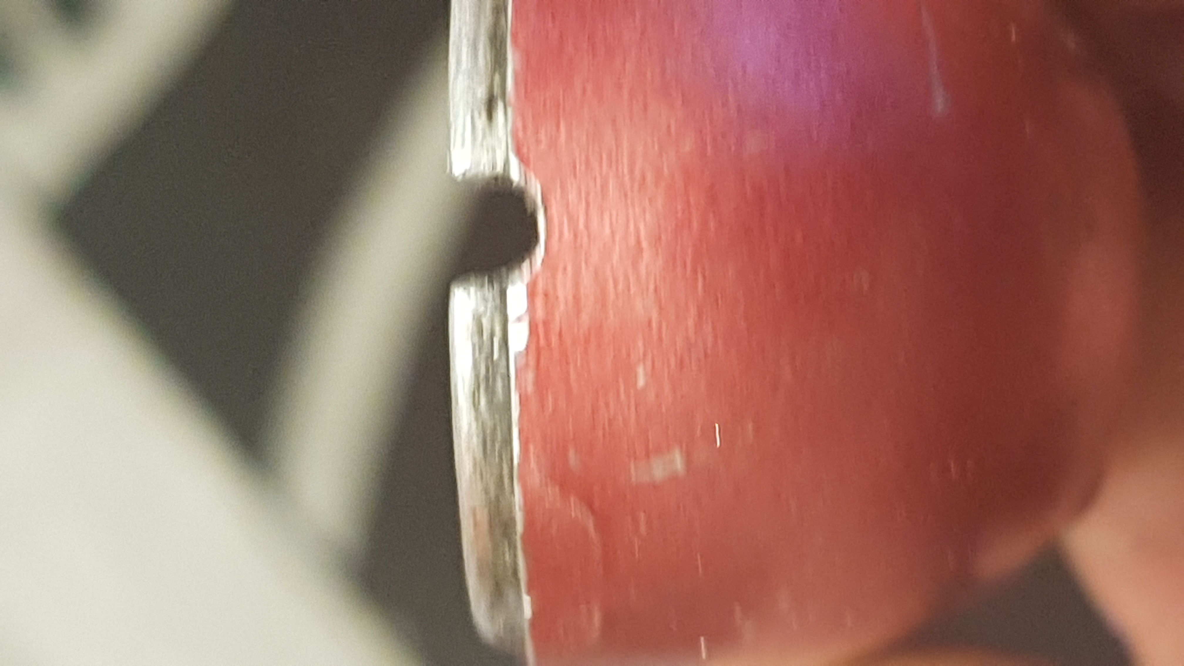

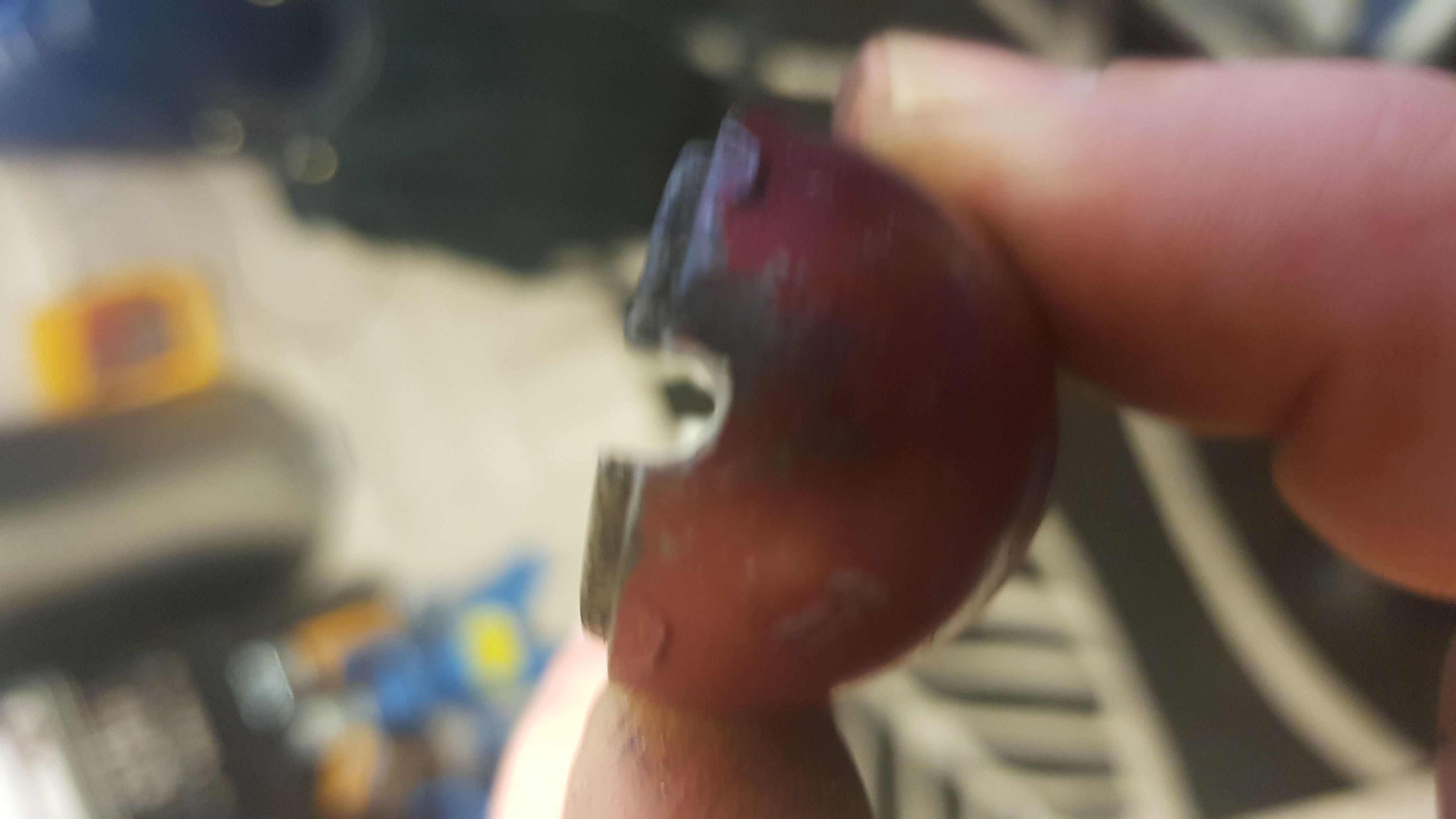

10 years floating in rusty water will even take it's toll on Aluminium adjuster blocks.
https://www.bikechatforums.com/download.php?id=103161&sid=0a86664b4df9025fd2d7df82aa486e3e
A quick clean up with an angle grinder poly paint pad and you end up with an adjuster you cn read the numbers and lines on.
https://www.bikechatforums.com/files/20200227_133950.jpg

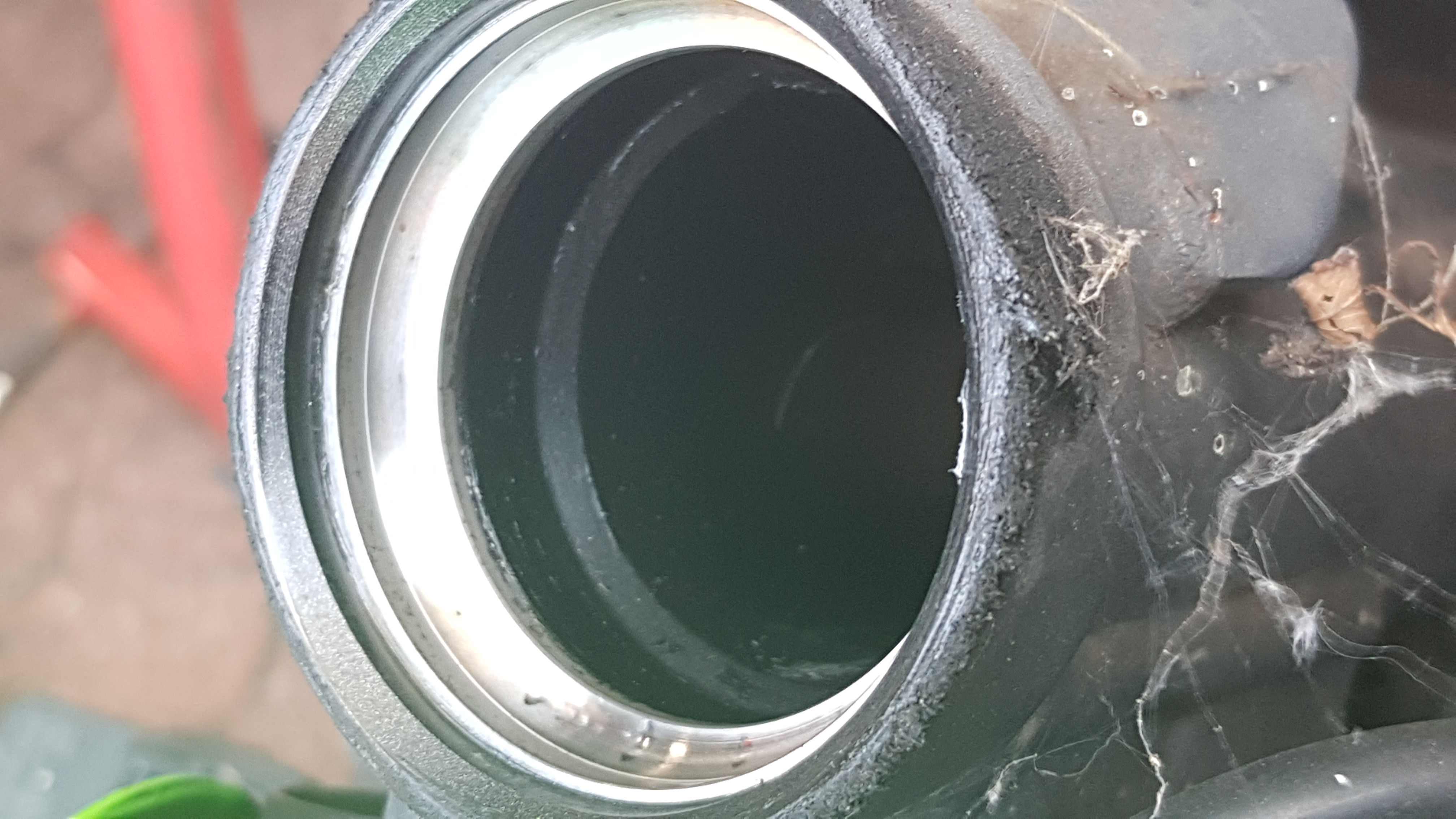

Managed to get a bit of time to work on it so front end is now off and the original ball bearing head races need to come out.
I like ball bearings, they are simple, relatively self adjusting and have low drag compared to taper roller bearings due to less surface area touching the metal races but they are more expensive than a set of tapers which only cost £30.
most modern bikes above 500cc have a problem with the head races, they are sunk into the headstock with no easy way to knock them out. These are quite possibly the worst I have seen.
https://www.bikechatforums.com/files/img-20200409-wa0011.jpeg
Some bikes have a tiny notch in the headstock so you can use a drift but even this is difficult.
Since I start welding and fabricating I tend to keep some mild steel about and I have some 10mm pipe which I sharpened to a point and it just about fitted in the notch and with the help of a mini Mjólnir hammer the races came out wrecking the drift in the process.
Most bikes have different size races with the small one at the top and a big one at the bottom. As most of the force in use goes through the bottom this makes sense but does mean the top bearing is the one that generally wears the most. On the ER6 the bearings are the same size which you can see from the diameter of the steering stem.
https://www.bikechatforums.com/download.php?id=103323
As a result the head races on this have lasted 10 years and 95000miles.
A problem I hadn't considered is my head race press only has one size of each bearing drift so there was a fair amount of messing around using the old races to press the new ones into place. Time to buy a spare set of bearing drifts.

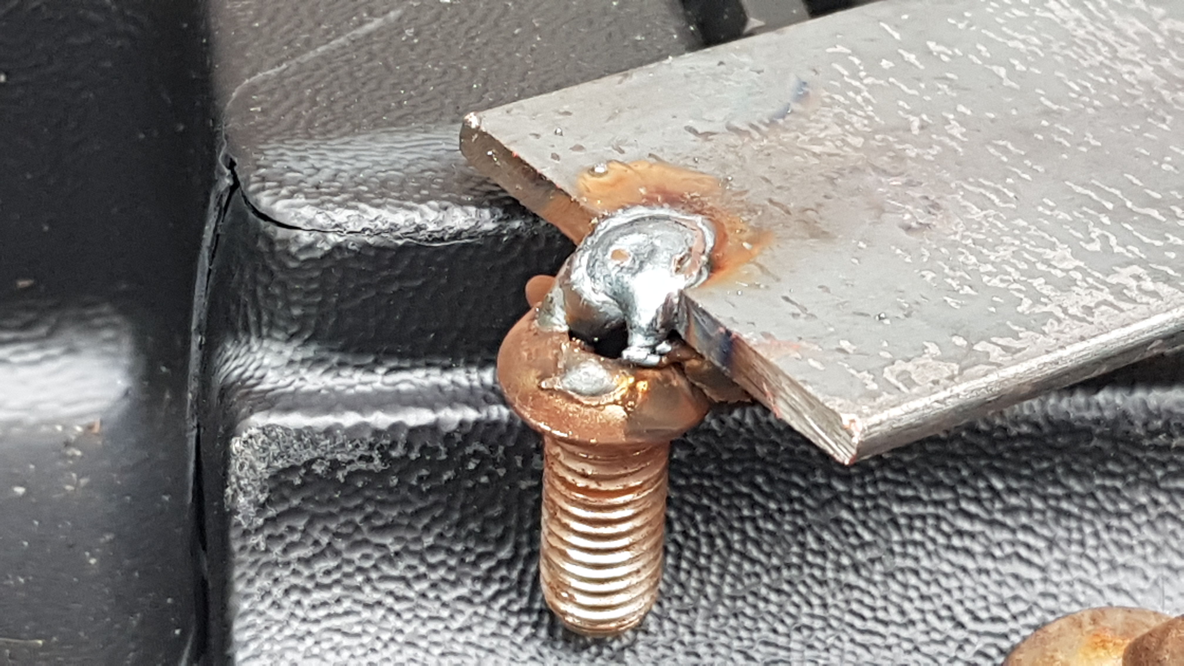

Stainless bolts can seize in mild steel. Had this one seize in the Givi rack so a piece of plate welded to it made it a lot easier to remove.
https://www.bikechatforums.com/files/img-20200412-wa0005.jpeg

PostPosted: 12:22 - 15 Apr 2020    Post subject: Reply with quote
There's still some discolouration from use and the wire brush as well as pitting on the edges but the pitting is the pad side of the fluid seal so it doesn't bother me or affect the brake performance, at least the crud is gone I could change the pistons as well as the seals but at £20 each it's a bit pricey at the moment, I might replace them at the end of next winter.

Spent the last couple of days cleaning the bike and today I removed the left hand footrest hanger which instantly showed me a serious problem. I never did get around to removing the swingarm as the pivot bolt is seized, if I had I would have found this problem before.
https://www.bikechatforums.com/files/img-20200424-wa0002.jpeg
And a close up of the hole.
https://www.bikechatforums.com/files/img-20200424-wa0000.jpeg
So now the swingarm definitely needs removal so I can decide whether to weld in a new section or to source a 2nd hand swingarm.
I'm very surprised that this has happened on an 11 year old Japanese bike, it's just not the sort of thing you expect. I'm willing to bet the bottom will be rotted as well so this could be quite a lot of metal needing replacement. On the plus side it's only a cross piece so a welded repair should be possible without compromising strength. Its a bit of an odd position for it to happen in, the rear wheel doesn't throw crap into this position and the silencer is directly underneath it so this may relate to the problem where the swingarm fills with water.
I've now beaten the pivot bolt into submission so have a bit of movement on it so hopefully it will come out. Now I need to remove and invert the foot rests so it can sit on a set of axle stands while the rear end is pulled out.
garth
Joined: 15 Dec 2004
PostPosted: 18:27 - 24 Apr 2020    Post subject: Reply with quote
Holy fuck
Be interested to see the other side that's also been shotblasted with road grit for 90k is like for comparison, assuming same gauge
Easy-X
Joined: 08 Mar 2019
PostPosted: 19:07 - 24 Apr 2020    Post subject: Reply with quote
Feck indeed! And there's me worrying about the tiny bit of corrosion I found the other day Shocked
Seem to be a goodly amount of swing arms on the FleaBay, ~£50.
PostPosted: 20:16 - 24 Apr 2020    Post subject: Reply with quote
Can i suggest you modify the next design iteration with a highly advanced feature people sometimes use on enclosed voids and water traps in oxidisable metal which are exposed to the elements called a "hole"?
From the cracks at the far side, it almost looks like it's burst. Frost damage? You get similar damage to steel farm gates where people have lost the top-cap. They fill with rainwater, then freeze.
