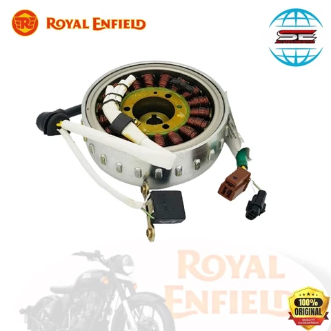

https://i.ebayimg.com/images/g/B5oAAOSweZNlgBca/s-l480.webp
I can't find any decent photos to represent this so you'll have to make do with this:
https://i.ytimg.com/vi/OBGPH9I84Vs/maxresdefault.jpg
Anyhoo, there's nowhere around the outside of the rotor to hang a little transistor-sized sensor apart from the pickup coil shell. I think there's potential for electro-magnetic interference between the two Thinking
The other thing I've noticed is all the pickup coils for TCI units are cased in grey plastic and all the EFI ones are black plastic which hints the internals may be different. It's extravagant but to be on the safe side I've ordered the older style stator assembly (hopefully with the correct mounting holes!). I shall strap the sensor to the pickup coil, set something up on my workbench to spin the rotor and see what happens.
The bonus with this approach is if the Hall Effect sensor is a bust I then have a test setup for sampling the pickup coil output instead.

Finally! The old-style coil has turned up Smile
I'm now starting to understand the system a little better. The pickup coil is what's termed a "variable reluctance sensor" - consisting of a coil, a permanent magnet and a ferro-metallic core. If this assemblage passes close by another ferro-magnetic material, i.e. the tab (or tabs for EFI) on the rotor, the magnetic field is disturbed and a voltage change induced across the coil. End result: a simple sine-wave output.
Some interesting properties to note: the pulses are obviously proportional to the speed of the rotating rotor, e.g. 6,000 rpm = 100Hz but so also is the voltage. Hand cranking may generate a few volts at best, kickstarting or a starter motor would manage 3 or 4 volts (which I've seen already) but as you approach the redline there might be over 120V AC Shocked (albeit with a very small current)
Plan A was to install a parallel system to detect RPMs with a Hall Effect sensor. I can see some practical issues:
1) Strapping the sensor to what we now know is a permanent magnetic.
2) The neodymium magnet I attached to the rotor might disturb the output of the reluctance coil.
3) Modern construction of the coil/pickup assembly now features a fully moulded grommet, i.e. there's no gap to slip a few extra wires through (the current grommet on my GT could feature as a secondary engine breather!)
Oh dear. How about Plan B? Tie into the pickup coil output:
1) Any digital circuitry will be expecting 3.3V (5V at a push) so electrical isolation/limiting is a necessity.
2) Care must be taken not to affect the output to the extent the TCI box fails to fire.
3) On the plus side nothing needs to go inside the engine case.
Some good news for Plan B, according to wikipedia there are off-the-shelf chips designed specifically as variable reluctance digital converters: MAX9924, LM1815 and NVC1124. I might get hold of one or alternatively study how they limit the voltage and drive my Pico directly Thinking
Firing up my prototype Pico RPM counter unfortunately does show the magnet in pickup coil can affect the Hall Effect sensor. Maybe a unipolar sensor could be used with the neodymium pole set opposite to the one in the pickup but it's a lot off faffing about. Nope, not the way Sad Plan B then! I'll fit the single tab rotor, swap over the stator/pickup and, assuming it fires up okay, worry about the tacho later.
I suspect the "grey pickup" has a different number of windings to the "black pickup" on EFI engines given the former is expecting one big tab and the latter 24 small ones. Differing coil resistances would tend to confirm this, if I remember to check them Smile
