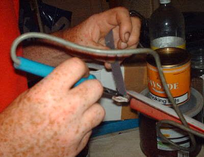

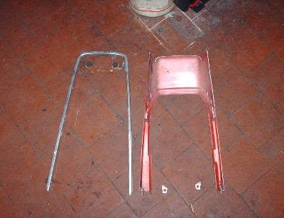

Fixing broken plastics
https://i1177.photobucket.com/albums/x349/snowtigeress/fixing%20stuff/imag1310.jpg
Here we have the tail cowling from the pup, and the 'noggins' that it bolts to the support rail have broken off. They ALL do that! The 'lugs' on the back of side-panels are another one that ALWAYS breaks, and Tef's going to show me how to re-make one of them later.

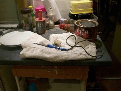

What you need:
https://i1177.photobucket.com/albums/x349/snowtigeress/plastics%20and%20tank/Bike320.jpg
https://i1177.photobucket.com/albums/x349/snowtigeress/plastics%20and%20tank/Bike321.jpg
1> Plastic Part to be fixed
2> Soldering Iron
(One with an interchangeable tip you don’t mind getting messy, or an old or cheap one that can be kept especially for the job)
3> 'Scrap' Plastic, of a similar texture to the bit you want to fix, cut from any old plastic 'rubbish' you have lying about, to use as 'filler' rod.
The first thing to do is to find the right 'Scrap' plastic to use as your filler. you can buy special plastic welding kits, that contain plastic rods of different plastic, but they are expensive, and you are BOUND to have loads of suitable plastic 'rubbish' you can use instead!
In true 'Blue-Peter' fusion, raid the kitchen cupboards, the recycling bin, kids bedroom, garage shelves WHEREVER... for ANYTHING 'disposable' or that you can dispose of, made of plastic.
You need to try and 'match' the plastic of the filler rod to that of the thing you are fixing, and for motorbike body-panels the plastic is normally some kind of nylon.
Best match for that kind of plastic I have found has tended to be from things like washing up bowls, stak-a-boxes or old milk-bottles. Plastic tends not to be quite as high grade or as brittle as that used in the motorbike panels, but it doesn't have to be an 'exact' match.

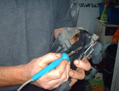

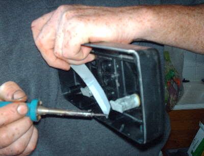

If you have NEVER done this before, or aren't very confident, it’s a good idea to start on something that’s not critical or cosmetic. I practiced on an old bucket!
the PRINCIPLE is that you place the two parts to be joined together, then you sort of 'stitch' the plastic together across the joint by stabbing the soldering iron into the plastic, the blade at 90 degrees to the crack or join, in little 'stitches' to give a sort of 'zip' effect.
This puts plastic across the join, and makes the two halves stick together. so the NEXT bit is to add new plastic to fill the holes, and then mix that in, and smear it about a bit, over a wider area, to get the new and old plastic properly joined, and get a good continuous piece of plastic without any cracks or scars where it will crack again!
https://i1177.photobucket.com/albums/x349/snowtigeress/fixing%20stuff/imag1311.jpg
https://i1177.photobucket.com/albums/x349/snowtigeress/fixing%20stuff/imag1312.jpg

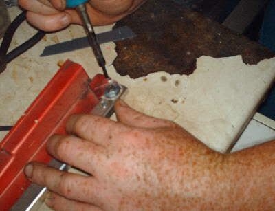

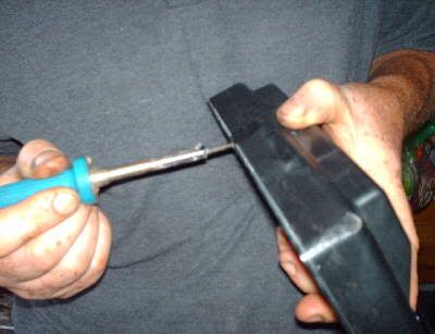

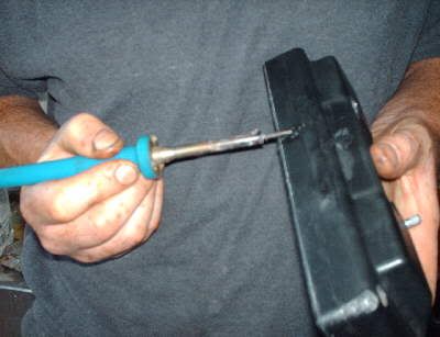

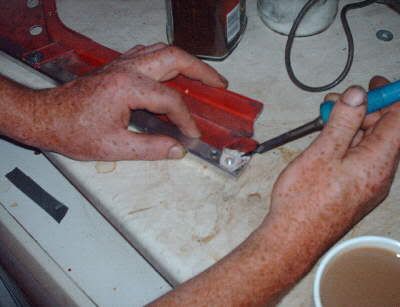

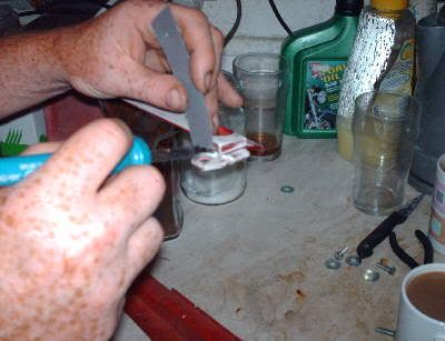

So once you have your tools and materials sorted, you can start work. And the first thing is to look at what you are fixing and decide how to tackle it.
There are a lot of repairs you can make with plastic welding, and on a motorbike panel, you can weld up a crack, or re-join a part that has broken off. You can also fill holes and build up plastic by 'modelling' depending on how crafty you get.
For now, we want to put these noggins back on and build them up so they don’t break off again, and to get them aligned properly, tef has bolted the cowl and the broken noggins, back on the support rail to hold them in place.
Then JUST for now, 'stitched' across the joint to get the bits to stick together. He's done this BOTH sides, to make sure that the join and the filler plastic do go right the way through the part.
https://i1177.photobucket.com/albums/x349/snowtigeress/fixing%20stuff/imag1313.jpg
https://i1177.photobucket.com/albums/x349/snowtigeress/fixing%20stuff/imag1314.jpg
https://i1177.photobucket.com/albums/x349/snowtigeress/fixing%20stuff/imag1316.jpg

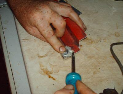

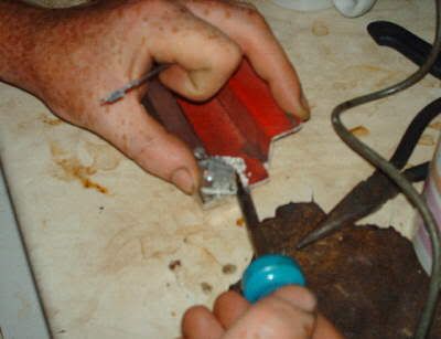

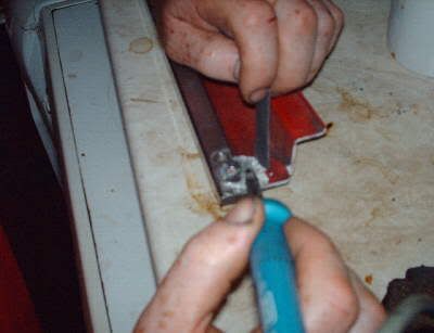

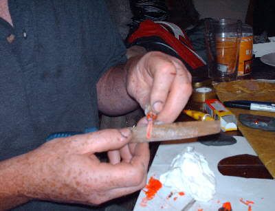

Once the noggins are attached, the frame rail can be removed so that the whole joint area can be worked. Tef stitched the areas of the join that were under the frame rail and washer, THEN used the soldering iron to 'valley' the join and put a groove in to take the filler plastic.
In this case the plastic was cut from a stak-a-box that had cracked, and Tef melts it roughly into the groove.
https://i1177.photobucket.com/albums/x349/snowtigeress/fixing%20stuff/imag1320.jpg
https://i1177.photobucket.com/albums/x349/snowtigeress/fixing%20stuff/imag1322.jpg

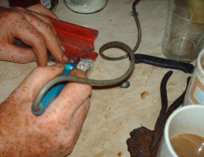

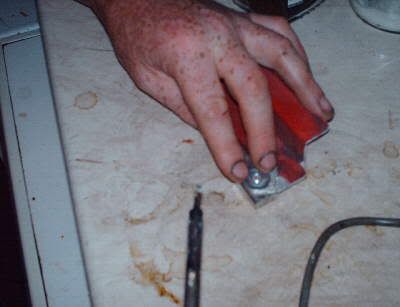

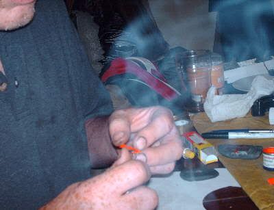

Once the filler rod, has been melted into the groove, it then has to be melted into the plastic around the groove to mix the different plastics and get a continiouse 'flow' accross the joint.
https://i1177.photobucket.com/albums/x349/snowtigeress/fixing%20stuff/imag1325.jpg
https://i1177.photobucket.com/albums/x349/snowtigeress/fixing%20stuff/imag1326.jpg
Again, this has to be done on BOTH sides of the crack.

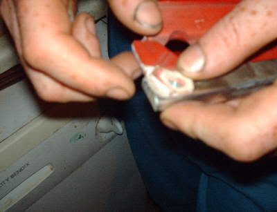

With the front roughly 'done' Tef put the support rail back on to keep the soft noggin aligned while building up the joint on the back.
https://i1177.photobucket.com/albums/x349/snowtigeress/fixing%20stuff/imag1327.jpg
https://i1177.photobucket.com/albums/x349/snowtigeress/fixing%20stuff/imag1328.jpg
https://i1177.photobucket.com/albums/x349/snowtigeress/fixing%20stuff/imag1329.jpg

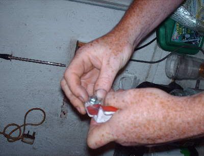

Because this is niggin is bolted through, and obviously isn't all that strong, we wanted to strengthen the area around the joint.
Tef put a large washer over the bolt-hole to help spread loads and strengthen the joint.
https://i1177.photobucket.com/albums/x349/snowtigeress/fixing%20stuff/imag1330.jpg
https://i1177.photobucket.com/albums/x349/snowtigeress/fixing%20stuff/imag1331.jpg
And then built the area around it up with filler plastic, basically burying the washer in the part!

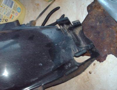

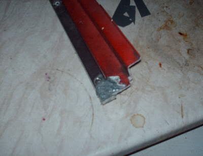

The rear mudguards also have a habit of cracking around the clips where they attach to the frame rails at the bottom, and the bolt holes at the top.
https://i1177.photobucket.com/albums/x349/snowtigeress/fixing%20stuff/imag1278.jpg
https://i1177.photobucket.com/albums/x349/snowtigeress/fixing%20stuff/imag1279.jpg
https://i1177.photobucket.com/albums/x349/snowtigeress/fixing%20stuff/imag1281.jpg
These are not so obvious, so if the repair can be made nice and smooth, then they shouldn't need any finishing sanding or paint..... Thank heavens!

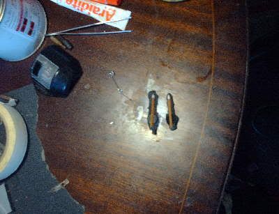

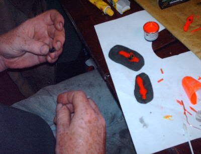

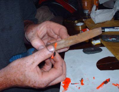

The needles get the sun all year round so they get brittle, so this is our attempt in fixing them
https://i1177.photobucket.com/albums/x349/snowtigeress/fixing%20stuff/imag1171.jpg
https://i1177.photobucket.com/albums/x349/snowtigeress/fixing%20stuff/imag1172.jpg

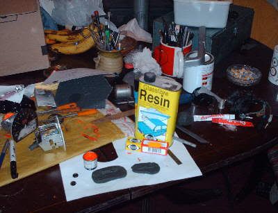

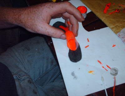

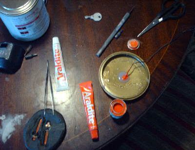

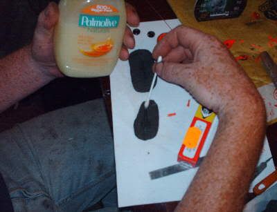

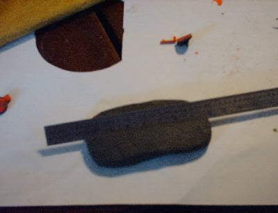

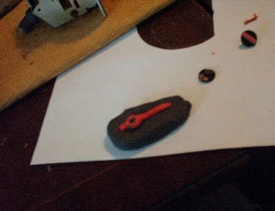

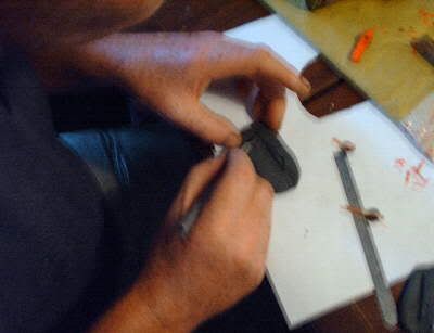

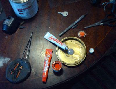

Mould some plasticine big enough to put the needles in, press them down firmly and build the plasticine up around them
https://i1177.photobucket.com/albums/x349/snowtigeress/fixing%20stuff/imag1173.jpg

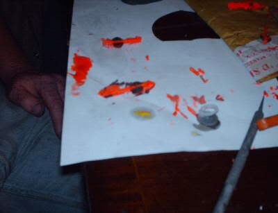

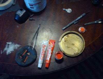

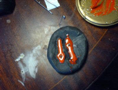

As this picture shows, that’s the araldite resin and hardener and some orange paint, we used to mend the needles
https://i1177.photobucket.com/albums/x349/snowtigeress/fixing%20stuff/imag1174.jpg
https://i1177.photobucket.com/albums/x349/snowtigeress/fixing%20stuff/imag1175.jpg
https://i1177.photobucket.com/albums/x349/snowtigeress/fixing%20stuff/imag1178.jpg

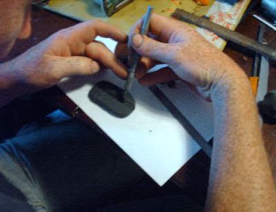

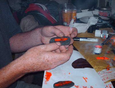

By mixing a small amount of each item we are ready to put it over the broken needles

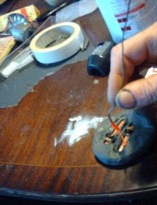

https://i1177.photobucket.com/albums/x349/snowtigeress/fixing%20stuff/imag1179.jpg
By using something pointy smoothing it across the old needles so that it’s all over them
https://i1177.photobucket.com/albums/x349/snowtigeress/fixing%20stuff/imag1185.jpg
Then wait for them to become hard

Then with a craft knife cut them into shape
making needles
https://i1177.photobucket.com/albums/x349/snowtigeress/fixing%20stuff/imag1249.jpg
These are the items you need to make needles fibreglass resin and harder paint and plasticine and the noggins off the old needles and a ruler and craft knife
https://i1177.photobucket.com/albums/x349/snowtigeress/fixing%20stuff/imag1238.jpg
https://i1177.photobucket.com/albums/x349/snowtigeress/fixing%20stuff/imag1239.jpg
Use the old needles before you take them off the noggins to make the moulds into the plasticine
https://i1177.photobucket.com/albums/x349/snowtigeress/fixing%20stuff/imag1241.jpg
https://i1177.photobucket.com/albums/x349/snowtigeress/fixing%20stuff/imag1237.jpg
https://i1177.photobucket.com/albums/x349/snowtigeress/fixing%20stuff/imag1245.jpg
https://i1177.photobucket.com/albums/x349/snowtigeress/fixing%20stuff/imag1247.jpg
Then by using the ruler you can make the mould deeper and then use the craft knife to build up the sides
https://i1177.photobucket.com/albums/x349/snowtigeress/fixing%20stuff/imag1251.jpg
https://i1177.photobucket.com/albums/x349/snowtigeress/fixing%20stuff/imag1250.jpg
Use a small amount of hand soap into the moulds so it be easy to take out the new needles once hard
https://i1177.photobucket.com/albums/x349/snowtigeress/fixing%20stuff/imag1257.jpg
Now mix up a small amount of resin, hardener, and paint into a small pot preferably not plastic as we found out it melted though!
https://i1177.photobucket.com/albums/x349/snowtigeress/fixing%20stuff/imag1259.jpg
Pour the mixture into the moulds
https://i1177.photobucket.com/albums/x349/snowtigeress/fixing%20stuff/imag1261.jpg
Then add the noggins and press them into the mixture
https://i1177.photobucket.com/albums/x349/snowtigeress/fixing%20stuff/imag1291.jpg
https://i1177.photobucket.com/albums/x349/snowtigeress/fixing%20stuff/imag1296.jpg
Once they have set you can peel away the plasticine
https://i1177.photobucket.com/albums/x349/snowtigeress/fixing%20stuff/imag1297.jpg
https://i1177.photobucket.com/albums/x349/snowtigeress/fixing%20stuff/imag1301.jpg
Cut away the excess
https://i1177.photobucket.com/albums/x349/snowtigeress/fixing%20stuff/imag1302.jpg
https://i1177.photobucket.com/albums/x349/snowtigeress/fixing%20stuff/imag1304.jpg
Then file them into shape
https://i1177.photobucket.com/albums/x349/snowtigeress/fixing%20stuff/imag1306.jpg
piccy of both the mended needles and the 1s we made, Mended needles can be painted, but the resin seeped through in the pin on the ones we made,so cant be screwed into the clocks
p.s on trying to get the resin out on the pin i snapped the needle....So round 1 needles win...................

Other niggly stuff that's been tackled has been the petrol tank and side-panels. Tef has been doing a bit of wizardry with old staka-box plastic and a soldering iron, re-making the lugs to hold on the side panels and tail cowling, but the first thing was to 'panel-beat' the side panels into shape, as they were a bit warped for some reason.
https://s1177.photobucket.com/albums/x349/snowtigeress/fixing%20stuff/imag1353.jpg
Tef did this with a couple of hammers and an electric blow-lamp! Clever, hugh!
https://s1177.photobucket.com/albums/x349/snowtigeress/fixing%20stuff/imag1560.jpg
Tef, getting cleverer with the soldering iron and bits of old scrap plastic snapped out of yet another broken stak-a-box!
https://s1177.photobucket.com/albums/x349/snowtigeress/fixing%20stuff/imag1561.jpg
First he welded two strips together to make a T section
https://s1177.photobucket.com/albums/x349/snowtigeress/fixing%20stuff//imag1565.jpg
Then added another to make an X section
https://s1177.photobucket.com/albums/x349/snowtigeress/fixing%20stuff/imag1566.jpg
Then he melted down the edges, using the molten plastic to fill the corners of the X and make the whole section the same width.
https://s1177.photobucket.com/albums/x349/snowtigeress/fixing%20stuff/imag1567.jpg
THEN he melted down all the 'spare' platic off the end, filling in the corners of the X for about 1/2" to make the 'head' (Phnar-Pnar! You'll see what I mean in a tic! I think its unfortunate that the stak-a-box he nicked the plastic from was red.... just sort of emphasises the phallic similarity!)
https://s1177.photobucket.com/albums/x349/snowtigeress/fixing%20stuff/imag1568.jpg
About 1" from the end, he melted a notch in the X section, and welded in another strip of plastic, to make the base of the lug where it would push through the rubber..(Oh gawd! The innuendo!)
https://s1177.photobucket.com/albums/x349/snowtigeress/fixing%20stuff/imag1569.jpg
He did that on all four sides, melting the spare plastic into the section to form a solid base, and then using more plastic melted into the bit above, shaped the 'head' (NOW do you see what I was laughing at!) And welded, using the spare plastic at the bottom to get (Tef's words not mine !) 'good penetration' (sheesh! I feel like I'm writing the captions for a porno mag, not a motorbike restoration! Must be my dirty mind!) {Err. Tef just said, DEFINITELY my dirty mind! LoL}
https://s1177.photobucket.com/albums/x349/snowtigeress/fixing%20stuff/imag1542.jpg

HOW To: 'Repair Aluminium with 'Loaded' Epoxy
A useful little repair process this one that can be applied in all manner of ways to solve different problems. Basically, this was what we did before they offered proprietary glues and compounds like 'Liquid-Metal', and you can use it pretty much as you would those kind of metal glues. Its tough, sets like metal, & can be filed, drilled or tapped like aluminium. It can withstand heat almost as well as aluminium, and most solvents; even hot oil.
Making the epoxy/aluminium composite yourself, you have a lot more control over the consistency of the mix, making it more versatile still, while using regular 'Araldite', its a LOT cheaper than proprietary equivalents, and saved having hundreds of different tubes of glue, knocking around, leaking, going hard in the tubes, before you use them up!
So, to business! In this example, we used the loaded epoxy repair technique to rebuild a cracked mounting boss on the starter motor for Donna's 'Pup'. How it got broken in the first place is any-ones guess; probably over tightening the mounting bolt, or trying to remove the starter with a lump hammer or something! Doesn't matte, problem is that the boss around the bolt hole has cracked off and we need to build it back up again so that the bolt has something to press against and not bend, only pressing on one side.
https://s1177.photobucket.com/albums/x349/snowtigeress/fixing%20stuff/imag1606.jpg
Before ^. After V
https://s1177.photobucket.com/albums/x349/snowtigeress/fixing%20stuff/imag1619.jpg
Before & After pics, so you can see what we are at. Basically, gloop some 'stuff' around the broken chunk of metal, let it set, file and drill to shape!
WHAT YOU WILL NEED:- Epoxy Adhesive (Resin + Hardener); Aluminium Filings (To 'load' the epoxy)
https://s1177.photobucket.com/albums/x349/snowtigeress/fixing%20stuff/imag1603.jpg
First job is to make some fine aluminium filings! The higher the % of filings to glue, the more 'solid' and less plastic the material will be when set. Simple operation, grab a chunk of scrap aluminium, a file, and an old tea-tray, and file away as much metal as you need!
https://s1177.photobucket.com/albums/x349/snowtigeress/fixing%20stuff/imag1605.jpg
I had conveniently to hand a bit of extruded Ali support rail that had been hacked up off 'the heap' and made my filings from that. Old engine cases, bits of old green-house, pretty much anything you have to hand that would go in the recycling box, can be used. But once you have filed down a volume about equal to the volume you need to build up, you need to gather it up and put it in a suitable receptacle, like an aerosol lit, to mix with the glue.
https://s1177.photobucket.com/albums/x349/snowtigeress/fixing%20stuff/imag1607.jpg
But first you need to prepare the artefact you are going to 'gloop'. The area that's to be glooped needs to be properly cleaned so that the glue will stick to it. If its not bare metal, it may need wire-brushing or grinding back to get a
good surface to work on, that the glue can 'key' to. Then, you may need to mask around the area to be glooped, first to stop the glue going places you dont want it, but also to contain the glue in the region you want to build up. It will be runny, and it takes a while to cure, and in that time, it can often run, leaving you with little or no material where you want it!
https://s1177.photobucket.com/albums/x349/snowtigeress/fixing%20stuff/imag1608.jpg
Then you can mix the gloop. As a rough guide, about 50/50 glue to filings. Its often best to put the glue in one tub, then add the filings to suit, rather than the other way around. Mix until you have a thick, even consistency, the resin
and hardener thoroughly mixed, and the filings well wetted in the liquid.
https://s1177.photobucket.com/albums/x349/snowtigeress/fixing%20stuff/imag1610.jpg
Then using lollipop stick or other suitable application tool, gloop the mix over the area to be built up!
https://s1177.photobucket.com/albums/x349/snowtigeress/fixing%20stuff/imag1617.jpg
Allow to cure. Instructions for the epoxy should give a rough time for how long this should take, and loading the mix with filings shouldn't REALLY alter that, but its worth giving about 50% extra time to be sure its properly hardened.
After allowing to cure, check you have enough build. Sometimes during cure the gloop flows, or settles, or finds crevices to flow into, leaving your area short of material. No great problem, you can give it a second application if needs be, either before working, or after. In fact, some-times its easier to build up in stages, shaping between each build.
https://s1177.photobucket.com/albums/x349/snowtigeress/fixing%20stuff/imag1615.jpg
Once you have sufficient build, and the gloop has fully cured, it can be worked with conventional hand tools, to dress off any excess, and shape to your own satisfaction!
https://s1177.photobucket.com/albums/x349/snowtigeress/fixing%20stuff/imag1614.jpg
NOT the appropriate way to use an electric drill! Photo was 'staged' so you could see the bit coming out the back of the boss where built up! Proper way to do it is on a solid surface with a block of wood beneath! (which was how I actually DID do it, BTW!)
All shaped & ready to go! (Repair can be tidied up / disguised by painting, if needs be or left bare)
That is the principle of the technique, apply it as you wish. Yes, not a LOT different to what you can do with proprietary resins, and they can be more convenient. But this 'old fashioned' way gives you a little more versatility, using more or less aluminium, or depending on the part, iron filings, or perhaps even bronze or copper.
Using the same technique with bronze, its possible to repair or make 'low stress' bushes, for things like gear-lever pivots, or control levers, for example.
I have also used the same technique quite successfully on engine cases, where bosses or lugs have been chipped or broken, also on casings like the clutch or magneto covers, where they have been 'holed' or cracked by a drop. (quite a common one when I was riding comp-trials! If there was a rock, when you fell of, almost certain the oil holding clutch cover would find the sharpest bit of it, when you fell off)
That leads into slightly more involved techniques of resin repair, where phenolic, or GRP resin can be used instead of epoxy, for a more brittle plastic / metal composite, and for areas like casings where a smooth oil-tight finish is wanted, a 'tri-matrix' composite, using fibre-glass tissue to support the loaded resin. Getting REALLY clever with the stuff, its even possible to cast small parts out of the stuff.
Basically, with a little know-how and a feel for the materials, what can be done with resin composites is pretty incredible; might seem a bit botchit & scarper, glooping araldite over stuff, BUT, this is ACTUALLY pretty high tech stuff! Its only a small step from the exotic high-tech composite materials used in aerospace & motor-racing, where epoxy or phenol resin is still the main 'lattice' of the wonder-composites they use, and where 'loading' with powders like aluminium or bronze is quite a common technique for different applications.
But, point is, a bit of glue and a bit of scrap metal, and you CAN salvage complicated and expensive metal castings, and many other things!

Then levered out the bits (I know, Tef seems to be doing all the work! But, I am learning!..... Learning that I'm a bit heavy handed and would, as like have cut right through the links!)
https://s1177.photobucket.com/albums/x349/snowtigeress/Suspension/imag1646.jpg
https://s1177.photobucket.com/albums/x349/snowtigeress/Suspension/imag1647.jpg
The metalastic bush for the shock-absorber, is a single part, and big enough so Tef could cut through that the same way, in three places, but with a hack-saw, undone and threaded through the hole, and put back together.
Once they were all out though, I set about de-rusting them....... AGAIN! and painting them! While looking for all the inserts that go on the pins that go in the middle and bolt them together.... I THINK I have found them all!
