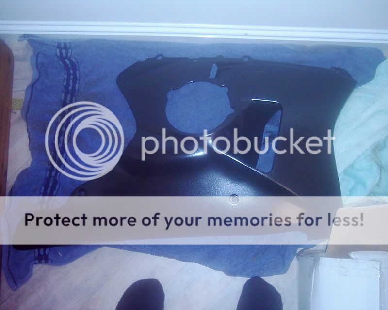

Go with the metallic, aslong as you are going to be patient. Im currently spraying my fairings (which were originally smashed/scratched to peices) metalic black. However its due a repsol Vinyl kit to distract/cover imperfections aswell so i wont worry.
Oh yeah its a CBR400 im spraying aswell Thumbs Up This is the final colour on the first fairing ive sprayed, the rest of them are just primed for now as ive no time between school/work!
https://i96.photobucket.com/albums/l192/Aikman666/DSCI0004.jpg?t=1164844686
https://i96.photobucket.com/albums/l192/Aikman666/DSCI0008.jpg?t=1164844457
