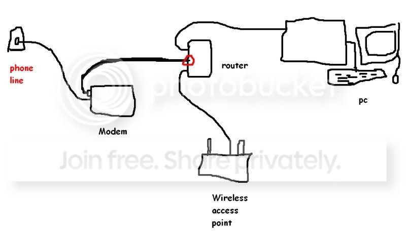

heres an image of the setup i think i need? tell me if im wrong!
the red circle is gonna be my problem as i dont think that router has USB ports, is there a connector avaliable to change this?

techierob
Joined: 05 Oct 2006
PostPosted: 14:55 - 30 Nov 2006    Post subject: Reply with quote
butterob wrote:
does the router go between the modem and the computer?
i only have a usb slot in the back of the modem and another slot for the phone line
ok, this makes sense now. Can you comfirm whether your computer(s) have network interfaces? Assuming they do, you have two options:
1. get a dsl router with usb input
you get a product similar to the belkin that has usb input, then plug the usb lead from your old modem into the router.
2. get a replacement dsl modem/router
this will replace the modem supplied by you broadband provider. You'll need to configure the modem to log to your broadband account using the details provided by your ISP.
The BT voyager would allow you to take either option. As dainesefreak mentioned, it's probably best that you unplug the old dsl modem and configure the new one. This will be more much more hassle than simply uplinking a router to the existing modem, but it'll mean that you've got your connection details to hand in the event of any problems and you'll also be using one component rather than two which halves your chances of having a component fail.
Your ISP should have sent you your username and password in the welcome pack and I'm fairly sure you would have been prompted for the details when the connection was first set up. If you don't have them, then you'll need to contact your ISP
