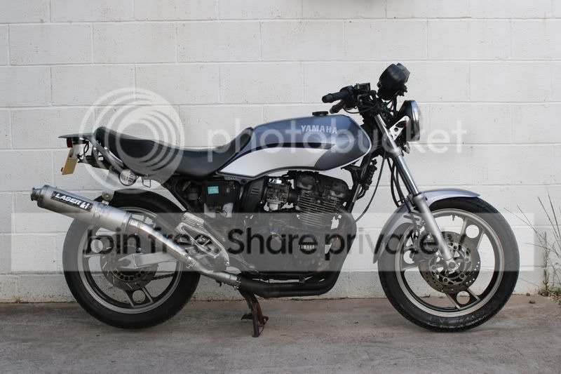

Right then, I'm trying to make my bike go from looking like this:
https://img.photobucket.com/albums/v331/serenaur/IMG_7710smaller.jpg
to look like this:
https://img.photobucket.com/albums/v331/serenaur/img_7710smaller2.jpg
(Thanks to vee for photoshopping that for me Thumbs Up)
I've never done any frame modifications before but I'm not really super worried about messing this bit of the frame up because it's not my main bike but obviously I don't want to just ruin it either!

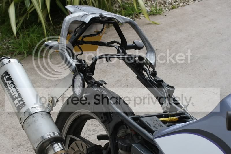

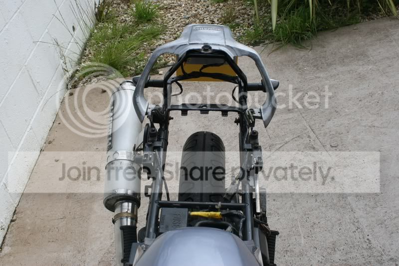

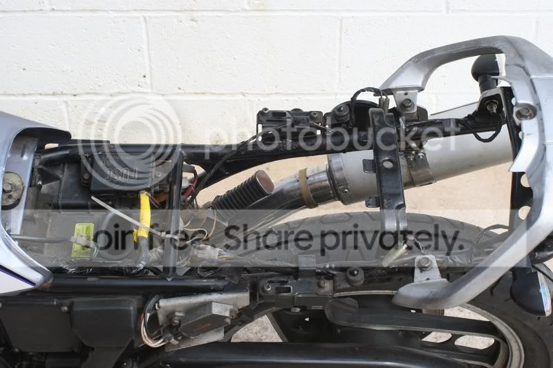

I have no idea where to start to be honest. Here are some pictures of the back of the bike without the seat on it:
https://img.photobucket.com/albums/v331/serenaur/smaller3.jpg
https://img.photobucket.com/albums/v331/serenaur/smaller2.jpg
https://img.photobucket.com/albums/v331/serenaur/smaller.jpg
Has anyone done anything like this before? Any idea's on where I'd cut and then re-weld the frame back together? I know I'll probably have to get someone else to do the actual welding bit for me but I want to try and do as much of this project as I can so I can learn about all this kind of stuff Smile.

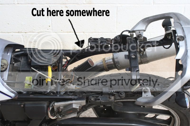

Would I be best off cutting the frame where the arrow is in this picture and then weld some lugs/mounts for the indicators, grabrail and all the other stuff?
https://img.photobucket.com/albums/v331/serenaur/Untitled-1.jpg
Any ideas on how I'd then re-attach the seat?
Any help is much appreciated!

PostPosted: 17:13 - 13 Aug 2007    Post subject: Reply with quote
what id do is cut just a bit further back
and cut out this section
https://img409.imageshack.us/img409/2857/smaller3daveye1.jpg
you could probably cut a bit further
then id re weld it onto the frame if your wanting to keep the same back end that is, it looks like you do in your P'shopped image

Those boxes are just the catches for the seat so I'd imagine that'd be no great loss as I'd probably need to bolt the seat down anyway.
I'd prefer to keep the same back end if possible really.
Will I need to brace the frame after I've cut it to give it a bit more strength when it's all put back together?

From the pics however it looks like all you need is a loop of tube to round out the end, slugged into the seat rails at the point you cut them off.
