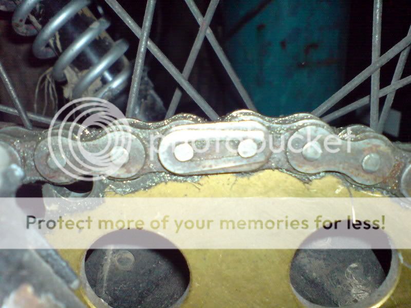

Right i thought i would get a pic for you , here you are :
( the sprocket is the rear one in the pic)
https://i145.photobucket.com/albums/r220/jamie_stokes_2/bike.jpg
so thats how the link goes on anyways facing that direction Thumbs Up
