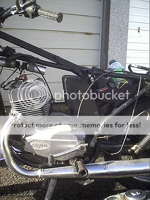

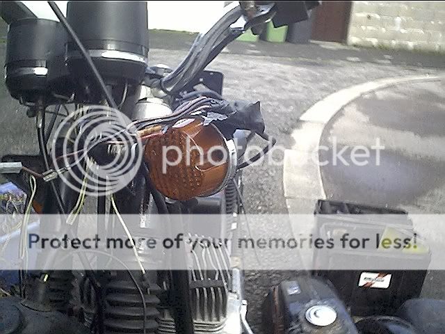

https://i48.photobucket.com/albums/f216/stinkwheel/wires.jpg

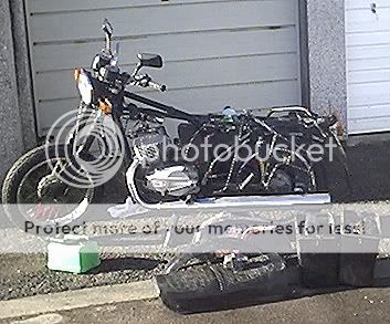

https://i48.photobucket.com/albums/f216/stinkwheel/side.jpg
As it arrived

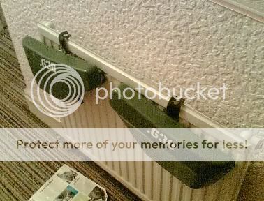

Been doing some painting. Flat green with military style stencilling. Dead slapdash, just brushed on green hammerite but quite pleased with the overall result.
Sidepanels
https://i48.photobucket.com/albums/f216/stinkwheel/panels.jpg

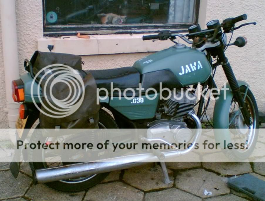

The finished article
https://i48.photobucket.com/albums/f216/stinkwheel/paintjob.jpg
