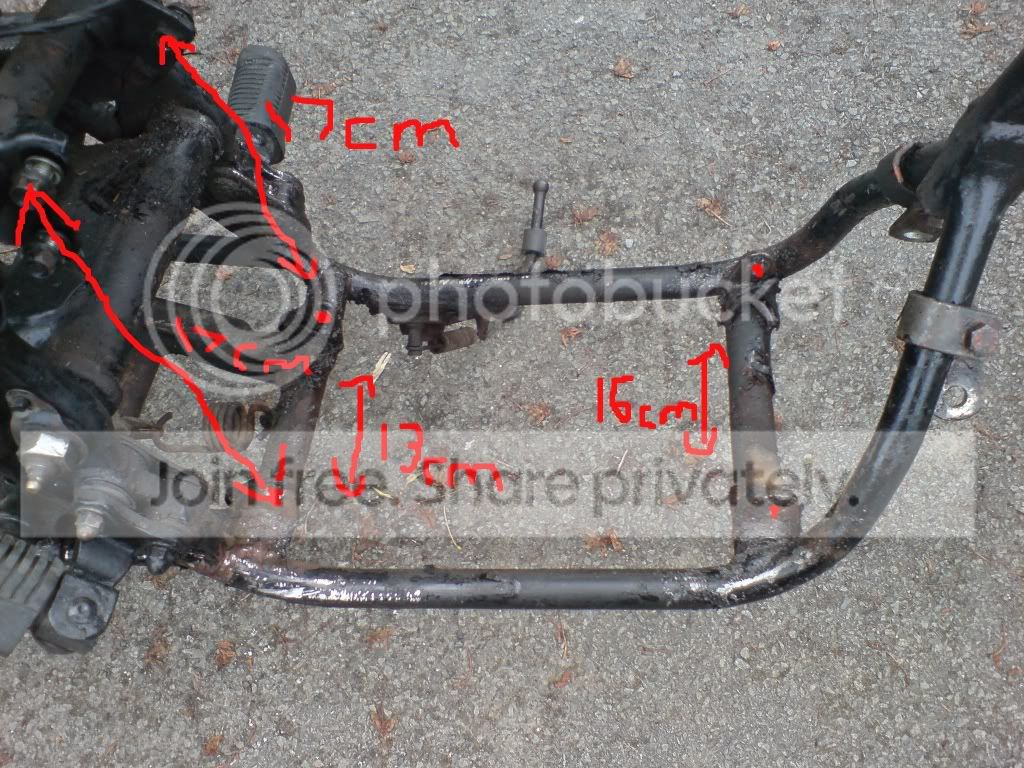

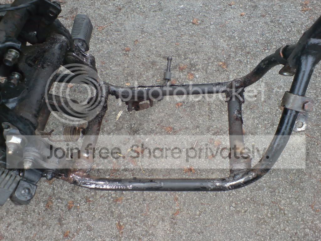

Hi , can any one think of a suitable Engine to fit in here ?
Around the 400cc mark , its just that the cost to fix the engine that all ready in it is not worth it , DO NOT try and say don't bother with putting a different engine in it , just say what engine is around the right size to fit the gap, I personally think that most twin 1980 engines will fit it , am I right in thinking this or not ? Also it will be my dad that sorts the engine brackets and all the wiring and carb issues out with it ect, so it will be done to a very good standard.
https://i155.photobucket.com/albums/s297/honda_tlr/DSC00421.jpg
https://i155.photobucket.com/albums/s297/honda_tlr/DSC00422.jpg
https://i155.photobucket.com/albums/s297/honda_tlr/DSC00423.jpg

Not sayin diddly squat other than a CBR125 engine will fit until you at least post some dimensions of the hole I'm afraid...

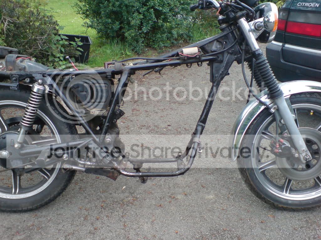

This any better for you?
And:
Why not put another Zephyr 550 in there? About £30-£50 off ebay
A what ? It had a 250 engine in it.
And a 250 engine is to small cc wise.
https://i155.photobucket.com/albums/s297/honda_tlr/likethis.jpg

What engine was in it originally, Jamie?
*EDIT*
Ooops! posting at same time.....
Z250 by any chance?
If so, a Z400 twin will fit if you can get one.
Jamie S
Joined: 28 Dec 2006
PostPosted: 16:19 - 24 May 2007    Post subject: Reply with quote
The bog standard ,17 BHP, 250cc yammy xs engine.
EDIT: This is the engine out of it:
Grav
PostPosted: 16:21 - 24 May 2007    Post subject: Reply with quote
Right.
XS 400 will drop straight in.
