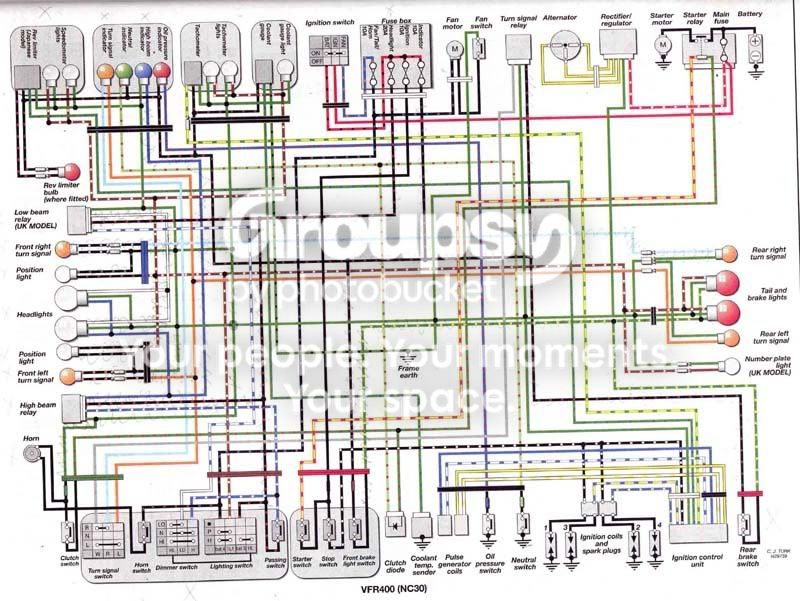

hi after not rideing my nc30 for a few weeks it wont fire up. There is no spark to any the plugs i test with spare plugs no joy. So i changed the coil and kill switch any ideas just dosent want to spark.

PostPosted: 21:02 - 23 May 2007    Post subject: Reply with quote
There is no side stand switch on the NC30.
Are all the connections on the CDI looking clean? If both coil packs aren't sparking then it could be the CDI or the coil pick-ups.
You may need a spare hour with a wiring diagram and a multi meter to get to the problem.
I presume you have checked the ignition fuse Question
Hope this helps....
https://i139.photobucket.com/albums/q292/Cillit-BANG/WiringDiagramPB-1.jpg
