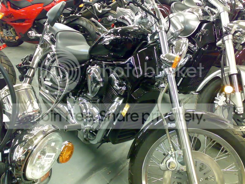

It's a VS800 Intruder. Please don't laugh at the blurry pic, I reckon it's cos Himself is crap at photos whereas he says it's cos I was so excited I was bouncing........... Embarassed
https://i12.photobucket.com/albums/a229/Yambabe/03022007013.jpg
https://i12.photobucket.com/albums/a229/Yambabe/09062007097.jpg
