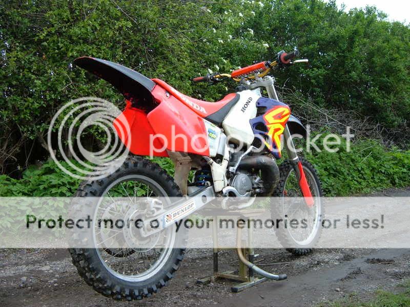

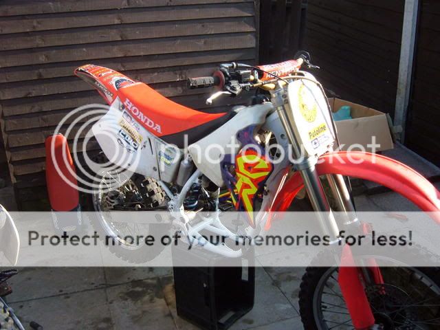

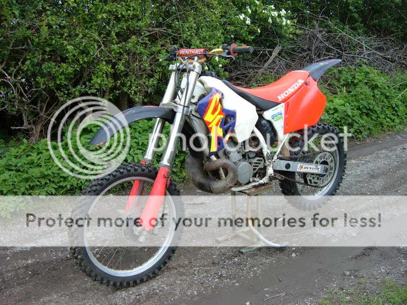

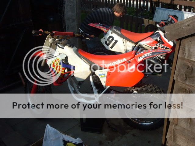

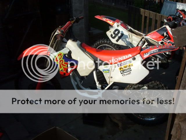

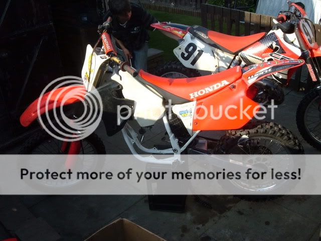

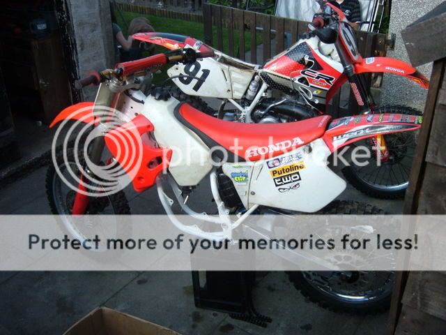

hi just got back before from picking up my 95/96 cr 250 took 4 hours to get there and back but im quite happy with it so far, i bought it off ebay for £410 it has very low compression so obviously doesnt run but all the bearings suspension e.tc are all good and not fucked only thing really is it could do with a new rear tyre and some fresh plastics, but il get that once engines sorted which il be stripping down after ive had some tea lol, so il post up pics of the damage so heres some pics of her and my bros bike aswell
oh and the plastics are proper red not the dull colour they look in the photos
some more pics here: https://www.bikepics.com/members/lee175/95cr250/
https://i86.photobucket.com/albums/k117/lee125_2006/DSCF4519.jpg
https://i86.photobucket.com/albums/k117/lee125_2006/DSCF4505.jpg
https://i86.photobucket.com/albums/k117/lee125_2006/DSCF4507.jpg
https://i86.photobucket.com/albums/k117/lee125_2006/DSCF4518.jpg
https://i86.photobucket.com/albums/k117/lee125_2006/DSCF4524.jpg
https://i86.photobucket.com/albums/k117/lee125_2006/DSCF4527.jpg

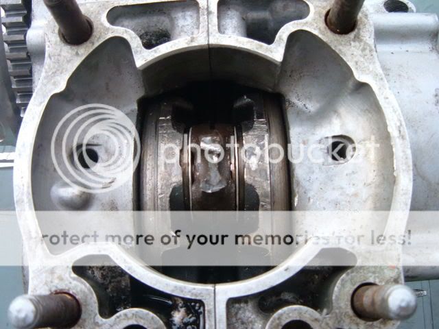

just whipped top end off and engine is fuxxord Sad looks like big ends gone and also some chips out of piston, the big end just wobbles about when you shake the con rod and all theh little roller bearings near enough fall out lol propper fucked the big end BUT somehow the barrel has survived it theres no damage to it like scores,grooves e.tc its all good thank god lol ,so guess its an engine out jobby gonna have to get a con rod kit,piston kit,full gasket set,prob do main bearings and replace the seals aswell but hopefull once its done it will be a good fun bike and reliable so not bothered that its fucked really lol just all next months wages are going on fixing it Smile
heres pics of damage:
https://i86.photobucket.com/albums/k117/lee125_2006/DSCF4536.jpg
https://i86.photobucket.com/albums/k117/lee125_2006/DSCF4533.jpg
https://i86.photobucket.com/albums/k117/lee125_2006/DSCF4530.jpg
https://i86.photobucket.com/albums/k117/lee125_2006/DSCF4531.jpg

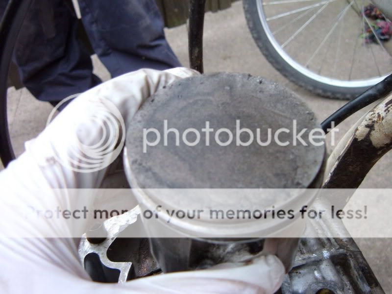

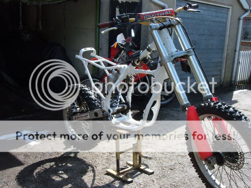

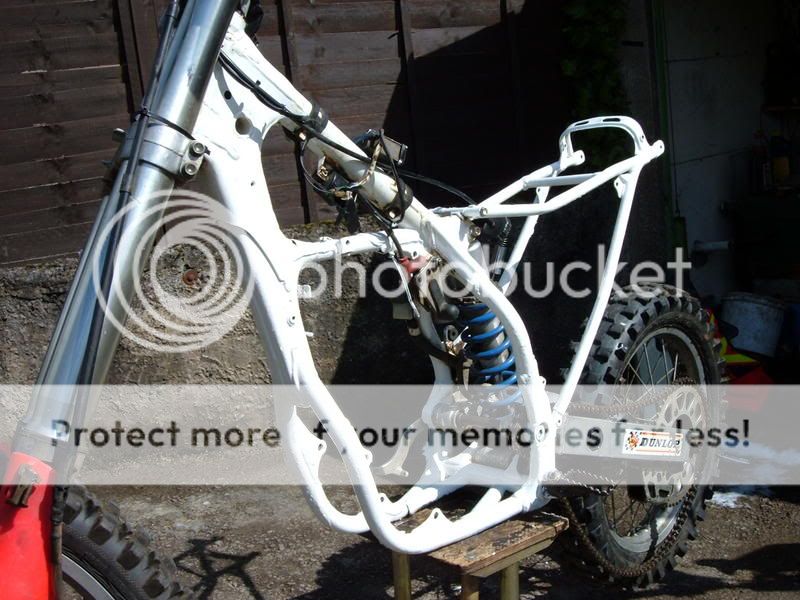

right well seems engines nacked ive got my dealer to price a wiseco,genuine and prox piston kit and same for con rod kit which il find out on monday, anyway yesterday i stripped down the brakes and gave them a good clean and lube so there all good now, and ive started rubbing down mudguards im gonna get some new plastics anyway but there gonna be spares also resprayed front exhaust which looks like new now, and last night took engine out didnt take long at all really, then today took all air box and everything off and started cleaning the frame and getting it prepared then painted it see pics i think it looks much better, well pleased with it just need to get engine rebuilt next month Smile :thumbsup:
https://i86.photobucket.com/albums/k117/lee125_2006/DSCF4540.jpg
right mess
https://i86.photobucket.com/albums/k117/lee125_2006/DSCF4544.jpg
https://i86.photobucket.com/albums/k117/lee125_2006/DSCF4543.jpg
then from this:
https://i86.photobucket.com/albums/k117/lee125_2006/DSCF4541.jpg
to this:
https://i86.photobucket.com/albums/k117/lee125_2006/DSCF4558.jpg
https://i86.photobucket.com/albums/k117/lee125_2006/DSCF4554.jpg
https://i86.photobucket.com/albums/k117/lee125_2006/DSCF4555.jpg
https://i86.photobucket.com/albums/k117/lee125_2006/DSCF4556.jpg

Painted or just washed?
Old bikes >>> https://www.bikepics.com/members/cc123/
Dischord
Joined: 08 May 2005
PostPosted: 20:34 - 19 May 2007    Post subject: Reply with quote
nice little project! keep us updated with pics Laughing
both was a right mess Thumbs Up

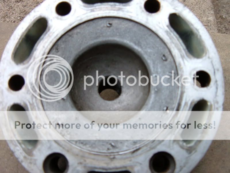

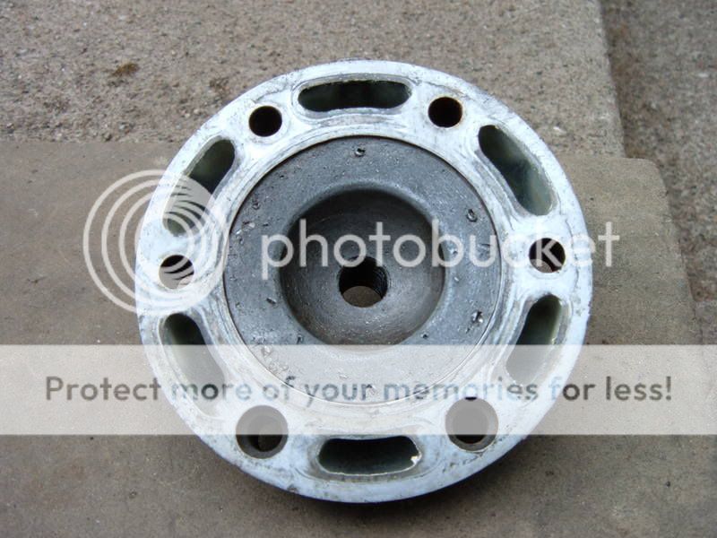

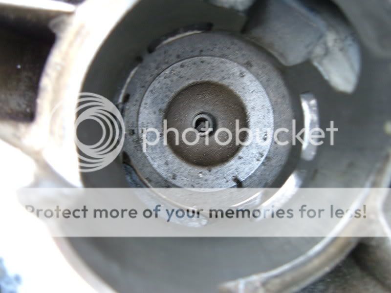

just took cylinder head off bike and its abit damaged Sad think il have to get one from a breakers or ebay or does anyone now if its repairable?? its tooken little chunks out of it heres the pics
https://i86.photobucket.com/albums/k117/lee125_2006/DSCF4573.jpg
https://i86.photobucket.com/albums/k117/lee125_2006/DSCF4576.jpg

From my limited knowledge, I would say that if the raised bits were to be made flush then running it shouldn't be a problem though you may loose some power (not quite sure how much mind) If your really not happy with it then I think finding one from fleebay or similar would be the best route
All the best, Joe

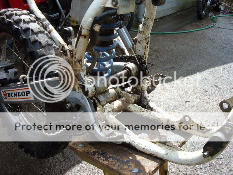

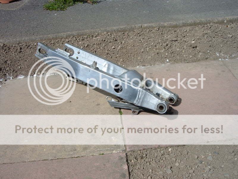

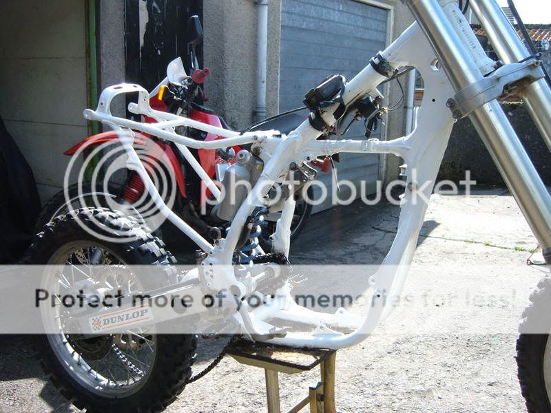

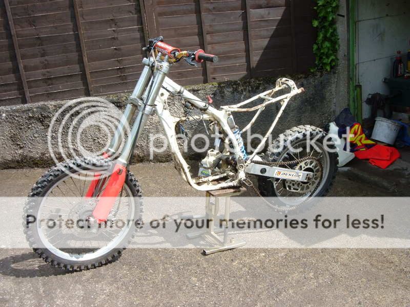

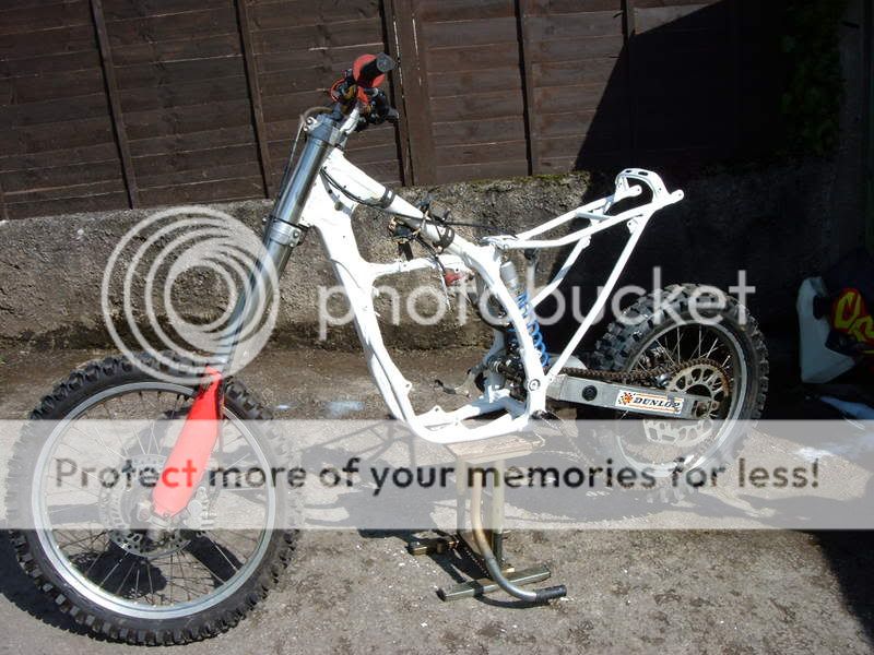

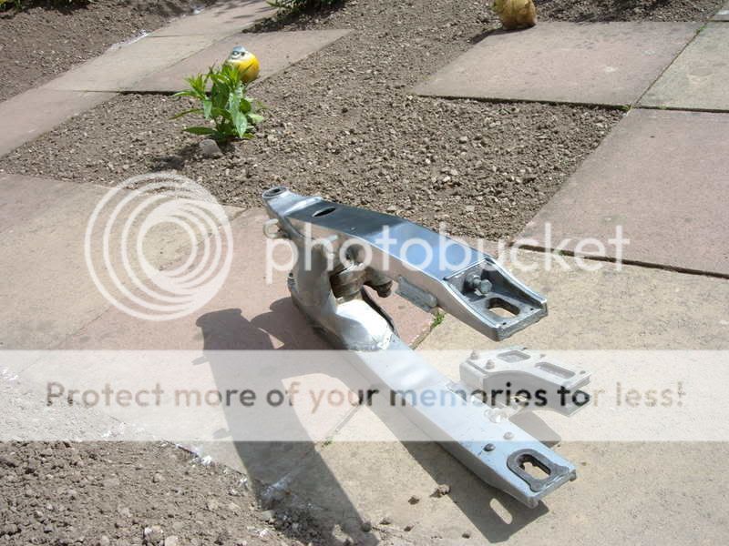

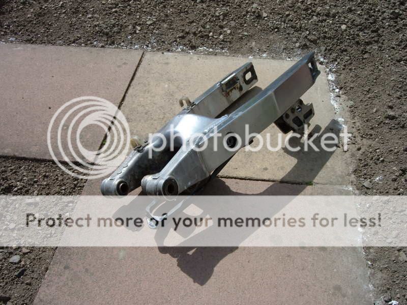

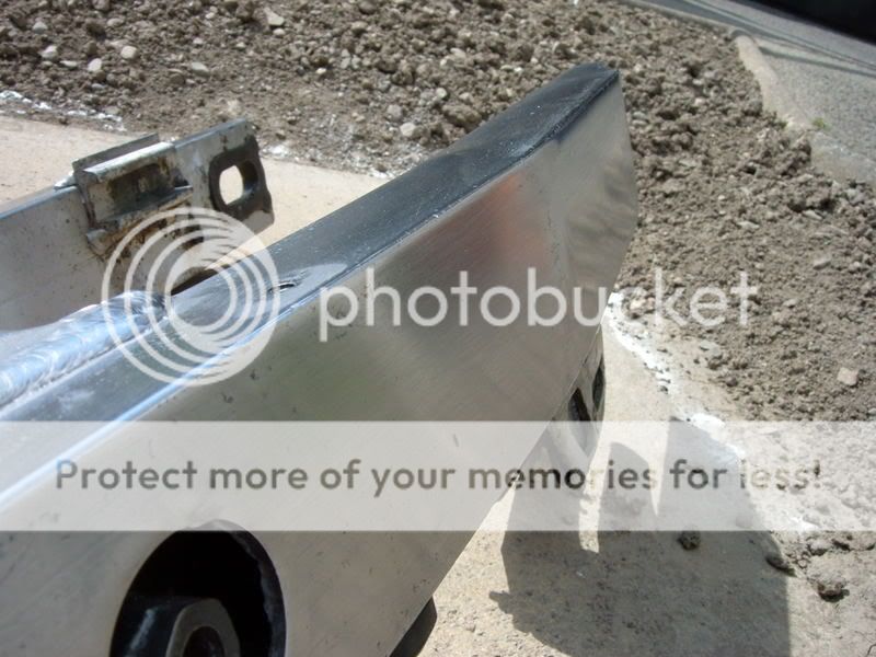

well took swingarm off last night to start scrubbing it down and polishing it up so its chrome 8) started off using 120 wet and dry then whent through all the grades upto 800 then used some rubbing compund then autosol to finish it off took ages and my arms are killing but looks so much better now Smile i forgot to take some before pics Rolling Eyes but ive put a pic of the bike when the swingarm was normal just plain dull so heres the pics of it looks even better in person let me know what you think cheers Smile
before:
after:
https://i86.photobucket.com/albums/k117/lee125_2006/DSCF4602.jpg
https://i86.photobucket.com/albums/k117/lee125_2006/DSCF4603.jpg
https://i86.photobucket.com/albums/k117/lee125_2006/DSCF4604.jpg
https://i86.photobucket.com/albums/k117/lee125_2006/DSCF4605.jpg

Blink
Joined: 08 Mar 2005
PostPosted: 03:24 - 30 May 2007    Post subject: Reply with quote
Good man, mint project. Keep the pics coming.
How're the front forks holding up?
The only way to get rid of a temptation is to yield to it.

cheers mate yeah they are all gd all the seals fine not soft perfect all the suspension wheel bearings e.t.c are all fine so its all good Thumbs Up

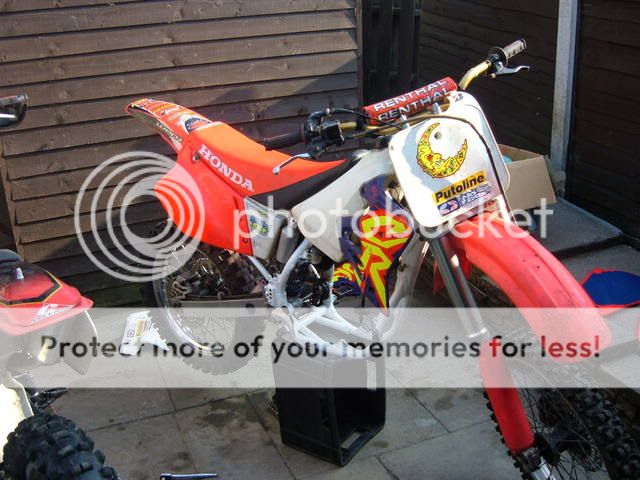

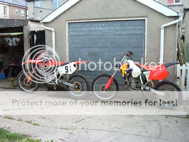

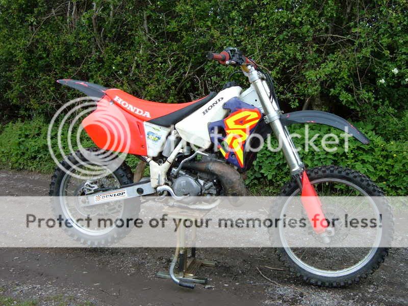

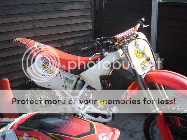

got my plastics today bragain for what i payed just been putting them on loosely to see what looks good which you lot reckon? cheers Smile
https://i86.photobucket.com/albums/k117/lee125_2006/DSCF4681.jpg
https://i86.photobucket.com/albums/k117/lee125_2006/DSCF4686.jpg
https://i86.photobucket.com/albums/k117/lee125_2006/DSCF4684.jpg
https://i86.photobucket.com/albums/k117/lee125_2006/DSCF4685.jpg
https://i86.photobucket.com/albums/k117/lee125_2006/DSCF4687.jpg
https://i86.photobucket.com/albums/k117/lee125_2006/DSCF4689.jpg
https://i86.photobucket.com/albums/k117/lee125_2006/DSCF4688.jpg
opinions??
oh ignore the bit of paint on the wheel i didnt see the tin on the floor when i put the bike down lol il be getting it off tonight haha
cbt passed Smile 01/07/2006 bike:92 dt 125 and 96 honda cr 250
theory:PASSED! A2 test:PASSED 08/11/2006 restricted to 33bhp for 2 years
lee125
Joined: 18 Dec 2005
PostPosted: 20:31 - 07 Jun 2007    Post subject: Reply with quote
i think im gonna do the second pic as thats my favorite but not sure lol

nice one mate Thumbs Up
This puts me in notions for doing the same to my cr80. Need frame, swingarm done and new plastics. The cylinder head is ALOT worse than yours, mate went on it without water and seized it Sad
But yea keep the pics coming.

2nd and 4th pics deffo the best looks ace!

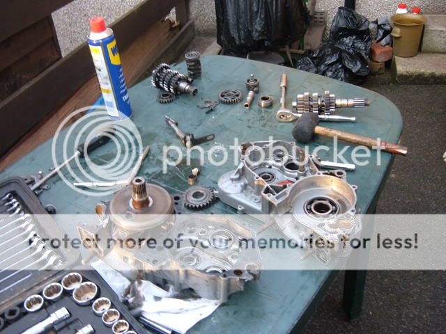

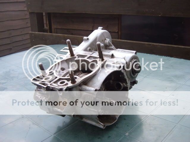

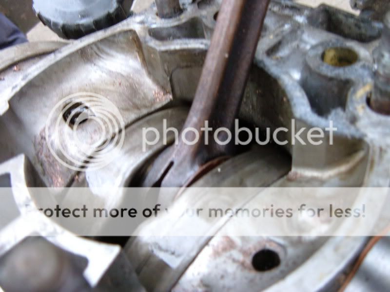

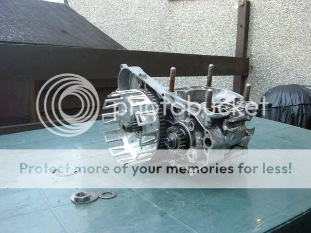

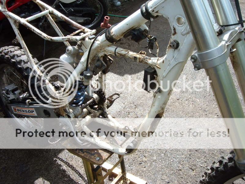

right anouther update got my engine split all parts here and one of teh shafts with all the gears on had a chunk out of each one so needed a new one of them and the selecter drum and anouther cog been looking around and a guy 20 mile from me was selling this bottom end with a snapped con rod but he said if the gearbox was nacked he'd take it back and refund us it was £70 casings are nacked but i just wanted the box so got it back tonight and split it and it was all good so taking the bits round to garage tomorrow and hopefully it be all rebuilt by end of week Very Happy
took some pics lol Laughing Smile
https://i86.photobucket.com/albums/k117/lee125_2006/DSCF4764.jpg
https://i86.photobucket.com/albums/k117/lee125_2006/DSCF4767.jpg
engine split:
https://i86.photobucket.com/albums/k117/lee125_2006/DSCF4770.jpg
parts i needed out of it:
https://i86.photobucket.com/albums/k117/lee125_2006/DSCF4769.jpg
oh and the snapped con rod god knows how that happened Shocked
https://i86.photobucket.com/albums/k117/lee125_2006/DSCF4766.jpg
