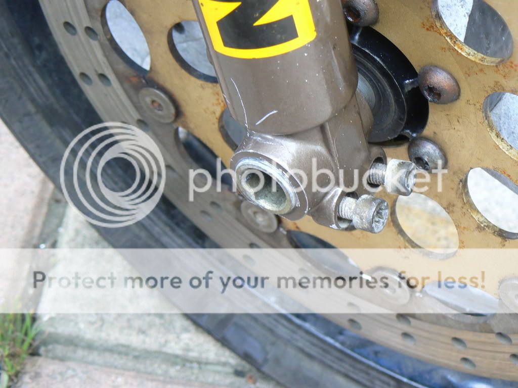

hi im in the process of doing up a 1994 mito. i need to get the front wheel off to get it sprayed. ive undone the two allen bolts on each fork leg and have tried knocking the axle out but im getting nowhere fast. anybody had this problem before and how could i get it out

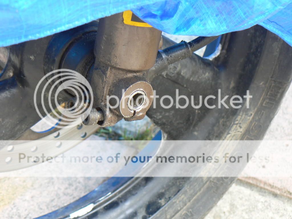

ive undone the pinch bolts till they fall out ive hit it with a hammer and a solid bar and i dont think its a threaded bar heres a couple of pics

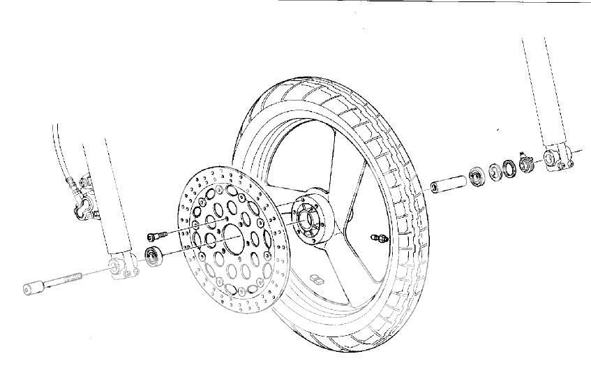

https://i58.photobucket.com/albums/g257/hmmmnz/mitowheel.jpg

you need an allen key in side the disk side of the wheel.
EDIT see the pic above.
hmmmnz
PostPosted: 11:34 - 06 Jul 2007    Post subject: Reply with quote

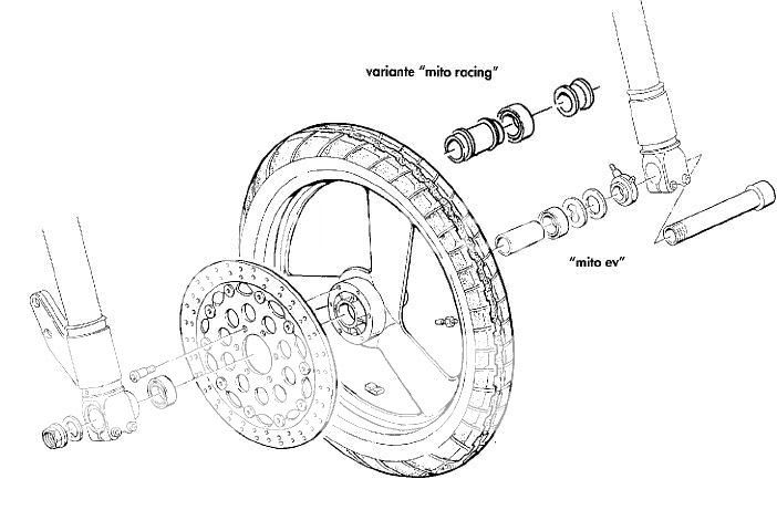

you have to use a big allen key/driver and "unscrew" the axle from the fork leg then use a drift to get it all the rest of the way through
i think this is your model as it has no nut on the end
https://i58.photobucket.com/albums/g257/hmmmnz/oldermito.jpg

ok cheers thats me knackered then i dont have a allen key that big i thought it would be the same as the 1 on my yz125 just knock it out
