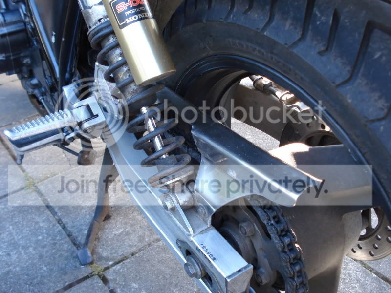

https://i32.photobucket.com/albums/d20/andy13_uk/DSC01102.jpg
https://i32.photobucket.com/albums/d20/andy13_uk/DSC01101.jpg
https://i32.photobucket.com/albums/d20/andy13_uk/DSC01103.jpg
I brought it on myself really. I adjusted it the week earlier and was on the tight side but thought nothing of it as done it many times before and been tighter than that are just sorted itself out. Oh well, thats the price for conplanecy Rolling Eyes

Unlcuky matey, but at least it came off cleanly and didnt wrap itself round one of the sprockets.

is that what a chain guard is for ? to stop the chain going flying tpwards some one when it snaps ?

If you look it broke his.
Yea but its just plastic so a bit useless really as it snapped, though i dont think any material could stop that with the force it had Confused

Nope, its to stop you putting any body parts into or on the chain while it it moving. Even a metal chain-guard will not stop it flailing about if the chain snaps.

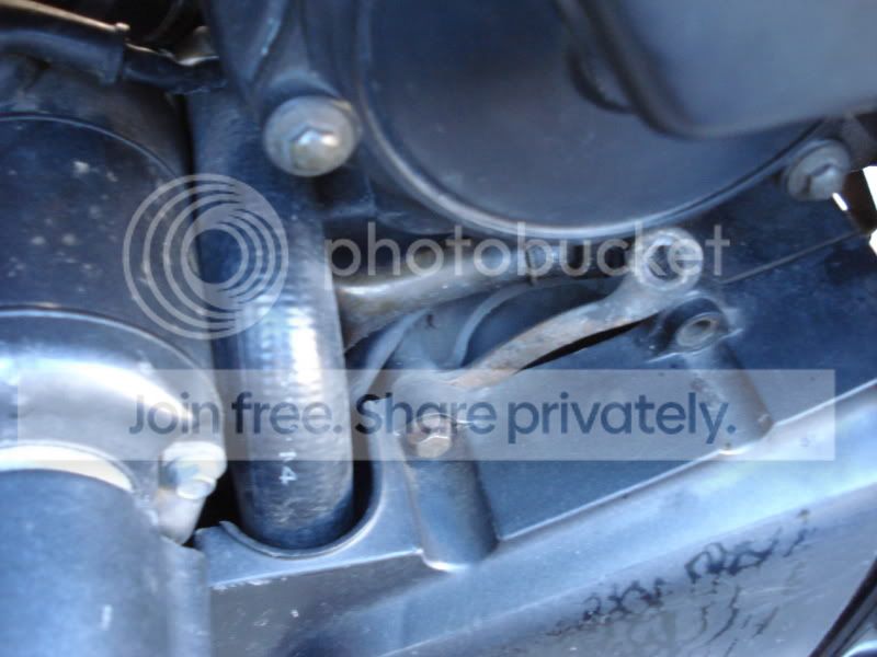

So, spent a few hours getting it ready for new parts. Unfortantly don't have access to a garage but since its summer this isn't a problem.
The wheel off and gave it a little clean. The hugger just wouldnt come off, which is annoying. This is probably due to 4 years of road grime Confused
https://i32.photobucket.com/albums/d20/andy13_uk/DSC01109.jpg
Took a look at the front sprocket and the washer is bend, so ordered on of those and the panel for £114 Shocked
https://i32.photobucket.com/albums/d20/andy13_uk/DSC01108.jpg
getting a chain guard on some guy on ebay who when i ask postage said £10!!! When i told him the other week i spent a exhaust for £4 he said he would get a more accurate quote tomorrow Laughing
Front sprocket cover was fairly scratched inside but that hardly surprising i guess, works fine for its purpose

are you talking about that bent bit folding over the nut as a washer?
If so its supposed to be like that, your supposed to hammer over the washer after doing up the front sprocket as there are lots of forces going through it, it needs that extra bit of securing.

Andy, you really should replace both the sprockets too, otherwise you'll not get the best from a new chain.
If not just ignore me Smile
Luke
Neutral So when i rang up a place and they told me that was wrong they were lieing!?!??! Ive never done this before (a friend who has it fitting them with me) and today was just getting her ready for the parts.
I do feel a little embrassed though, i take it i need a new one when i replace the sprocket to hammer for snug fit?? Thanks for the heads up though Thumbs Up

That washer has been punched over with a screwdriver, for safety. I believe some R6 ones came adrift, and it has to be an issue on any bike configured that way. Get a new washer with the sprockets and do it likewise. Thumbs Up

cool Embarassed . Least i posted up some photos before going ahead with that one Rolling Eyes . My friend would have given me a slap if id said that Laughing
Hetzer, wasnt that what happened to Yokos bike?
New C+S ordered from B+C. £105 which isnt bad at all Thumbs Up
Hetzer
Joined: 19 Feb 2007
PostPosted: 18:42 - 11 Jul 2007    Post subject: Reply with quote
Andy C wrote:
Now you mention it, yes, it was. It was an issue with that model IIRC.
