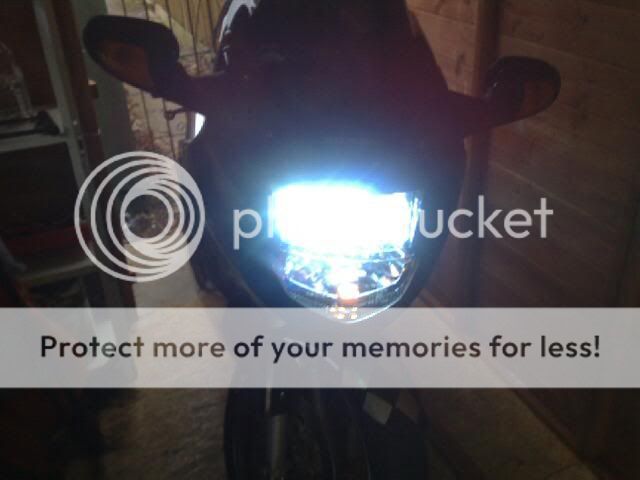

Here is a picture, its crap but you get the point.
https://img.photobucket.com/albums/v678/blazebrown/22102007133.jpg
As for h1 to h4, hmm thats kinda awkward because a h4 bulb is much bigger than a h1. If you could fabricate some sorta ring to fit round the bulb holding is straight in the h4 holder you'd be fine. A h1 bulb locates with 2 small bumbs on it, the h4 locates using 3 lugs. Its probably doable but you'd have to remove the headlight and do it that way.
Not sure about wheelies, cos i dont do them. Laughing

looking goooooooood Thumbs Up looks FRESH!....so its that just one bulb with 2 filament's?
well only other option iv seen, is the bulbs unplug a bit down the wires so could just buy H4 bulbs & plug them in Very Happy
BUT cant seem to find 7000K replaceables Sad only 6k or 8k but there still good if it means i can have HID Twisted Evil
