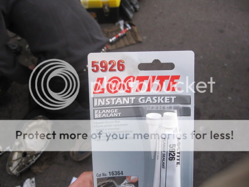

We couldn't find a gasket Saturday so hoped we could use the old one or use liquid gasket. When we cracked her open we soon realised we wern't gonna use the old gasket it was broke in loads of places and firmly attached to both sides of the casing. Scraping gasket is the shittiest job ever especially when it is 1 degree out and you don't have a garage to work in. Anyway after dreading taking the clutch apart it turned out to be a fairly easy job, new plates went in and we tried using Instant gasket to make a seal. I started her and she pissed oil all over the place we took everything off and again and applied the gasket more liberally and started her again pissed oil out, again. I then read the packet, Instant gasket isn't as instant as it claims you need to wait 24 hours for it to harden .

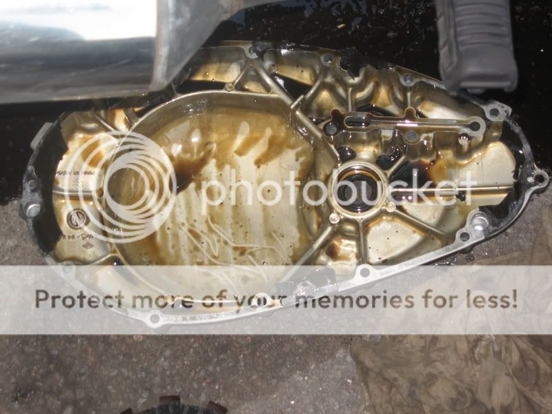

https://img.photobucket.com/albums/v295/chris-red/IMG_3310.jpg
Inside the case.

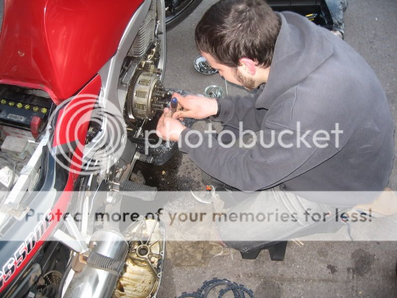

https://img.photobucket.com/albums/v295/chris-red/IMG_3312.jpg
and again.

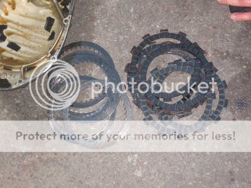

https://img.photobucket.com/albums/v295/chris-red/IMG_3313.jpg
Nackered plates
