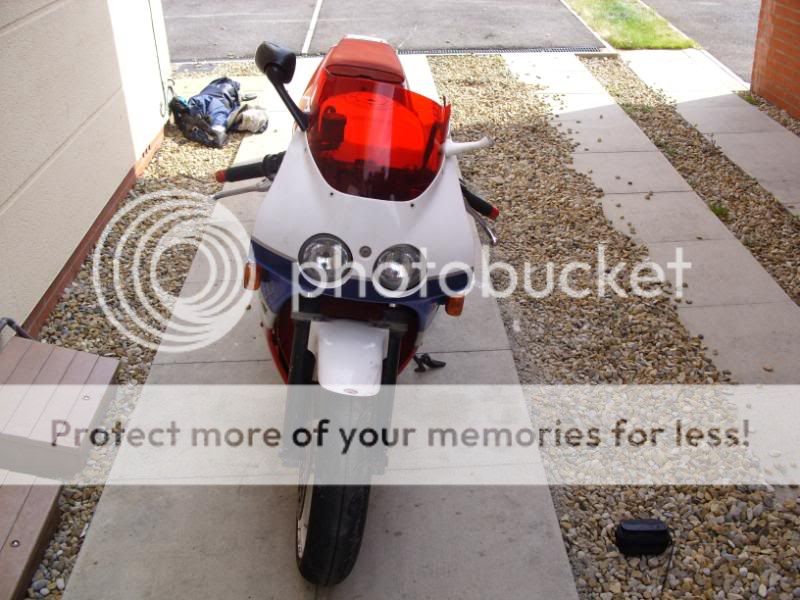

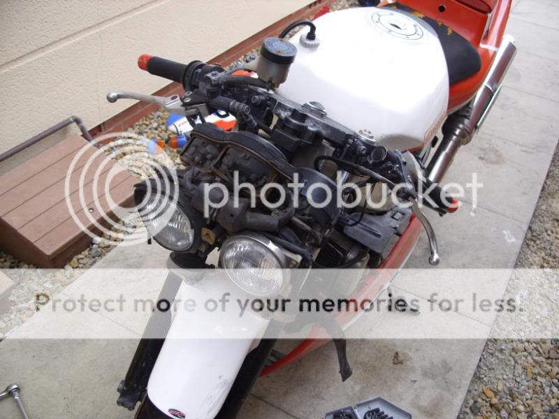

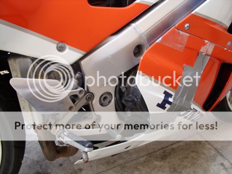

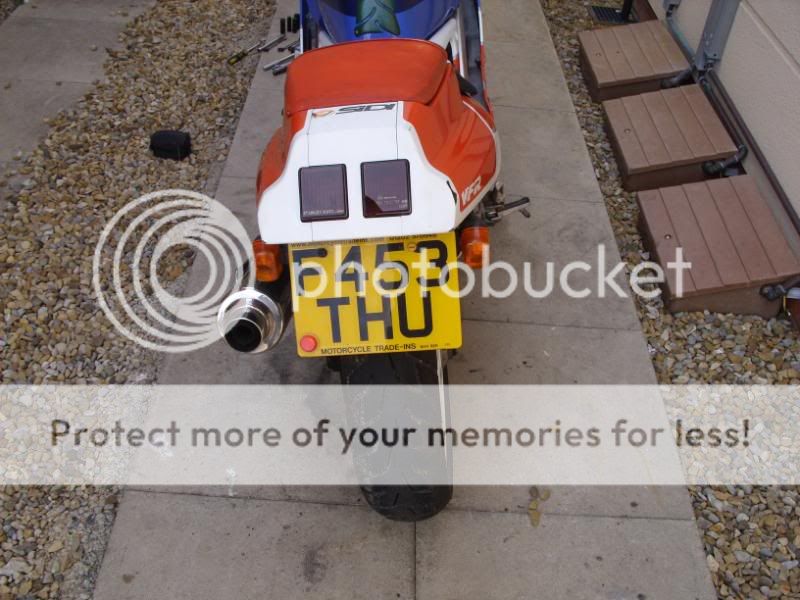

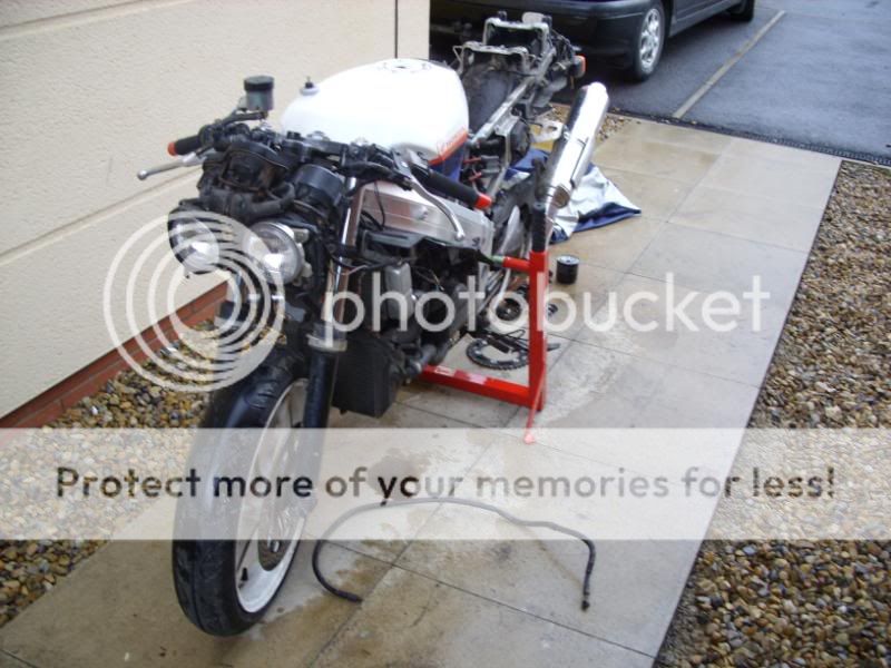

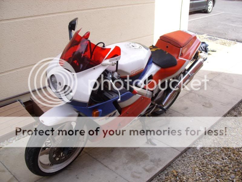

Was on the lookout a few weeks back for a cheap VFR with knackered plastics. Found one for £500. Not the prettiest but here she was:
https://i17.photobucket.com/albums/b53/TDMEvOrAcEr/VFR400%20Project/SS850113.jpg
https://i17.photobucket.com/albums/b53/TDMEvOrAcEr/VFR400%20Project/SS850104.jpg
https://i17.photobucket.com/albums/b53/TDMEvOrAcEr/VFR400%20Project/SS850109.jpg
https://i17.photobucket.com/albums/b53/TDMEvOrAcEr/VFR400%20Project/SS850105.jpg
https://i17.photobucket.com/albums/b53/TDMEvOrAcEr/VFR400%20Project/SS850111.jpg
Then started building ideas and ordering parts, Started taking it apart, First purchase was the Abba stand with swingarm removal kit. It's ACE ! Then the haynes manual, Also ACE !

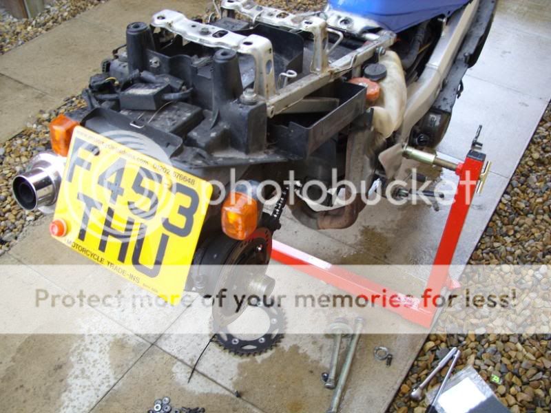

Getting rid of bits i didn't need:
https://i17.photobucket.com/albums/b53/TDMEvOrAcEr/VFR400%20Project/SS850114.jpg
https://i17.photobucket.com/albums/b53/TDMEvOrAcEr/VFR400%20Project/SS850116.jpg
Rusty, Gone very soon Wink
https://i17.photobucket.com/albums/b53/TDMEvOrAcEr/VFR400%20Project/SS850118.jpg

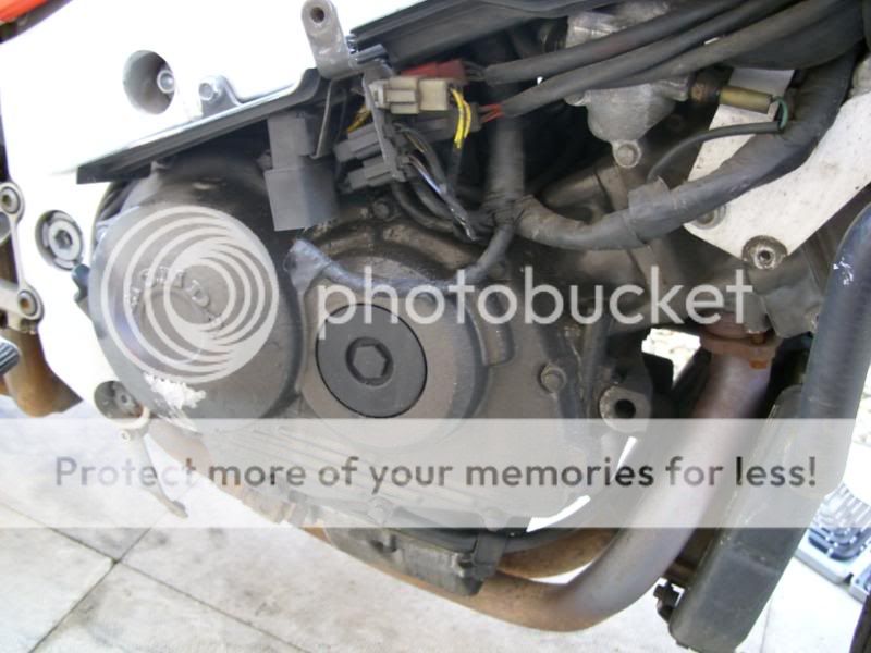

Rads going off.
https://i17.photobucket.com/albums/b53/TDMEvOrAcEr/VFR400%20Project/SS850140.jpg

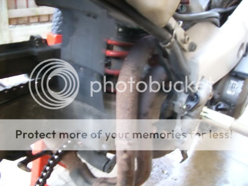

Exhaust coming off.
https://i17.photobucket.com/albums/b53/TDMEvOrAcEr/VFR400%20Project/SS850139.jpg
https://i17.photobucket.com/albums/b53/TDMEvOrAcEr/VFR400%20Project/SS850138.jpg
Up to "Near" now(Hmm rads and exhaust are still on, Who fitted them back on without telling me !) Not got a "now" pic then, Tomorrow i will.

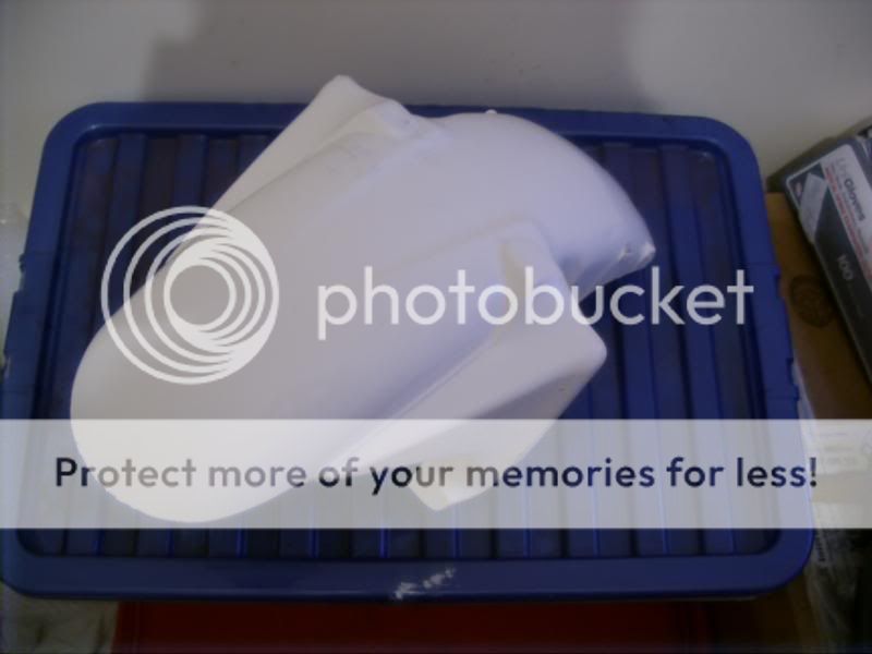

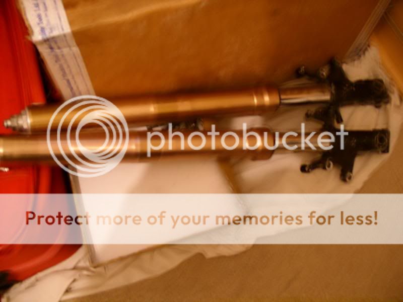

https://i17.photobucket.com/albums/b53/TDMEvOrAcEr/VFR400%20Project/SS850143.jpg
ZXR fibreglass fender
https://i17.photobucket.com/albums/b53/TDMEvOrAcEr/VFR400%20Project/SS850144.jpg
ZXR USD's, Needs lowers coating over

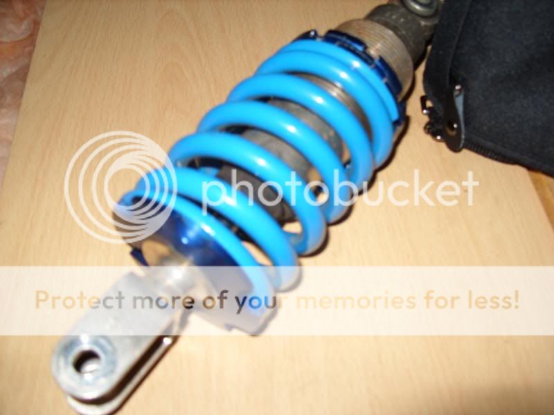

https://i17.photobucket.com/albums/b53/TDMEvOrAcEr/VFR400%20Project/SS850149.jpg
Nitron Rear Shocker
It's costing a bloody fortune, God knows how i'm paying for it. Let's just say my ass is sore Mr. Green Sick

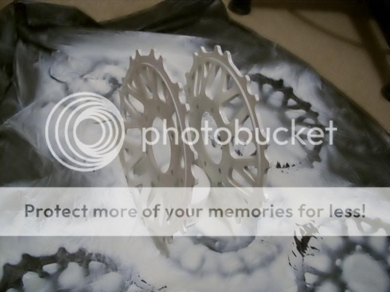

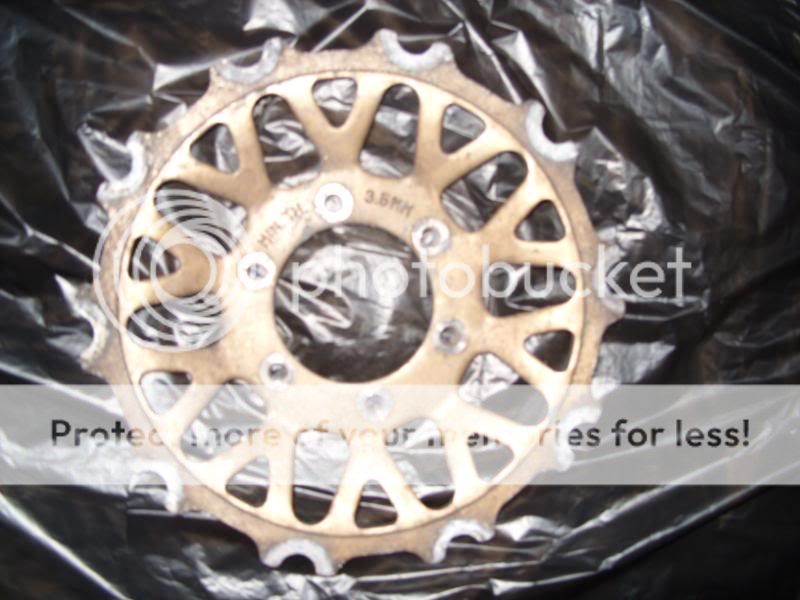

Got new front outer waveys on way for the ZXR front end, meant to do this days ago so they could go to powdercoating but too late so finally decided to sort me old inner discs out today, Took a trip to argos for a budget grinder. Bloody £9.99 ones had sold out Sad , £24.99 for a slightly better one. Got back ready to have fun with the new toy, Wipped of the old rivets on the discs, binned the old outers and this is what we're left with:
https://i17.photobucket.com/albums/b53/TDMEvOrAcEr/VFR400%20Project/SS850159.jpg
18 Years of corrosion on them babies. Started the long boring process of sanding them down ready for spraying, Took bleeding ages but they came up ok. Time for primering:

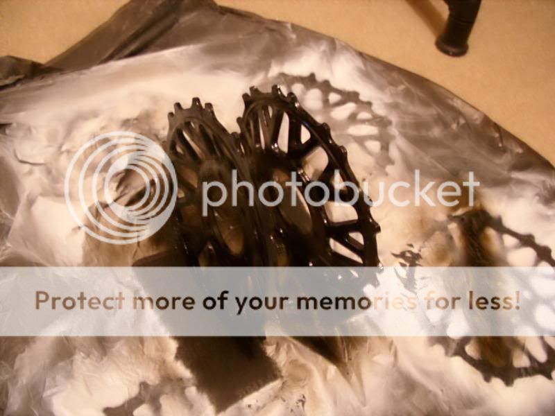

https://i17.photobucket.com/albums/b53/TDMEvOrAcEr/VFR400%20Project/SS850163.jpg
5 Coats of primer and endless hours later, It's took the whole day but we're finally ready for the main black coat.
https://i17.photobucket.com/albums/b53/TDMEvOrAcEr/VFR400%20Project/SS850164.jpg
Whole bike should be finished in 2 weeks. Waiting on parts, Postman laughs on a morning, i think i'll have my own postal van soon.

how did you do that? is it easy? how hard is it to put em back together?
Haz ER-5, innit!
Evo
Joined: 06 May 2007
PostPosted: 00:30 - 24 Sep 2007    Post subject: Reply with quote
They use rivets to secure the 2 pieces together. Grind the edge of the rivet off then smack it with a hammer and it pops out. This is my first time doing it by the way but apparantly reinstalling just requires a pair of circlip pliers. How that works i don't know, i'll see when the discs arrive.

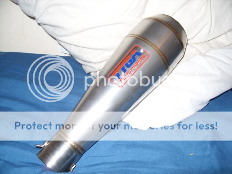

Woo new exhaust end can came today:

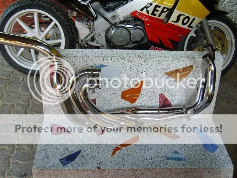

Also my talented oriental man has informed me my underseat exhaust system has been fabricated. Very Happy
https://i17.photobucket.com/albums/b53/TDMEvOrAcEr/VFR400%20Project/nc30_england_5.jpg

Got my rebuild kits for discs yesterday from stealth, Joined the inners to outers and look like this:
https://i17.photobucket.com/albums/b53/TDMEvOrAcEr/SS850279.jpg
Lonewolf they're easy to rejoin.
Pic shown here:
https://i17.photobucket.com/albums/b53/TDMEvOrAcEr/SS850281.jpg
10 seconds to do each rivet head.

black outers and white iners? how???
Haz ER-5, innit!
Evo
Joined: 06 May 2007
PostPosted: 00:22 - 30 Oct 2007    Post subject: Reply with quote
Split the inners from outers by grinding heads off.
Powdercoated inners and ordered Stealth Waveys, Refit with new circlip rivets.
Thats how Smile

Sweet mate, am looking forward to how it will look, and especially how that underseat exhaust looks/sounds when its finished! keep us posted Thumbs Up
Graham88
Joined: 03 May 2006
PostPosted: 06:19 - 31 Oct 2007    Post subject: Reply with quote
That exhaust system is awesome Shocked
The pipework looks a little clumsy to me.
Is it definately for an NC30 though? The bike in the background looks like a tortured RC30...

I was wondering abuot the Repsol bike, that aint at yours, is it?

And also does the exhaust come out like this one?

Pipework is for an nc30 and has been fitted upon my bike.
