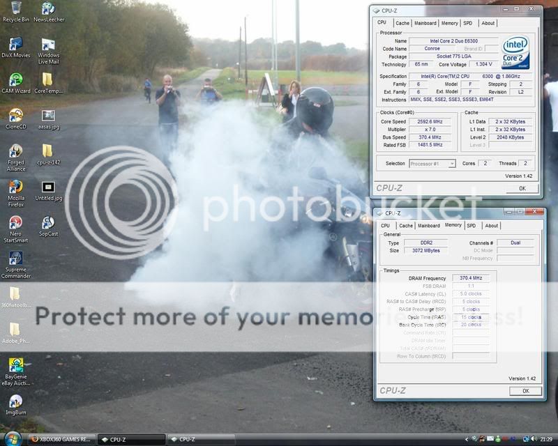

Dave this is mine
https://img.photobucket.com/albums/v707/lllN30lll/dede.jpg
I couldn't get my ram to run at 400, closest i could get was a stable 370.
I turned the FSB up in the bios which took my cpu to 2.6ghz and the ram to 370.
am i right in doing that?

lllN30lll
Joined: 12 Jun 2005
PostPosted: 21:29 - 08 Dec 2007    Post subject: Reply with quote
just noticed your multipliers on x 8, mines on x7, how do i change mine to 8? or should i leave it.

k mate, i slowly edged up my FSB today, stock was 266 i think, ended up on 370, any more after that and windows wouldn't boot, i take it thats when i need to start raising the voltages.

Stock would be 266, if your at 370 x7 it will be at 2590mhz, which is a pretty respectable overclock. Before going any further, make 100% sure its stable at that. Orthos will generally error pretty quick. I would run it for a few hours to be sure (some people run it for days to be sure), also get several hours of memtest (use tests 5&8).
