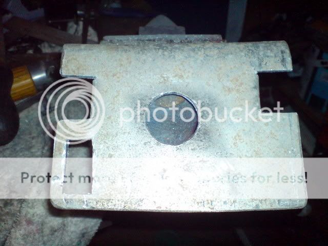

I then bent a right angle on one end , using a large hammer.
Then used a hole cutter to cut the hole for the regulator/ water trap.

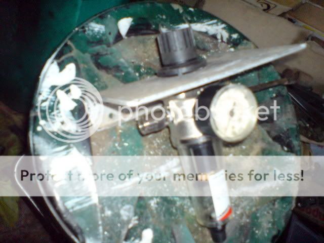

Then checked that the regulator was going to fit in the hole properly.
https://i155.photobucket.com/albums/s297/honda_tlr/DSC01058.jpg
I then cut a hole for the gun to rest in and also cut 2 flaps out for the hose to rest against.
https://i155.photobucket.com/albums/s297/honda_tlr/DSC01063.jpg

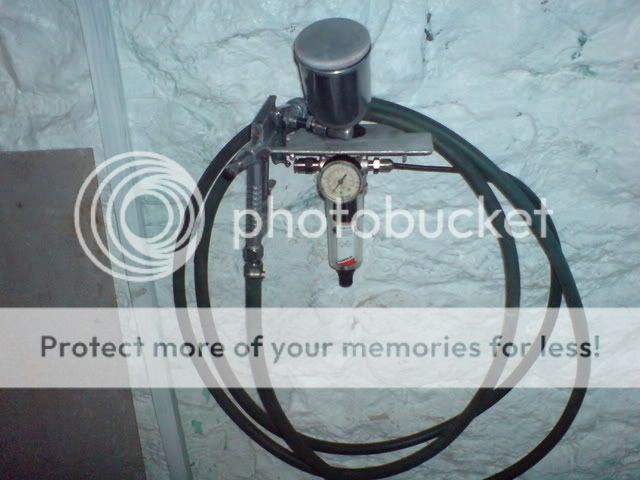

And the finally cleaned up the metal and assembled it on the wall. just like this:
https://i155.photobucket.com/albums/s297/honda_tlr/DSC01064.jpg

Cheers Jenks. Thumbs Up
A proper holder just for the regulator is about £20 so saved a fair bit. Smile
The ally was free and I found the regulator upstairs in the garage.
Very Happy

Nice work! Get a file and straighten up those edges though. If a job is worth doing, its worth doing properly.
Thanks , I have filed it down ,after I took the pictures.

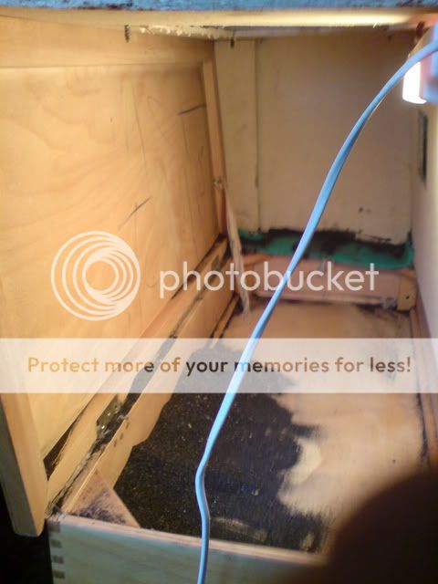

I will be making a wooden shot blasting cabinet over the next few weeks , will post pictures once it's done if any one is interested?
A perspex one might be better and certainly more 'seethroughable'.
Jamie S
Joined: 28 Dec 2006
PostPosted: 21:46 - 04 Dec 2007    Post subject: Reply with quote
Whosthedaddy wrote:
an all perspex one would be way to costly , the viewing window will be perspex though.
Going to use mdf or ply wood , costs around £5 for a 60cm by 120cm sheet.
i dont know muchabout how much power a shot blaster kicks out but wouldnt something a bit stronger than plywood do the job better? perhaps a sheet metal 'coating' on the inside?

I was gonna suggest the same as what virus said,
Something like thin sheet metal covering the internals of the box, and make it double the thickness of whatever wood youre using, maybe 10mm of mdf? (It may be heavier, but a damn site more durable)
Cool idea though mate. I take it youve already got a shot blaster?

Jamie S
Joined: 28 Dec 2006
PostPosted: 14:04 - 05 Dec 2007    Post subject: Reply with quote
Right, my improvised base and one side , thanks dad for the loan of your stall (he doesn't know yet Laughing)
Still need to get some thin sheet steel and some play wood.
Going to have to wait for my gloves to arrive , oh and my shot blasting "unit" and a 25kg bag of shot blasting grit.
Very Happy

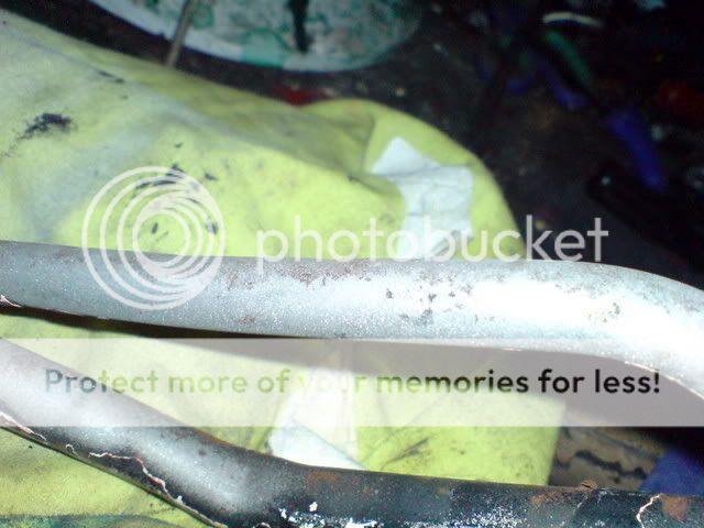

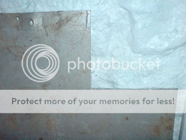

Hi , I made the shot blaster. I have been using it all day today with good results as well.
Here are some pictures.
https://i155.photobucket.com/albums/s297/honda_tlr/DSC01133.jpg
https://i155.photobucket.com/albums/s297/honda_tlr/DSC01132.jpg
(Top rail)
