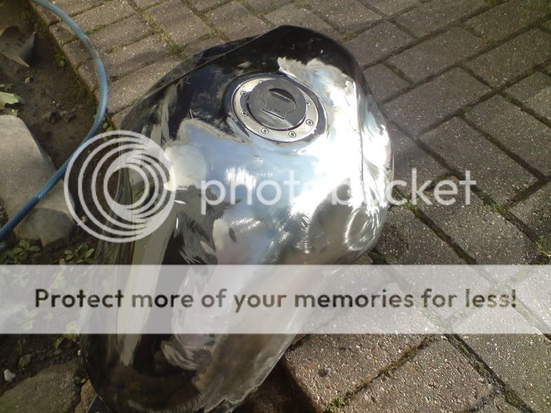

First, I started with the tank as it had the slight defect of a big split down the side. Shocked
Began by stripping all the old paint off with a drill that had a paint stripping wheel attachment i bought (with an old credit note for B&Q Very Happy )
https://i6.photobucket.com/albums/y205/mowgli0929/bike%20project/DSC00650.jpg
https://i6.photobucket.com/albums/y205/mowgli0929/bike%20project/DSC00652.jpg
Then...the split... 'hmmmm' I thought 'well I can't weld, so thats me f*cked'. Then realised that there was a tractor mechanics down the end of my drive and that the owner owed me a favour Thumbs Up
They had a go at welding it but to no avail...apparently the metal is too thin at that point. Luckily though they are clever buggers and filled the hole (which was right on the seam) with loads and loads of solder, which worked great Very Happy
I then used an angle grinder (drill attachment again...sob) to smooth out the solder and make it flush.

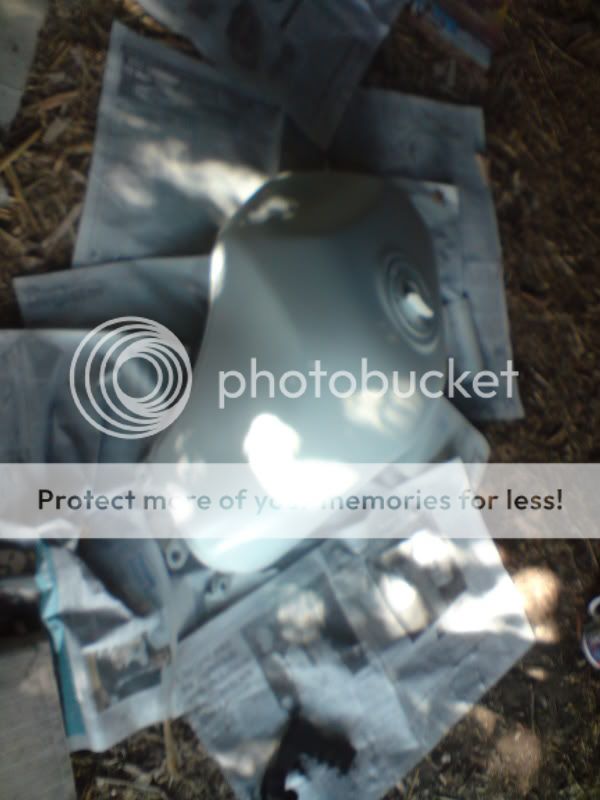

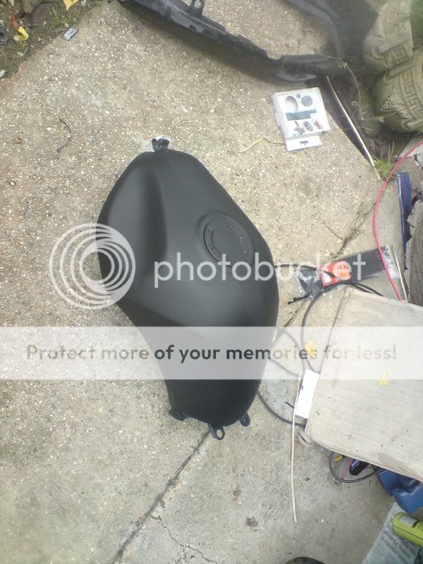

Here's the tank with two coats of primer, then two white coats (btw all paint used in this project was rattle can) :
https://i6.photobucket.com/albums/y205/mowgli0929/bike%20project/DSC00681.jpg

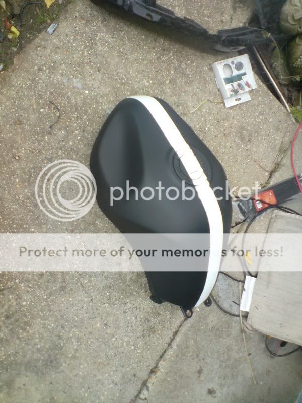

Then I put a wide strip of masking tape down the middle and did three coats of matte black on top:
https://i6.photobucket.com/albums/y205/mowgli0929/bike%20project/DSC00683.jpg
Then 24hrs later took off the making tape to reveal....
https://i6.photobucket.com/albums/y205/mowgli0929/bike%20project/DSC00684.jpg
So..that's the tank, matte black with a white stripe.

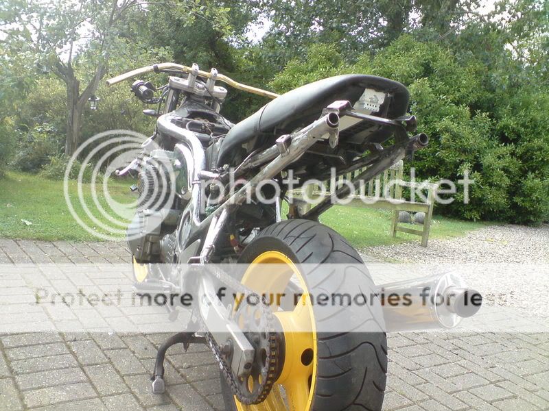

Then I moved onto the frame. I took off the fairings on the rear of the bike to get a clear look at it, and that's when it hit me!!! EPITHANY MOMENT! What I'd been trying for AGES with the bandit was to get more clearance between the back wheel and the tail and have a thinner back end, like more modern bikes. I know there were ways to do this...I tried a new undertray etc but couldnt afford some of the more drastic measures. Anyway the 99 bandit tail is horrribly chubby due to the fairings.
I realised when I had the back fairings off how much BETTER it looked with just a steel tube frame and a seat perched on top...almost hovering. Sure...the frame was adorned with lots of horrible metal fixtures etc but I figuered it could all be sorted out.
SO....now I decided that there would be no more fairings at all and all the electronics would have to be relocated. Very Happy

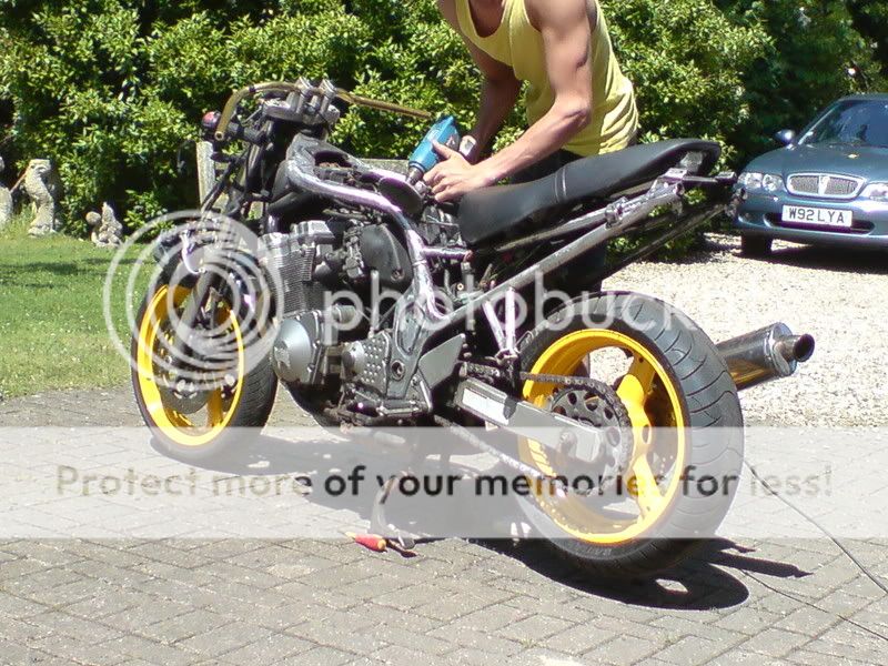

I took them all off so they were hanging loose and got the angle grinder out Very Happy (again, just a silly drill attachment one). I'd never done angle grinding before and it was baking hot outside so i was topless...fooolish Thumbs Down (had the the old goggles on though Very Happy )
Cut off all extraneous metal bits on the frame so it was just a couple of bar metal tubes with joining braces, then ground down the wounds i'd inflicted so they were smooth.
I also started to remove the old paint from the frame and grind off the scuff marks from the crash.

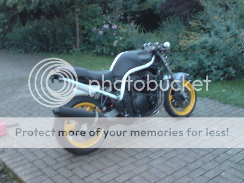

This is the most recent phot I have so I'll make it the last, you'll have to imagine the rest for now (it's pretty much all done in this pic anyway).
https://i6.photobucket.com/albums/y205/mowgli0929/bike%20project/DSC00723.jpg
WELL happy with the look Very Happy

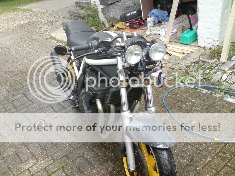

Good work, any chance of some pics from the front?

yeah i'll get some front on pics ones tomorrow before i tackle the carbs and put them up....i'm not a huge fan of bandits from the front lol hence no pics, also havnt got round to painting the mudgaurd.

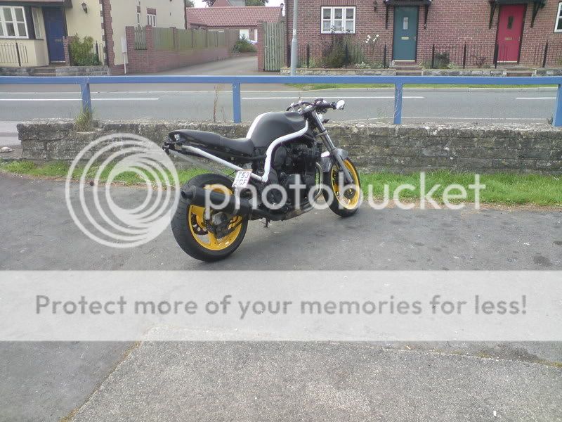

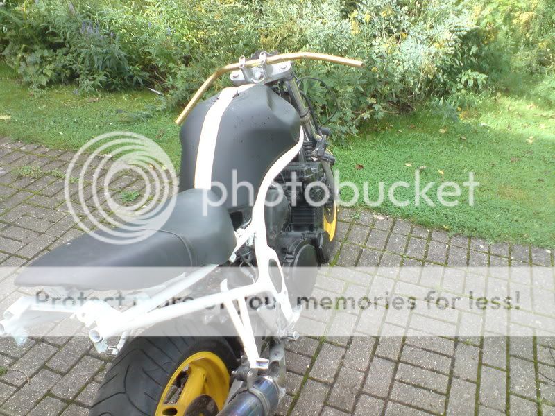

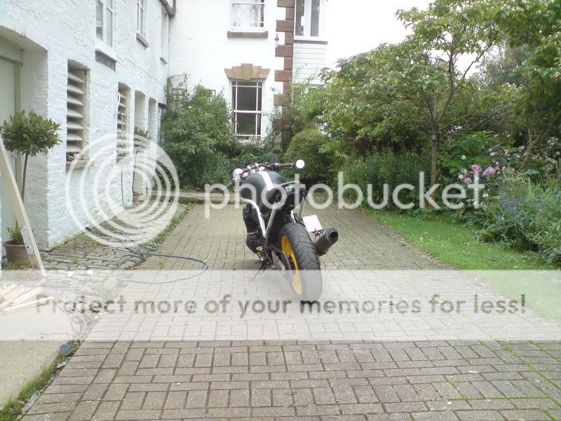

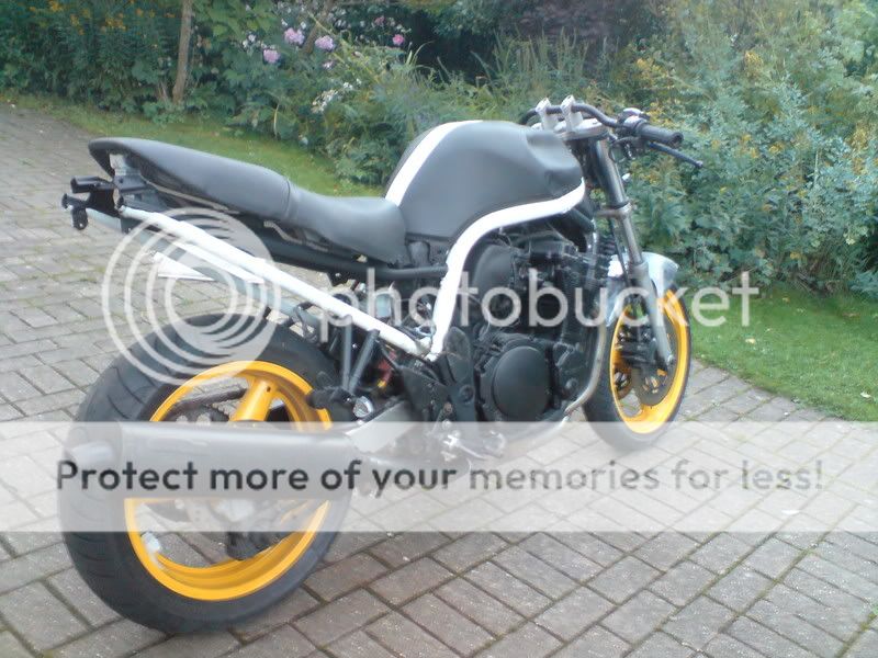

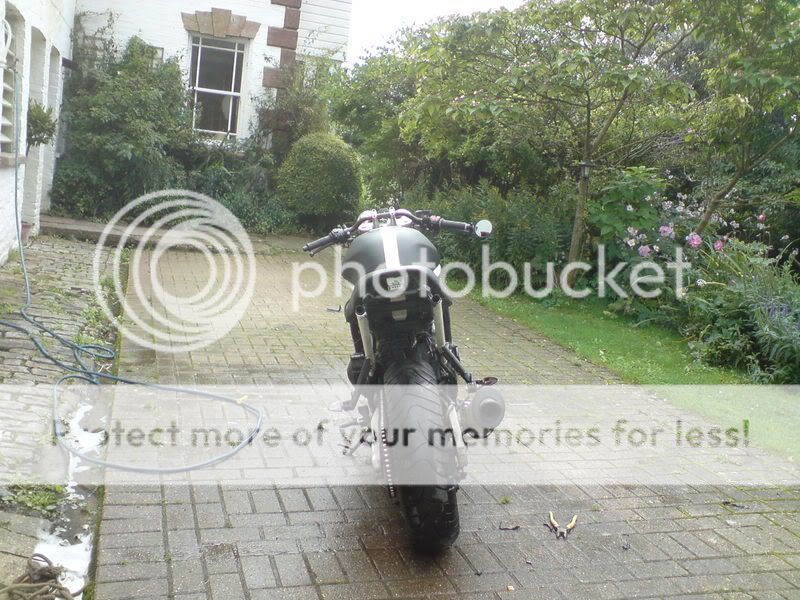

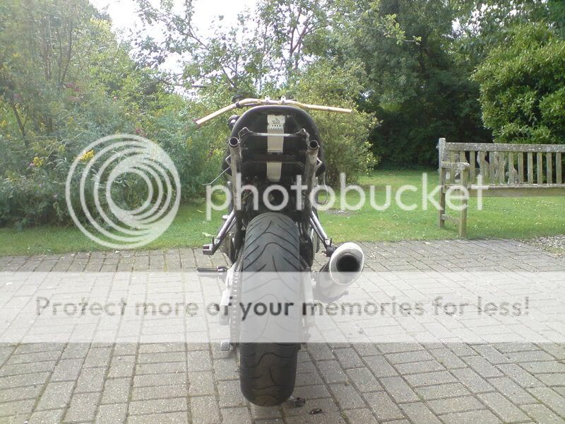

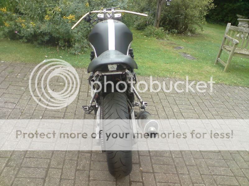

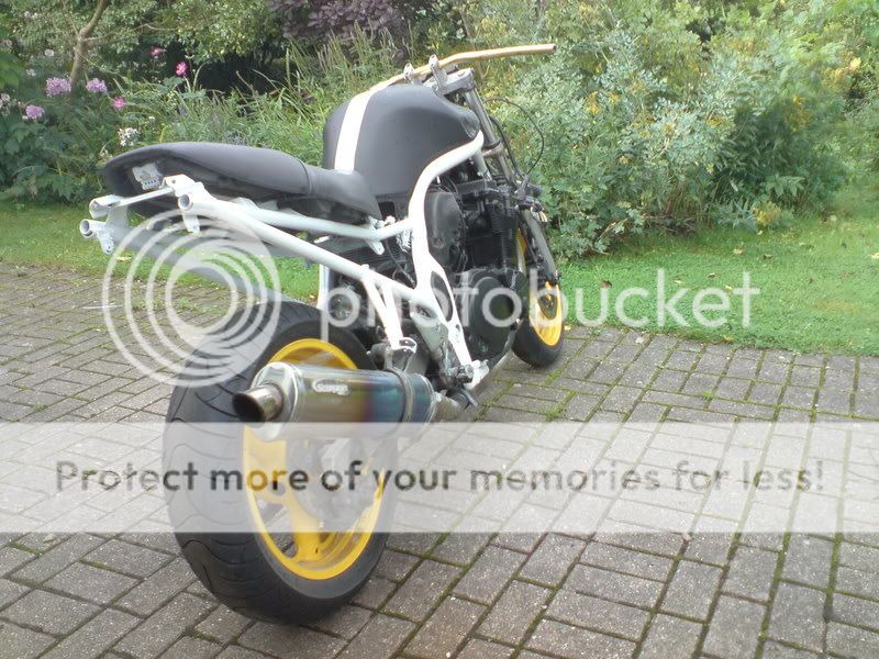

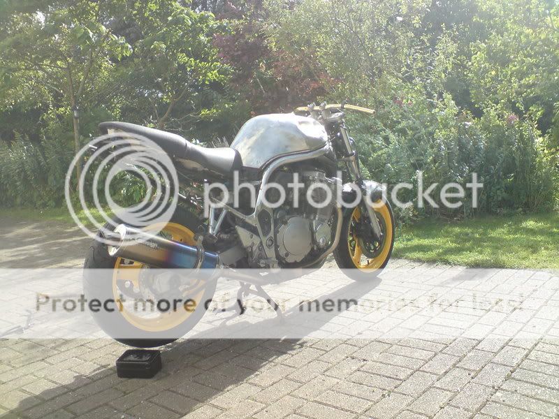

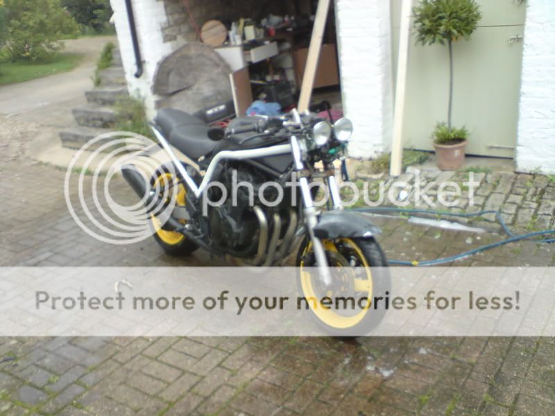

Here's a couple more pics, with some from the front as requested. The primer is as we speak drying on the front mudgaurd, so dont worry it will look better than this. I'm not a HUGE fan of the lights, as soon as budget allows I'll be upgrading to speed triple esque lights (5 3/4 inches), might even use some from an of 2cv as they give the same effect Very Happy

Hmmm....not sure about the exaust myself actually...might strip the black paint off it, we'll see. Anyone else got an opinion on it?

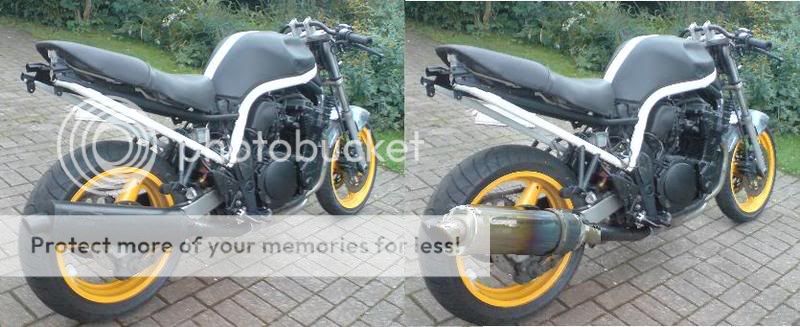

I've done a (SHOCKINGLY bad) photoshop to compare the two: black and original
https://i6.photobucket.com/albums/y205/mowgli0929/bike%20project/compare.jpg
I didn't like the flame blue on it as I felt it added too many colours and detracted from the look of the bike...a plain chrome one MIGHT make it look better...bit less rat bike. Oh well I can always strip the paint. Anyone got an opinion on the comparison pic? Confused
