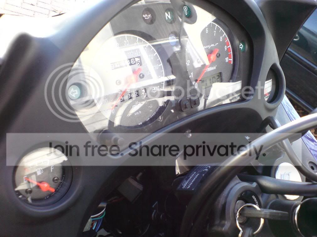

This is how the Transalp dash looked before, stock.
https://i177.photobucket.com/albums/w214/shnesdi/DSC00051.jpg

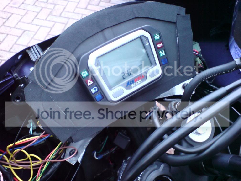

This is it mounted to the old holes on the frame. The neoprene surround is just to prevent vibration, not a thing I thought of, just a thing I realised I needed after a test run. Laughing
https://i177.photobucket.com/albums/w214/shnesdi/DSC00072.jpg

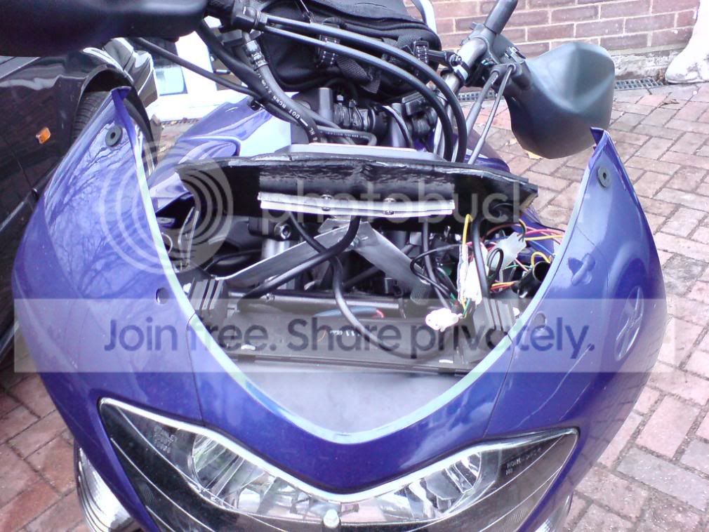

So, the wiring, well, it was surprisingly simple really, the instructions are in English which is a start and if you really get stuck, there is a bloke called Craig who sells these units and he knows his stuff.
https://i177.photobucket.com/albums/w214/shnesdi/DSC00073.jpg

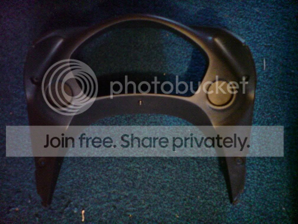

Before the dash surround goes back on, I get a bit more bin and cut a couple of discs to fill in the holes where the temp and fuel gauges where. At some point I may mount speakers in those holes and have a big gay goldwing type stereo thing happening Smile
https://i177.photobucket.com/albums/w214/shnesdi/DSC00070.jpg

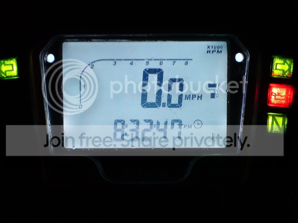

And here's the result Very Happy
https://i177.photobucket.com/albums/w214/shnesdi/DSC00074.jpg
Here's a "mood" shot for ya, couldn't be bothered to wipe it after it rained Wink
https://i177.photobucket.com/albums/w214/shnesdi/DSC00077.jpg
The unit was around 150 quid but it's a great piece of kit, 2 resettable trip meters, volt meter, temp level (in bar and digits), revs in bar and digits (though revs in digits is like watching a lotto machine on speed Confused ) then there's the usual crap like fuel and speed and a clock to tell you how late you are.
All in all, I'm happy I have it, mainly because it's not stock, yet it doesn't look out of place.

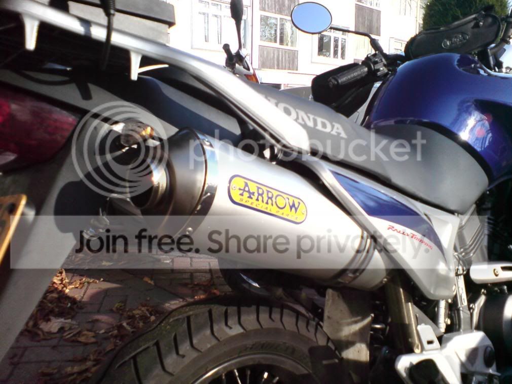

Much like the noisy baffle free Arrow that I got from a written off alp.
https://i177.photobucket.com/albums/w214/shnesdi/DSC00049.jpg

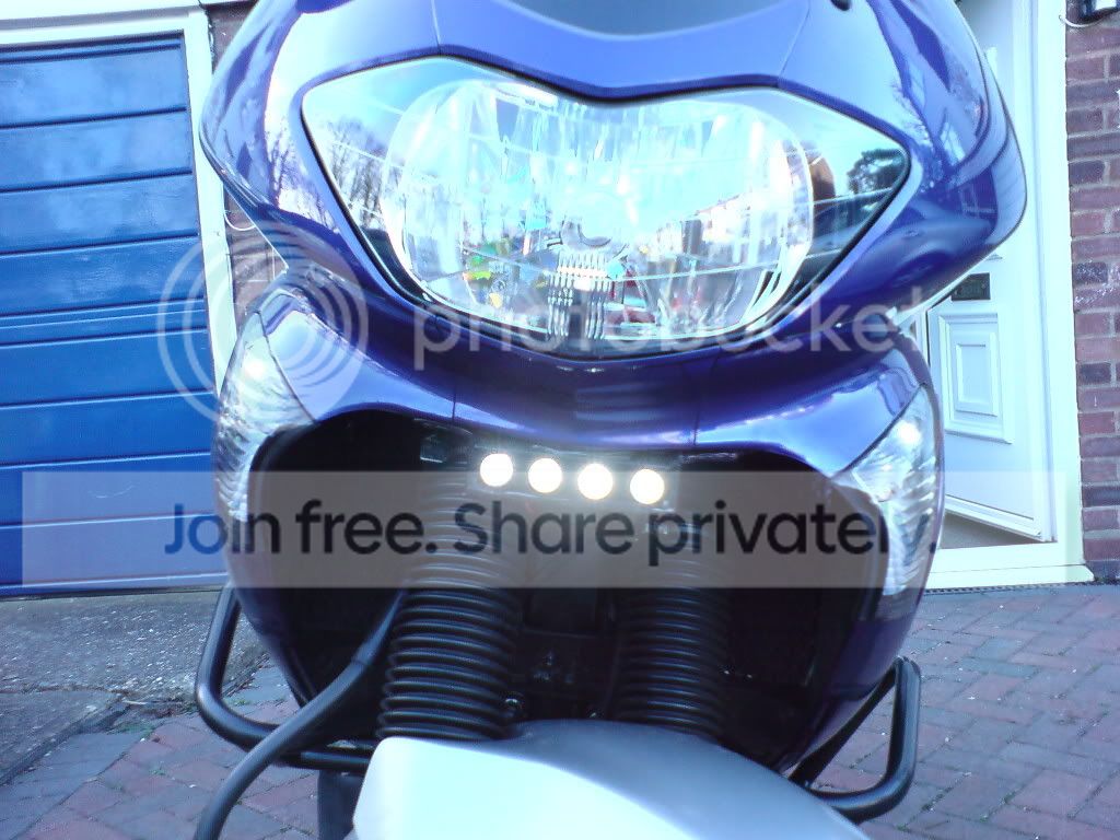

One thing I must show you at some point are my Cree shotguns for daytime visibility, I love them, they are an evolution from these luxeon ones I made a year ago from 4 torch heads and the enclosure from a vhs cassette box.
https://i177.photobucket.com/albums/w214/shnesdi/DSC00139.jpg

How did you wire in the LED shotgun lights? I've got an idea of shoving them behind the ram air grille so i can run without main beam during the day.

The shotguns wired straight from the battery using 2.5mm speaker cable, (went for the 2.5 so I could draw more at a later date if I wanted to).
The feed is interrupted by a relay hidden in the fairing and the trigger for that is from the running/position light.
Good idea about the hiding them in the fairing bit, I don't know the bike but the problems I had were full lock forks hitting the back of the lamps, finding a suitable mount in the bike, I found a screw either side of the nose under the headlamp to which, I attached a hosepipe or jubilee clip with a hole in it, then simply slipped the lights in and tightened the clip.
I can't offer any pics for the shotgun's build but if you need any more info or would like to check them out in person, give me a shout.
