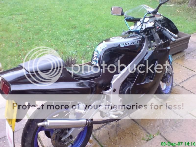

Hi all,
Picked up my first bike at the beginning of December...a Suzuki RG 125
https://i83.photobucket.com/albums/j310/lard44/DSC00159.jpg
I took all the bodywork off (held on with cable ties when I got it!), patched up a few cracks, and am in the process of wet/drying and priming the lot - the nasty glossy stuff had dripped and smeared everywhere!. I also had to sort out the electrics - the previous owner cut off the indicators and horn to pass the MOT I guess.
Tried to start it today (having been idle for a month) and, surprise surprise, it wouldn't. The engine turns over but no go. So I was going to check the spark plugs but...where are they?
It must be reeeeeealllllllly obvious but I dunno where to look...help!
Thanks,
P

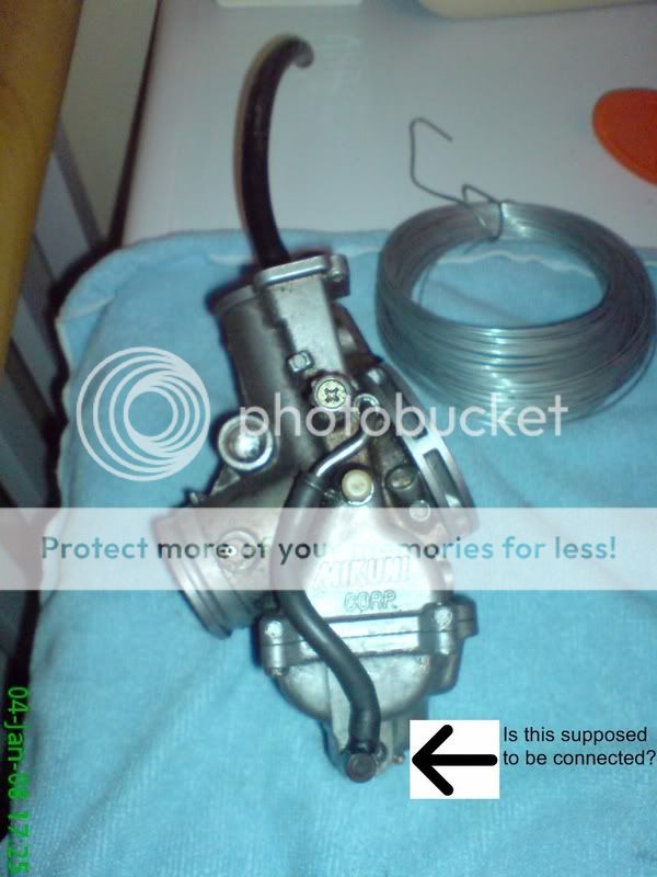

I pulled out the carb and saw a nozzle (not the throttle or the oil - those were connected fine) that didn't seem to be connected to anything - is this right?
https://i83.photobucket.com/albums/j310/lard44/DSC00179-1.jpg
Can't get the thing open as the heads on ALL the bolts has been utterly shagged. I've broken too many drill bits trying to get them out but I'll have another crack in the morning I guess.#
Cheers for all the input so far guys - might still crack this...

By taking out the spark plug and manually putting petrol in it ran! Albeit only for a few seconds as the tank had been disconnected.
Great...now...umm...what does this mean? It doesn't seem like a very time effective way of getting going...

Remove carb, remove float bowl from underneath, if you have a compressor, get up to 80-120psi, and blow the s*** out of it! Point air in all the nooks and crannies, especially the main jet up the middle.
Be careful not to blow away any loose bits!!
Then soak in a pot of carb cleaner, not neccesary but if you have some, may aswell.
Reassemble and connect everything up. Make sure float is the right way up and is loose to move. Replace carb, should be good as new Very Happy
