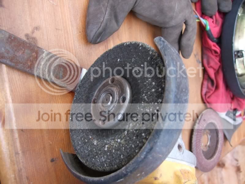

OK step 1: Hold the bar up for a rough measurement, I'm a lazy bastard so I don't waste any pointless effort with a tape measure. Just eye it up about right and lob it off with the grinder.
https://i52.photobucket.com/albums/g9/vincentnotts/Bros/Brack1.jpg
Once it was cut down I scored it with a grinder about where I thought it'd need to be bent.
https://i52.photobucket.com/albums/g9/vincentnotts/Bros/Brack2.jpg

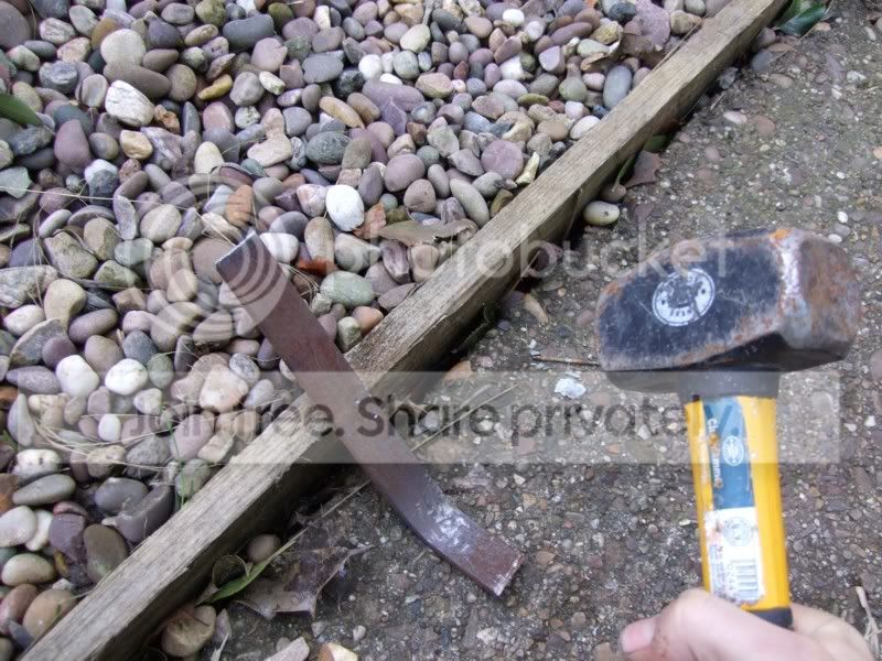

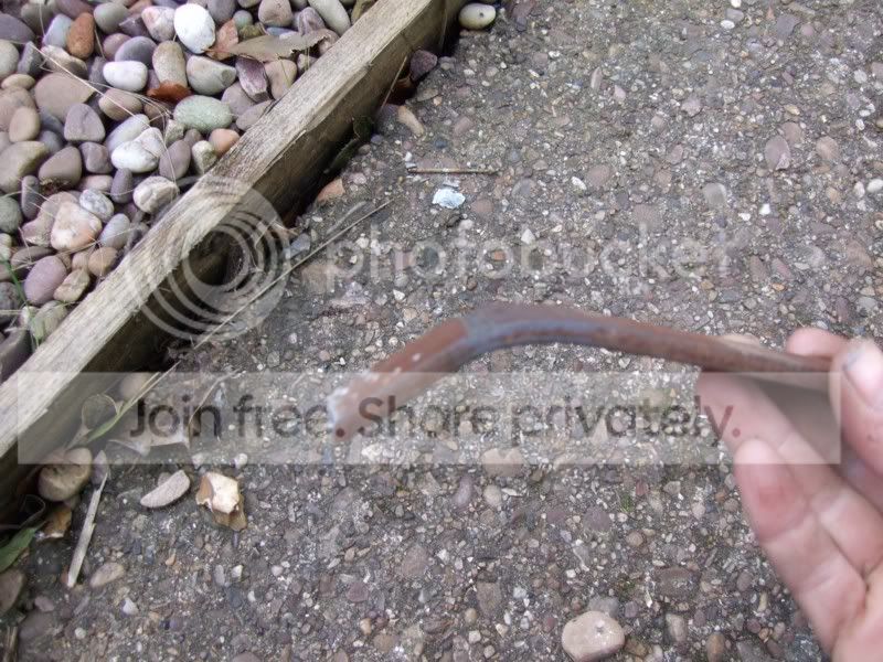

Then chucked it on the floor and battered with a lump hammer it till it was about the right angle. YES I'D HAD A FEW BEERS AND I BENT IT THE WRONG WAY! THE SCORE SHOULD BE ON THE INSIDE BUT IT STILL WORKED SO NEVERMIND Razz
https://i52.photobucket.com/albums/g9/vincentnotts/Bros/Brack3.jpg
Hmmmm that looks somewhere near right.
https://i52.photobucket.com/albums/g9/vincentnotts/Bros/Brack4.jpg

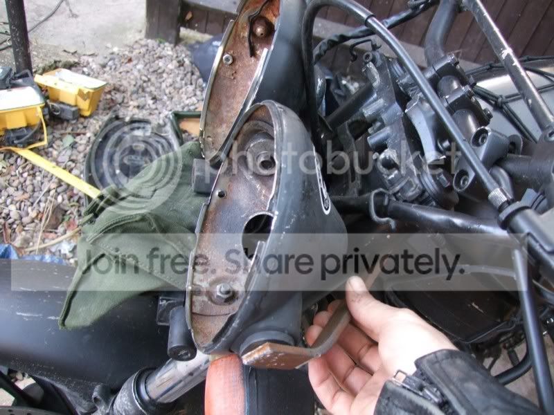

Held it up for another look.
https://i52.photobucket.com/albums/g9/vincentnotts/Bros/Brack5.jpg

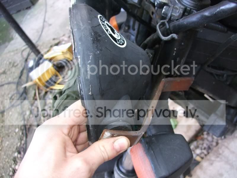

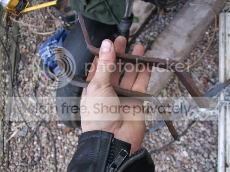

OK looking good, now I just made another one the same, by simply copying the first one, scoring it, then battering it on the floor till it matched.
https://i52.photobucket.com/albums/g9/vincentnotts/Bros/Brack14.jpg

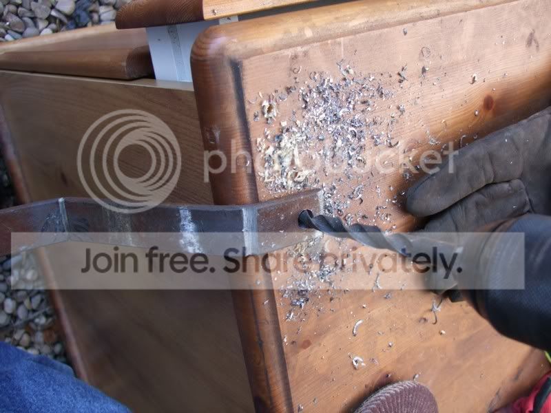

OK time to drill a bolt hole in roughly the right place, so I can mount the brackets onto the lights.....
https://i52.photobucket.com/albums/g9/vincentnotts/Bros/brack8.jpg

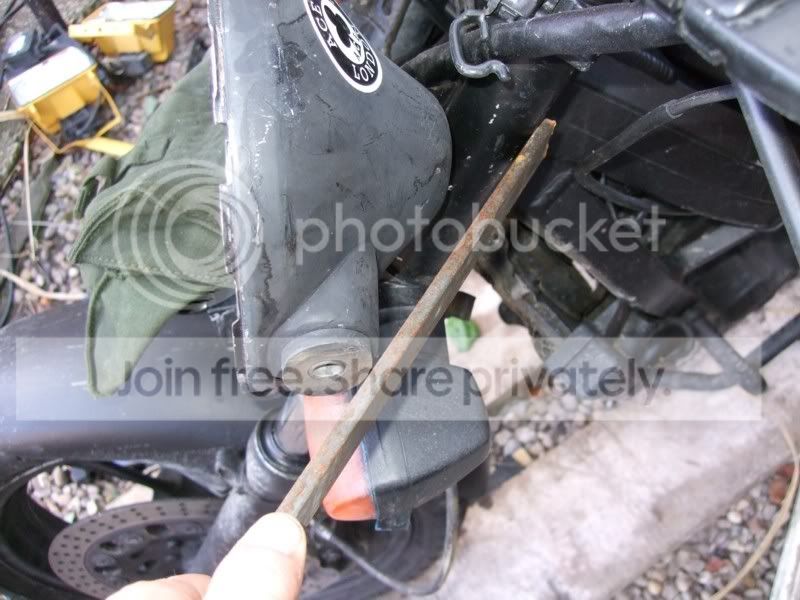

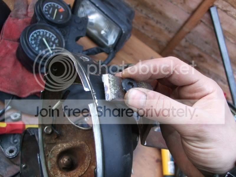

Holes looked ok, so I'm using the original headlight bolts to fix the brackets on.
https://i52.photobucket.com/albums/g9/vincentnotts/Bros/Brack9.jpg

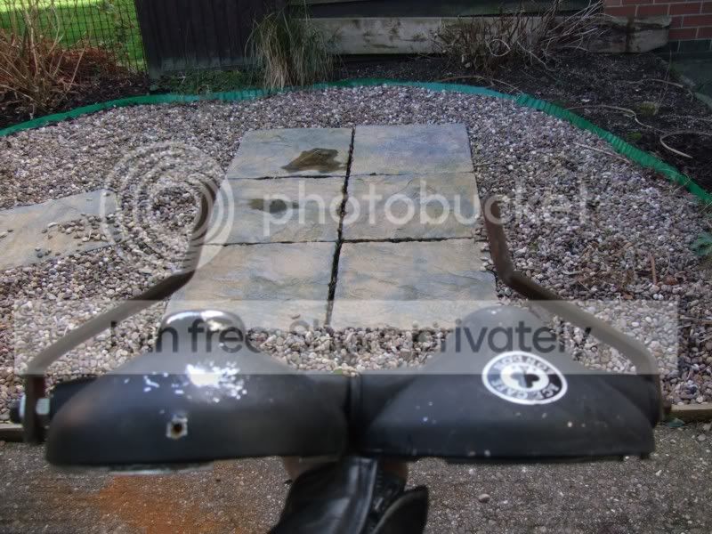

So far so good, both brackets look fairly similarish..
https://i52.photobucket.com/albums/g9/vincentnotts/Bros/brack10.jpg

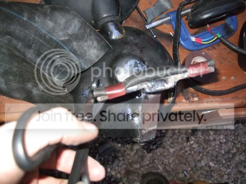

Right so now I cut a couple more bits of flat bar about 4 or 5 inches long, then clamped them to the fork with a G-Clap. Then held the lights in place and tacked them with a quick weld.
https://i52.photobucket.com/albums/g9/vincentnotts/Bros/brack11-1.jpg

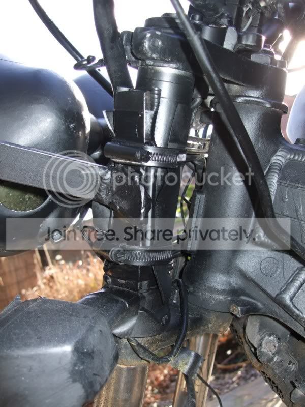

OK so having taken them off the bike and done a decent job of the welds, I was ready to fix them on the bike. I decided it would be a good idea to pad the back of them using some old innertube that was lying around so they had a little movement and would'nt damage the fork leg.
https://i52.photobucket.com/albums/g9/vincentnotts/Bros/brack12.jpg

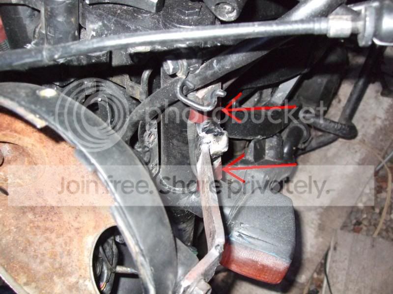

One last quick try before I fit it properly by fitting a jubilee clip at the top and bottom (shown here with arrows.
https://i52.photobucket.com/albums/g9/vincentnotts/Bros/Brack13a.jpg

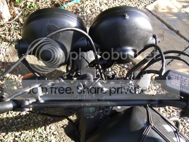

Just a case of a jubilee clip at the top and bottom of each bracket and it's solid as hell.
https://i52.photobucket.com/albums/g9/vincentnotts/Bros/17.jpg
Sorted:
https://i52.photobucket.com/albums/g9/vincentnotts/Bros/18.jpg
https://i52.photobucket.com/albums/g9/vincentnotts/20-1.jpg
https://i52.photobucket.com/albums/g9/vincentnotts/21.jpg

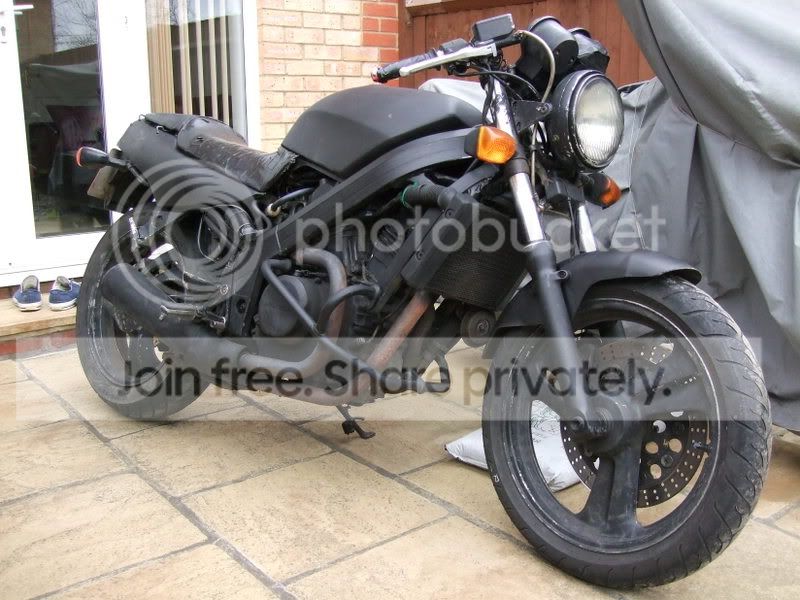

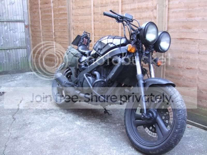

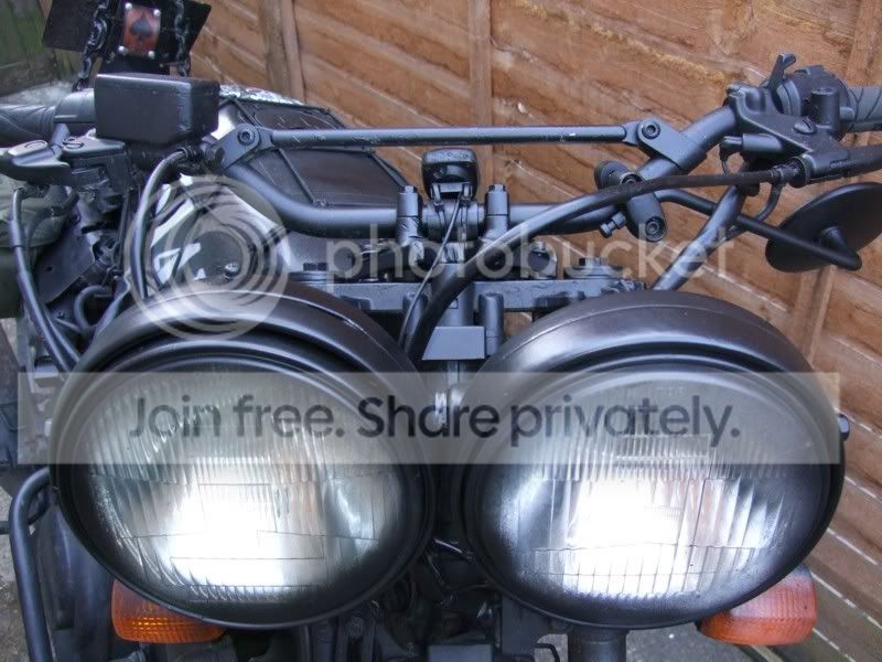

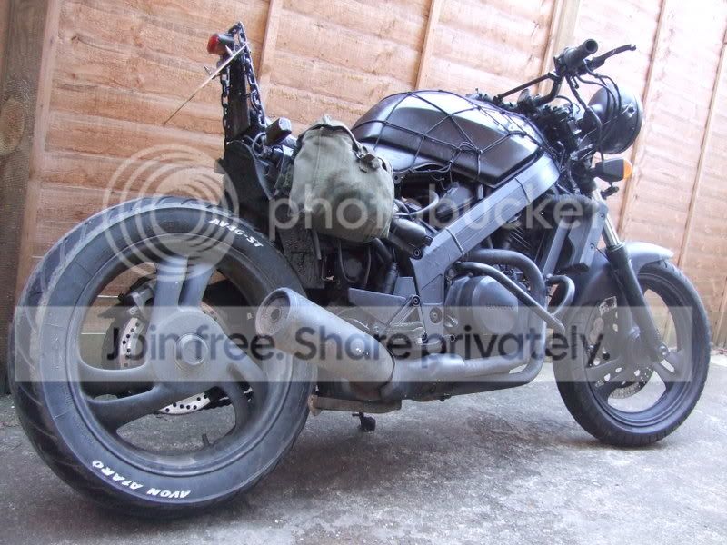

And here's the end result:
BEFORE:
https://i52.photobucket.com/albums/g9/vincentnotts/Bros/DSCF0960.jpg
AFTER:
https://i52.photobucket.com/albums/g9/vincentnotts/Bros/19.jpg
https://i52.photobucket.com/albums/g9/vincentnotts/Bros/DSCF1791.jpg

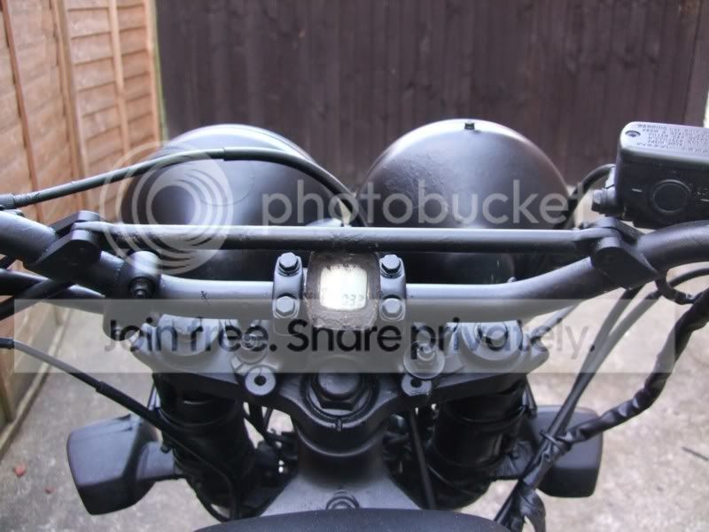

I noticed that you have a bicycle speedo on there, how did you mount the sensor and magnet? I'm thinking just aralditing the magnet to the wheel and cable tie the sensor on?
Joe
(Oh, can you see what the speedo says at night?)

Yeah i just got a flat magnet from a fridge magnet and superglued it to the wheel, right near the axel, and yeah just cable tied the sensor to the fork leg with some packing so it was nearer the magnet.
And no, you can't see it at night except when passing under the odd streetlight now and then, BUT I might just bung a 12v LED on the bar above it, it'll take less than 5mins to do, it'll light it up really well and look nice'n shitty.
Mind you, a last minute change of plan means the old clocks are going back on anyway.
