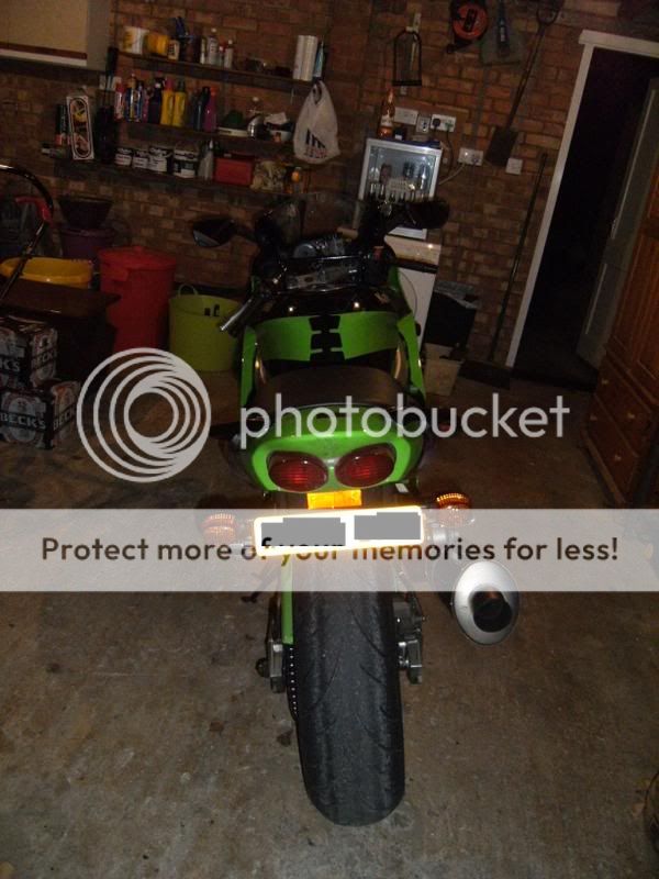

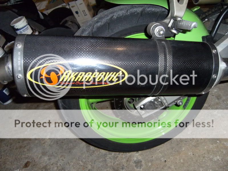

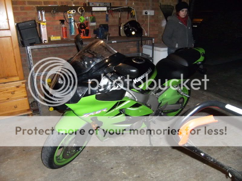

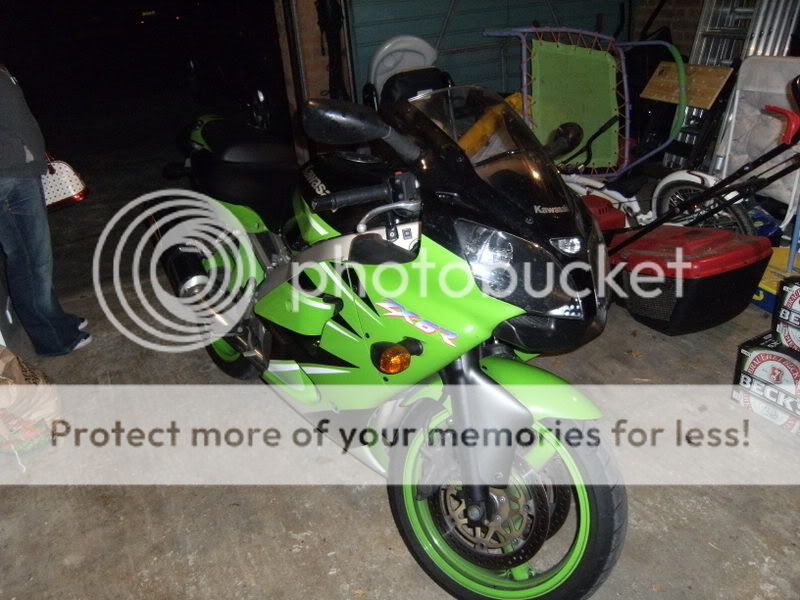

Right, just been to see it, and had a ride, and love it. Just need to be able to sell my car and bike in the next 2 weeks!
The bloke bought it new in April 2000 from a Romford dealer, has had it serviced and stamped every year. Had a big service last may, costing £800. It's only ever been on the floor once, when a van reversed into it, but all the damage was transferred to the indicator, so basically, its spotless! Just needs a bit of a clean!
https://i6.photobucket.com/albums/y209/angelgrinder187/DSCF01331.jpg
https://i6.photobucket.com/albums/y209/angelgrinder187/DSCF0135.jpg
https://i6.photobucket.com/albums/y209/angelgrinder187/DSCF0134.jpg
https://i6.photobucket.com/albums/y209/angelgrinder187/DSCF0136.jpg
alun111
Joined: 31 May 2007
PostPosted: 23:33 - 19 Feb 2008    Post subject: Reply with quote
back tyre looks a bit bald, and just so you're aware - that number plate size is illegal (you may already know this but not give a crap!)
