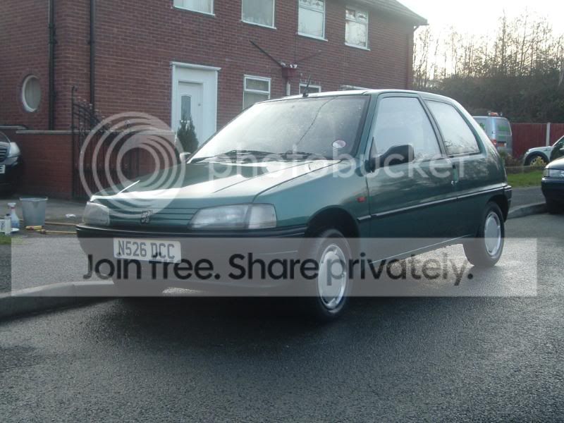

Diesel 106. Mine has had NO electrical problems, NO mechanical breakdowns, and getting on for 169,000 miles from new still does well in excess of 60MPG
Its never cost me more than about £400 to insure and for what it is, performs well.
Ph1 has a service interval of 6k but the Ph2 (i think) has a 10K interval so the amount of times a year depends on the mileage you cover. Servicing costs: Oil and filter can be got for about £11, Driveshafts are about £30+vat each from ECP, Glowplugs are about a fiver each and fuel filter around a tenner. I got a cotton gauze filter for mine as I was doing 25K pa in this until recently, and it saved me a fortune on air filters. If doing a high mileage, I would recommend you do the same. Suspension wise, mine is likely on its original dampers all round and springs at the front. I am also certain it has had not had the rear torsion beam replaced, so that is all original.
I dont see anything wrong with French cars or French engines. If there was, why would BMW be using a petrol engine developed jointly with Peugeot. Why also would Ford be using a Peugeot developed diesel in the 2.4TD transits?
I know more people who have had unreliable Volkswagens than unreliable Peugeots for example, but I dont say "Its German" in anyway other than to indicate its country of Origin.
Give them a go mate. For your budget, they are the best blend of low purchase cost, great economy, low maintenance costs and ease of self-spannering.
https://img.photobucket.com/albums/v26/Phil_G/Peugeot/DSCF2926.jpg
feel free to shout me if you got any questions about long term ownership.
