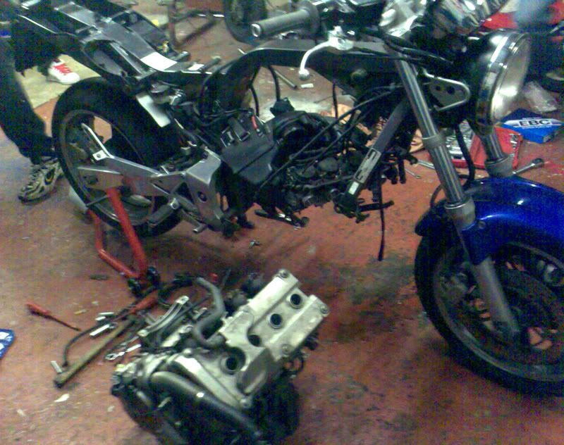

Well this is gona take a few months as im only part time so the money doesn't come easy!
But yeah, i flipped the Hornet 2 or so weeks ago, not too quick but still did what i thought was the engine casing, but it seems ive done the crankcase too, and i already had a missing 2nd gear so i thought its new engine time, so tonight i got it out.
Going to be getting rid of the clocks, headlight, the lot, welding a 12 bar on, engine cage, hopefully painting it candy orange too, it'll take a while but itll be worth it.

I would well consider trying to fix that crankcase. You are going to buy another anyway, so try this:
Take the sump off, flush some oil (or whatever you have to hand really) through it, get any shit or ally splinters out, then see about the hole you made. Get a lump of wood, shape it right, then get some crankweld (like liquid metal but designed for crank casings) and slap it on. it doesn't have to be neat or tidy, it just has to be the right shape to seal to a new engine cover. Then drill a smaller than bolt sized hole into it where the bolt for the engine cover would be, and if you can be bothered tap it n that. Then get some silicone sealant, you know the clear gasket stuff that is very high temperature squeezy gummy stuff, and liberally apply that all round it, stick your new engine casing on, and then squirt the stuff through the hole where the bolt should be. Get a bolt, cut it to size, and put it in, turning it forcefully but gently, so you almost tap it, but just seal it with the sealant. Heat gun dry the whole lot, redo the sump, oil in (cheapest you can get and the most you can get fill it right up, and leave it upright for a day or two. If it hasn't leaked by this point put it back in and fire it up, see if it leaks. If it has I've saved you ~£300, if not then you lost £30 seeing if it is salvagable.
Obviously I can't see the extent of the damage but I assume its only where one of the bolts has sheared off a lump of the casing? thats a common thing on the bandit/hornet/fazer shaped engines n that.
