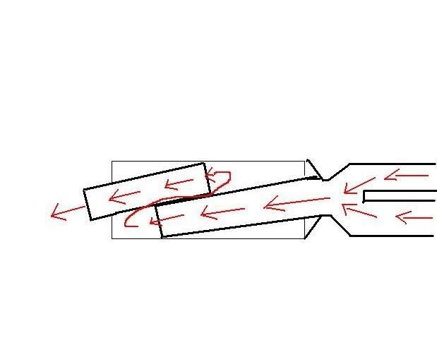

I'm afraid I couldn't be arsed to do a "How-To" like on my other stuff but Basically all it is is a simple Z-flow design like the cut-away diagram below, it involves one large outer pipe and two long thinner ones that go inside, which makes the gas flow in a sort of Z-shape (shown by the red arrows)
https://i245.photobucket.com/albums/gg50/RatBikerNotts/CutawayExhaust.jpg

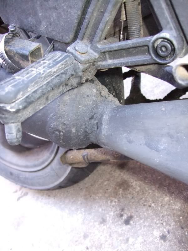

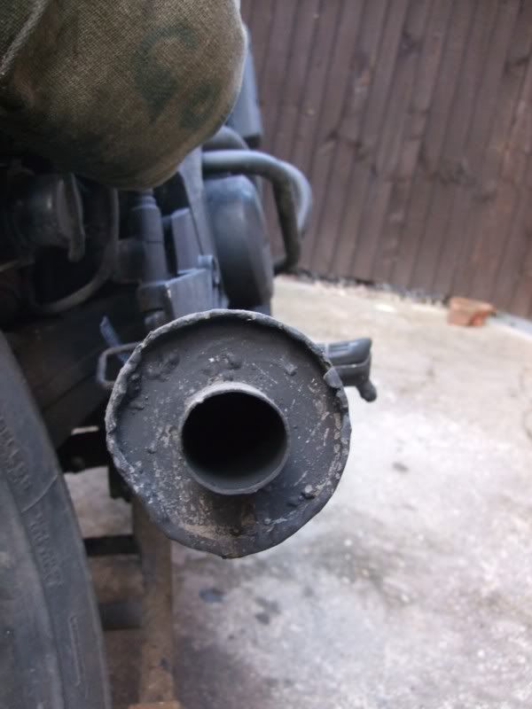

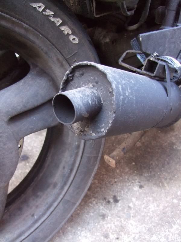

Having found out that my riding mate is also currently making an exhaust for his bike I decided not to smooth off any of the welds, after all I suspect his exhaust will look pretty rough and I don't want to be outdone on the overall shitness.
https://i245.photobucket.com/albums/gg50/RatBikerNotts/DSCF2169.jpg
https://i245.photobucket.com/albums/gg50/RatBikerNotts/DSCF2175.jpg
https://i245.photobucket.com/albums/gg50/RatBikerNotts/DSCF2173.jpg
https://i245.photobucket.com/albums/gg50/RatBikerNotts/DSCF2177.jpg

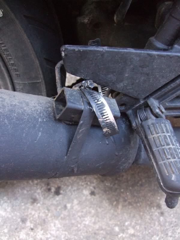

After making the exhaust I couldn't be arsed to make a bracket, so I fixed it to the thing under the footrest with a huge circlip, it was a bit big so I had to bung in a bit of 1" box section to take up the slack.
https://i245.photobucket.com/albums/gg50/RatBikerNotts/DSCF2172.jpg

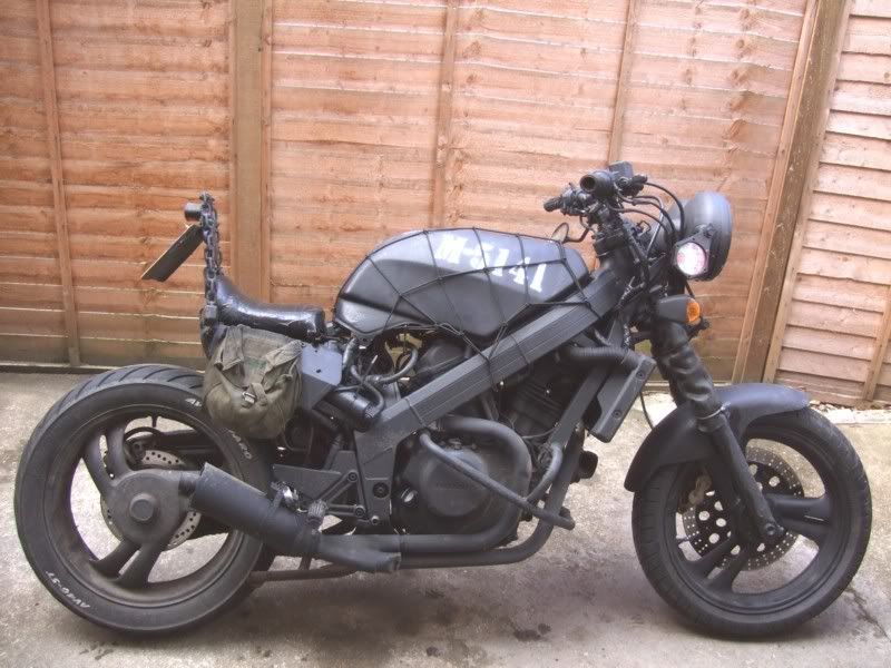

Looks pretty damn good indeed, suits the bike really well:
https://i245.photobucket.com/albums/gg50/RatBikerNotts/DSCF2187.jpg
