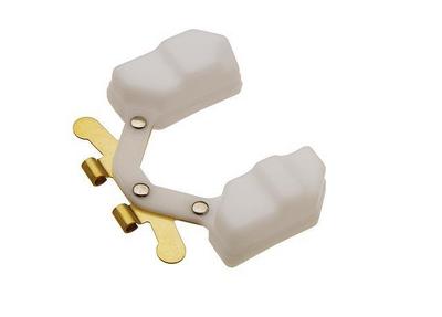

Joined: 07 Jun 2007
PostPosted: 22:26 - 20 Mar 2008    Post subject: Reply with quote
A carb float looks similar to this.
https://www.autopartsfair.com/images/products/engineparts/s106042091oea.jpg
tutton
Joined: 04 Jan 2008
PostPosted: 22:29 - 20 Mar 2008    Post subject: Reply with quote
Ye mines like a circle shape
what am i sposed to do with it
i just pushed it back down where it looked to be when i took the bottom case off?
edit
https://www.lunabase.co.uk/parts_services/jem_part_226.jpg
