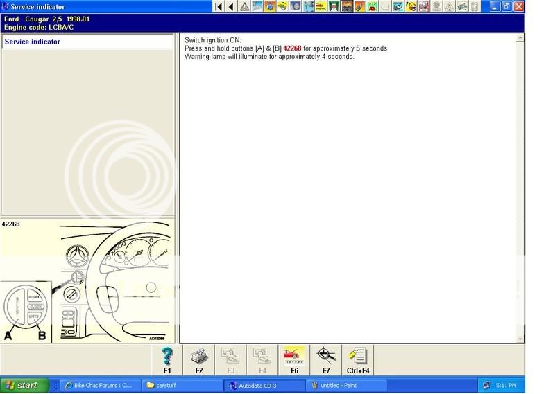

The cougar should be on 10k intervals. The 80k service is oil and filter plus pollen filter. The 90k is all that plus air filter. Its due spark plugs every 60k. Its due a brake fluid change every 24 months regardless of the mileage.
Heres how to reset the light.
https://img.photobucket.com/albums/v678/blazebrown/csir.jpg
