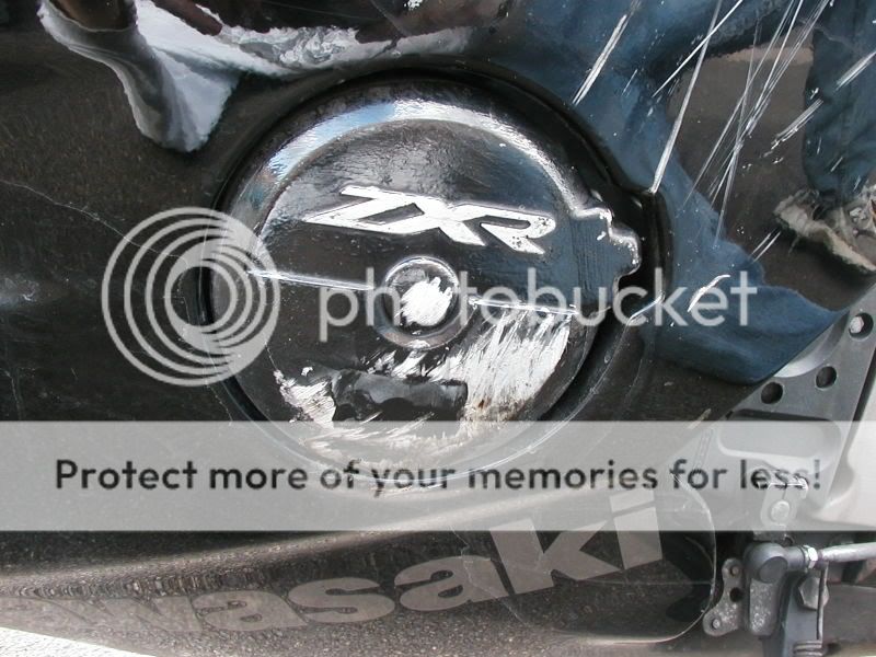

Bike got away fairly lightly with scratched but not cracked fairings, snapped clutch lever, and its leaking oil Sad

Bugger kawasaki curse eh. Any of your casings cracked if its leaking oil?

Titz: I'm guessing thats the case, its leaking from the er, lumpy black bit that sticks out the left hand side fairing Razz
Clutch cover? I'd say drain oil off, take off sump. Have a little looky for shards of metal.

Left hand side i think is the generator cover. Please don't say that you RODE your bike after that! Or even attempted to start it up? Shocked . There's plenty of ZXR400 engines being sold for spares so a cover should be about 20-40 quid for second hand one.
You'd need a gasket as well. That's what ended up going on mine - they're as thin as crackers! Vee also cracked his cover when he had a 10mph spill.
Either way, get a set and do a binge and spray them. If at all possible, find some carbon covers for the engine covers because it'll abrade THAT instead of the metal.

Sounds like you have the similar sort of damage like on mine. Gasket - buy them from cradley kawasaki - covers, get them off a breaker - try bernies bikes, he's hampshire based and i'd recommend him. Clutch lever should be fine to replace but may need 2 people - one of you needs to compress the spring/lever at the clutch basket end so that the cable is loose enough to slot into the lever.
Once you remove the generator cover, you'll be able to see if there's any metal - chances are it'll be clean. Most of the debris will be on the road.

youcan buy a nice shiney generator cover brand new from kawasaki for 75 notes thats what i got, better than a second hand scratched one!
