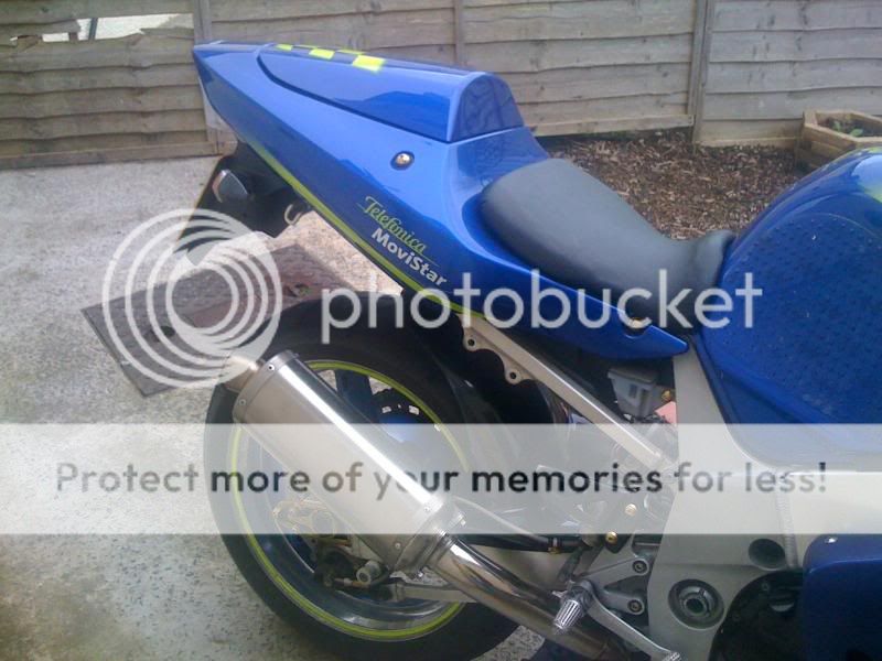

Well yesterday i decided to lose a bit of weight off the back end,well to be exact chop my 5ft akropovic down to size Wink .
Photo of before.....

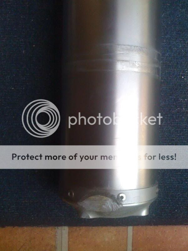

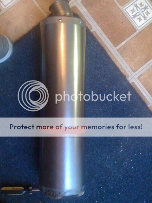

This is the can removed from the bike and notice the "slight rash" from the end...... I should have bought that R+G can protecter before my track day.... Crying or Very sad

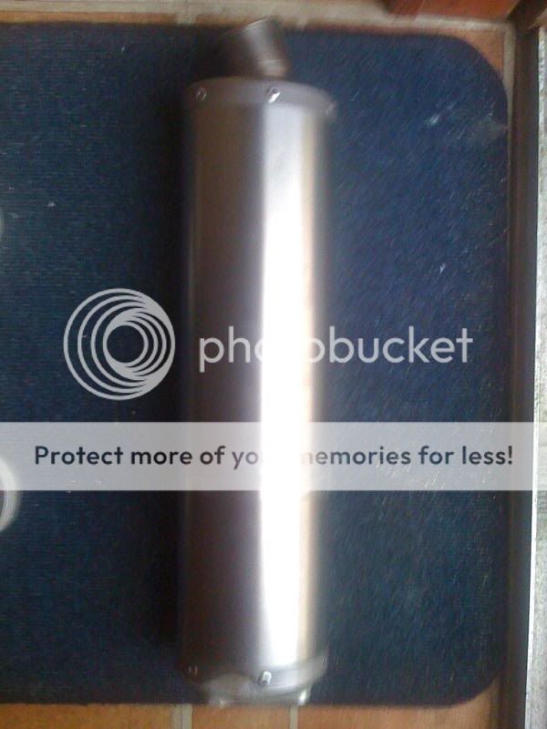

So the idea was to cut it down to where the marks are from the hanger as a guide and turn the end joint and strap around so its on the inside of the bike.....

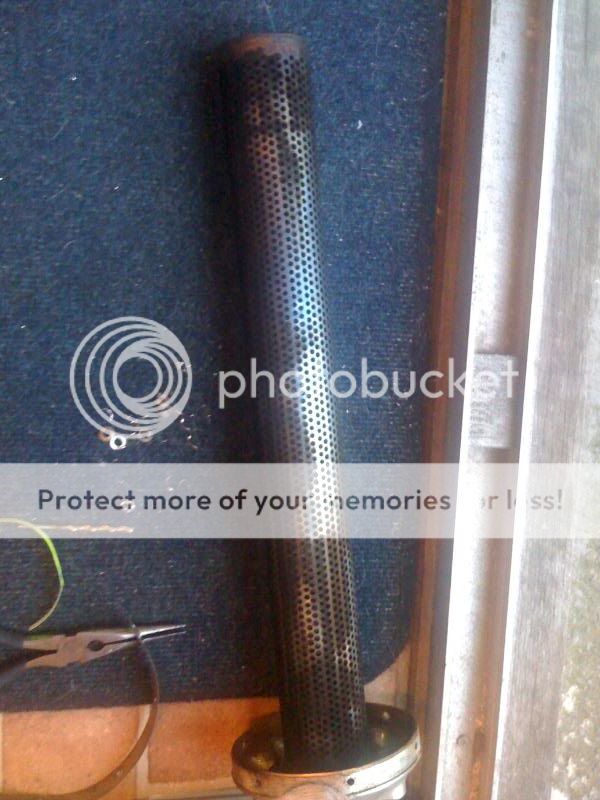

After much drilling with my shakey drill...
https://i127.photobucket.com/albums/p138/lilldic_mossy/weight%20loss/stuff060.jpg
Out pops the inners....

Sorry theres no photos of me cutting the can with the old angle grinder and cutting the baffle material..... I had loads of metal splinters in my hands and i was itching from all the packing crap ! Laughing

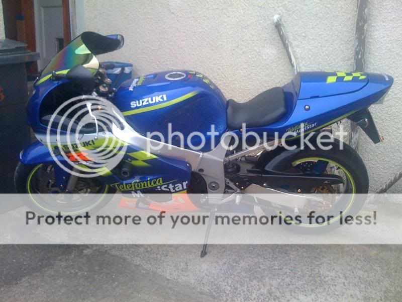

After cutting it all down to size and re-riveting back together this morning, i chucked the can back on.
https://i127.photobucket.com/albums/p138/lilldic_mossy/weight%20loss/stuff066.jpg
Its alot louder Twisted Evil and fits better with the bike now imo,plus i've still got the removable baffle should i get stopped.

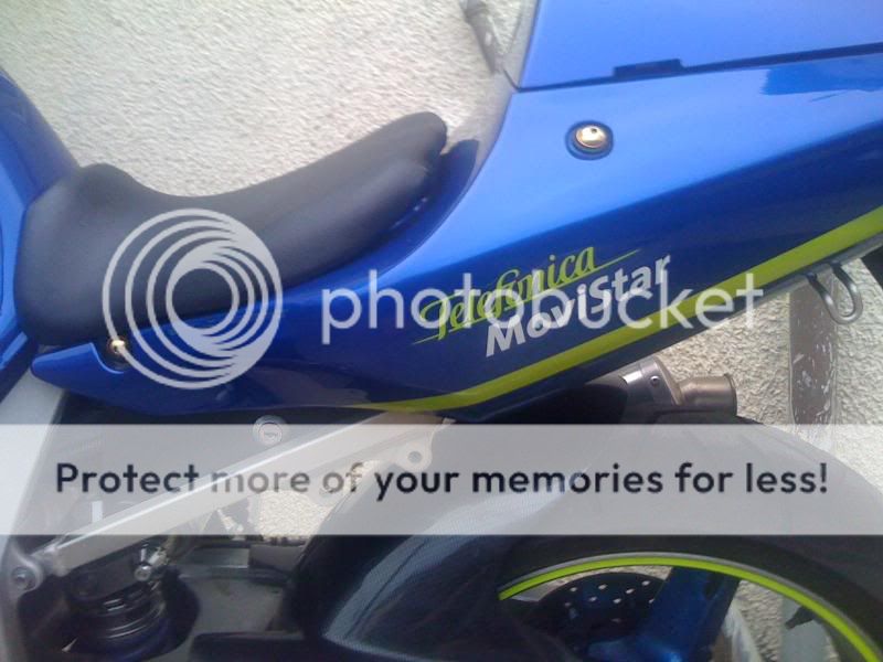

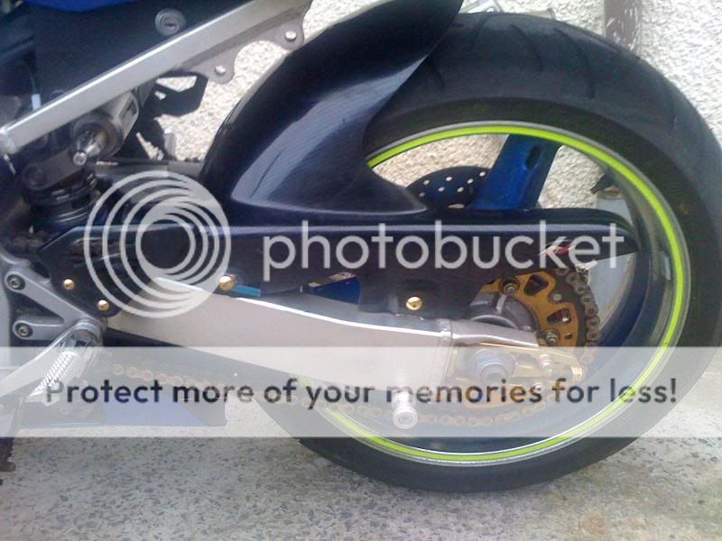

Also i decided to remove the pegs on both sides as i dont think a hanger would be needed.... (or do you think i should get a hanger for it ?)
https://i127.photobucket.com/albums/p138/lilldic_mossy/weight%20loss/stuff017.jpg
https://i127.photobucket.com/albums/p138/lilldic_mossy/weight%20loss/stuff025.jpg

Awesome job on cutting the can down,
wouldnt even know ud done it that good a job Thumbs Up

Looks cracking mate, but I would stick some kinda strap on it to support the weight and keep it still otherwise it may cause the pipe to work loose on the joint to the downpipes.
Tristan the wrote: just whipped off my trousers to find a big bruise on my arse, caused by matt rear ending me...
PostPosted: 23:48 - 04 May 2008    Post subject: Reply with quote
Definately get something that will hold it up.
Even in Moto GP, with their ultra light cans, they have hangers.
If you leave it without one it will put more stress on the exhaust system.
big2dave
Joined: 20 Jun 2004
PostPosted: 00:36 - 05 May 2008    Post subject: Reply with quote
your good but it looks weird with out a hanger

The exhaust suits the bike much better now Thumbs Up
