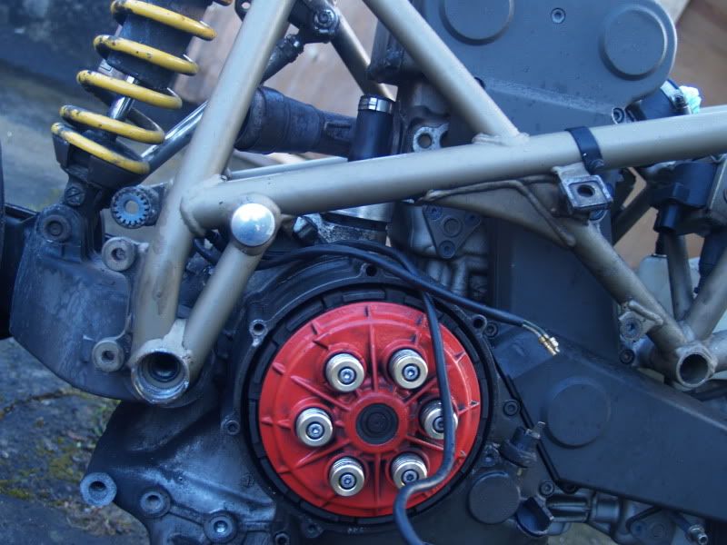

Due to me using the bike in all weathers since getting it almost 2 years ago (i think), it's been looking a bit worse for wear..
..Rusting on the rear frame,wiring falling to bits along with the connectors and the majority of all the nuts and bolts corroded...
So the plan is to strip down, clean up,polish up what i can and re-spray the frame and fairings a completely different colour.
All the wiring will be cleaned,re-wrapped and new connectors where needed... (yay for dodgy Italian electrics)
New belts will be fitted while the engine is out and a check over of the various bits and bobs...

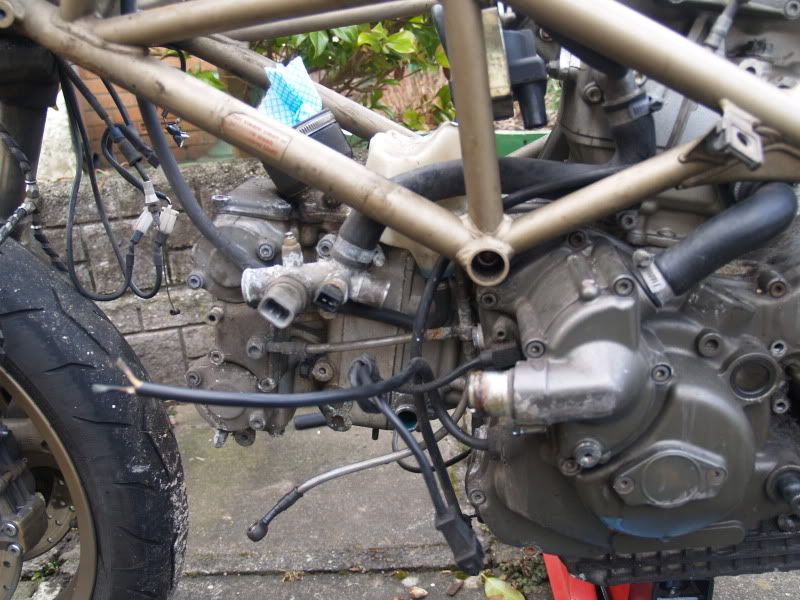

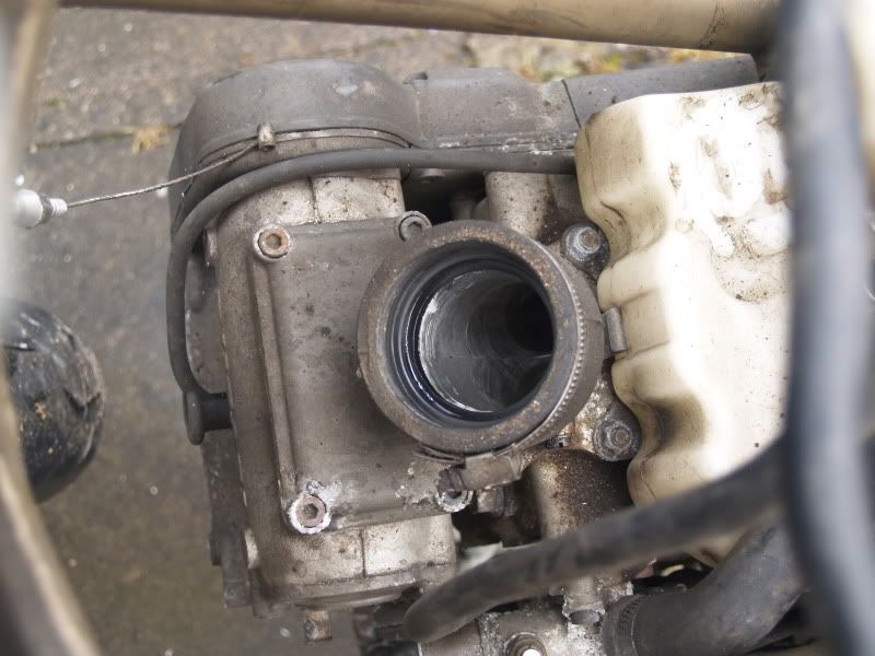

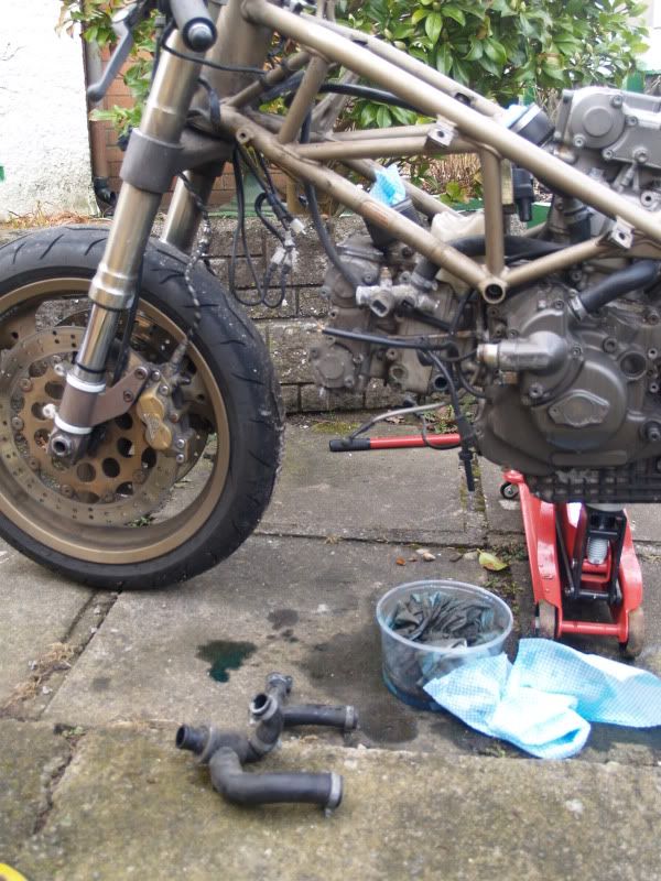

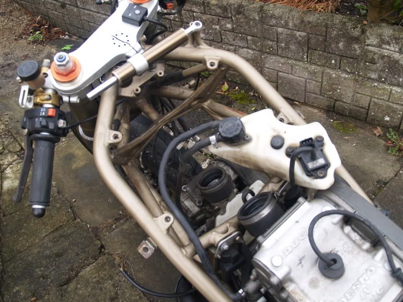

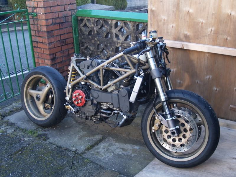

No posts of the stripping all of it down as i just hammered out as much i could today...
Stripped out all of the front and back looms, radiator,chain,subframe,front end etc...
Drained the oil and water....

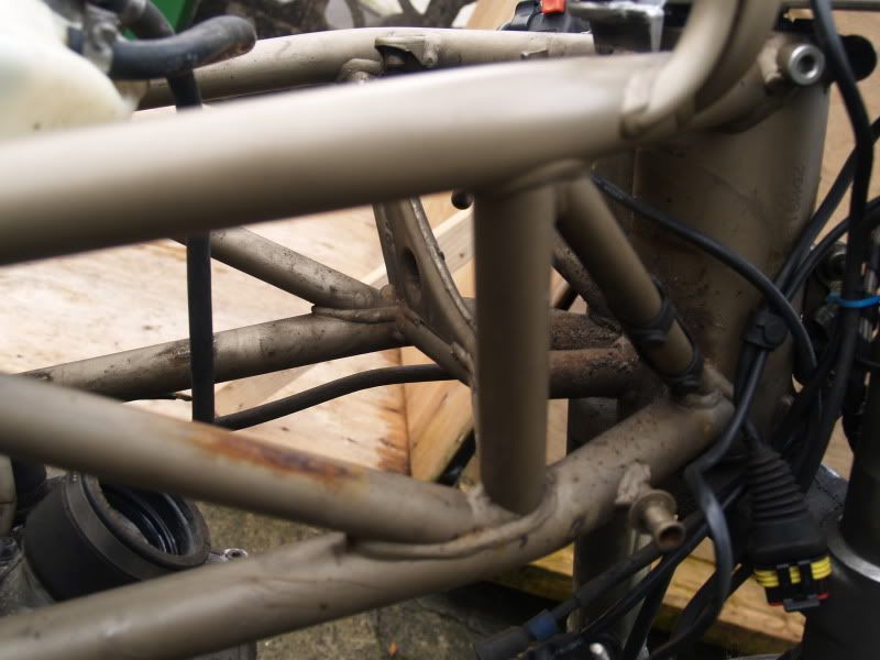

Noticed a few bits of metal shavings on the sump plug, so thats another thing to have a look at....

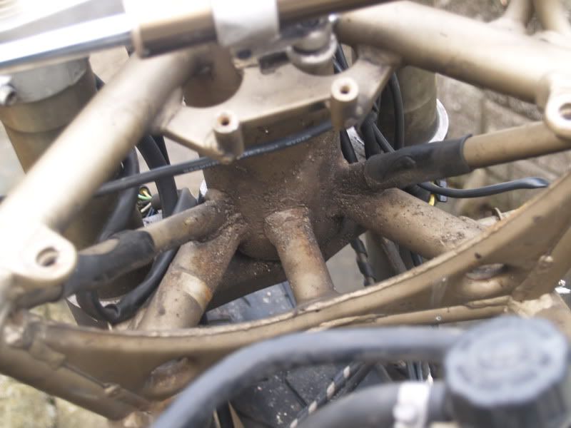

Most of the wiring has rubbed like fuck on the frame causing a bit of rusting Sad
Heres a pic of todays efforts... (i will be taking a lot more pictures now, esp of the rebuild and engine out.... and belt changes)

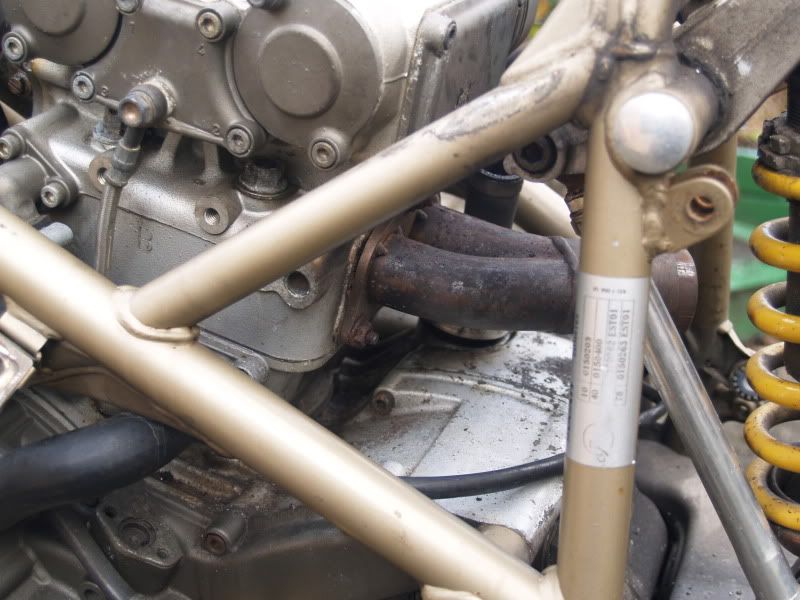

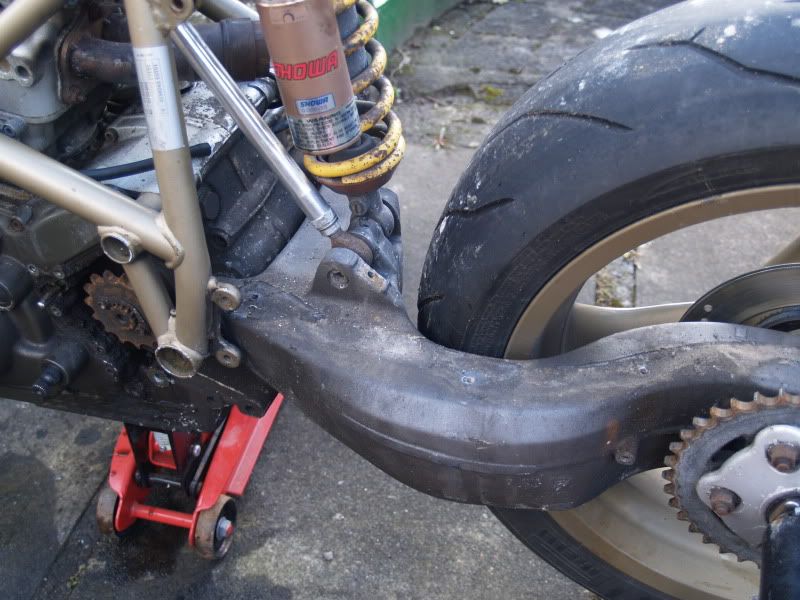

okie dokie... That swingarm bolt which goes through the frame,swingarm and the engine is a right cnut !
Had help from my wonderful assistant today mr sickpup, who even with his "hammer the fuck out of it" skills couldnt free it...
So all i could manage today was strip more little bits off, random "this looks shit" photos and get the pupski to have a look at the engine to see what needs doing to it.
Belts deffo need changing, was going to do them anyway when the engine was out...
pup noticed some bearing problems with the belt adjuster (think that was the one), so needs new bearings...
Also topic of todays chats were.... powder coat or not to powder coat ? Ducati sprayed the original bronze colour, but i think the later ducatis are powder coated...
Due to money and generally more potch, i think spraying will be the way to go to keep costs down... (not black rattle tin job or tin of hammerite Wink )
Also pup keeps putting ideas in my head of the 955 piston kit... next year Wink
Pics to follow of the oily bits..

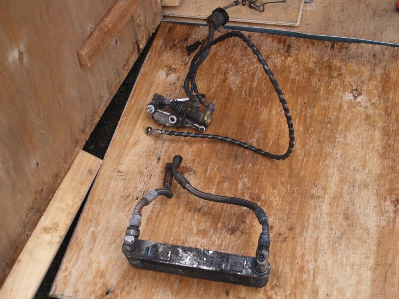

Coolant out...
https://i127.photobucket.com/albums/p138/lilldic_mossy/a%20ducati%20rebuild/P2195624.jpg
urgh..
https://i127.photobucket.com/albums/p138/lilldic_mossy/a%20ducati%20rebuild/P2195625.jpg
Going to have to heat these up to try and get them off... if not they will be left and polished on the engine Smile
https://i127.photobucket.com/albums/p138/lilldic_mossy/a%20ducati%20rebuild/P2195626.jpg
rusty...
https://i127.photobucket.com/albums/p138/lilldic_mossy/a%20ducati%20rebuild/P2195628.jpg
Pupski said this looks very good for a 48k duke....
https://i127.photobucket.com/albums/p138/lilldic_mossy/a%20ducati%20rebuild/P2195629.jpg
https://i127.photobucket.com/albums/p138/lilldic_mossy/a%20ducati%20rebuild/P2195630.jpg
New seals needed...
https://i127.photobucket.com/albums/p138/lilldic_mossy/a%20ducati%20rebuild/P2195631.jpg

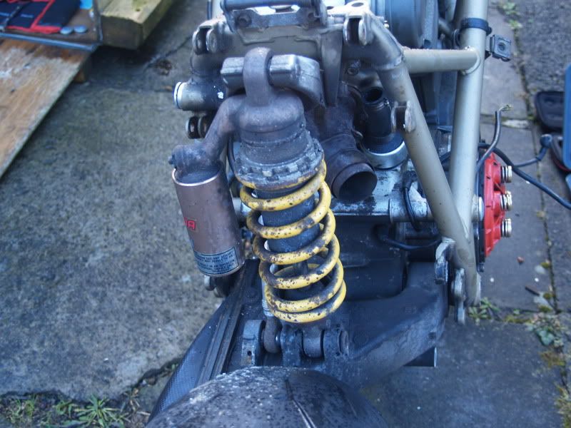

This was a new (second hand) shock on there to replace a busted one back last year.... needs a bit of referb !
https://i127.photobucket.com/albums/p138/lilldic_mossy/a%20ducati%20rebuild/P2195633.jpg
The Engine is held in place with three bolts, one being through the swingarm.So if you ever want to remove the swing arm, the engine has to come out or be swung forward....
This is the pita bolt in question which is stuck..
https://i127.photobucket.com/albums/p138/lilldic_mossy/a%20ducati%20rebuild/P2195634.jpg
https://i127.photobucket.com/albums/p138/lilldic_mossy/a%20ducati%20rebuild/P2195644.jpg
Nice bit of crap build up Sad
https://i127.photobucket.com/albums/p138/lilldic_mossy/a%20ducati%20rebuild/P2195646.jpg
https://i127.photobucket.com/albums/p138/lilldic_mossy/a%20ducati%20rebuild/P2195651.jpg
https://i127.photobucket.com/albums/p138/lilldic_mossy/a%20ducati%20rebuild/P2195650.jpg
So..New bits and bobs needed to wack the feck out of the swingarm bolt needed.....

lilldic_mossy wrote:
I cant justify spending £4k on a bike only to use it when its sunny...
Still having shit getting that bolt out... it has moved slightly, but its free to rotate but seems to bind on the bushes for the swing arm...
More brute force needed, but time i get home in the night its too dark to see out side...stroll on saturday morning Thumbs Up
Try release oil, helped me get a properly stuck exhaust stud out
