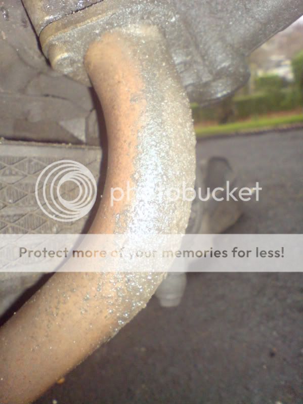

Well, i am one of these folk on here who like to have shiny downpipes,
so i was disappointed that during winter i had let mine get like this
https://i10.photobucket.com/albums/a105/rawkguitarist/DSC00214.jpg

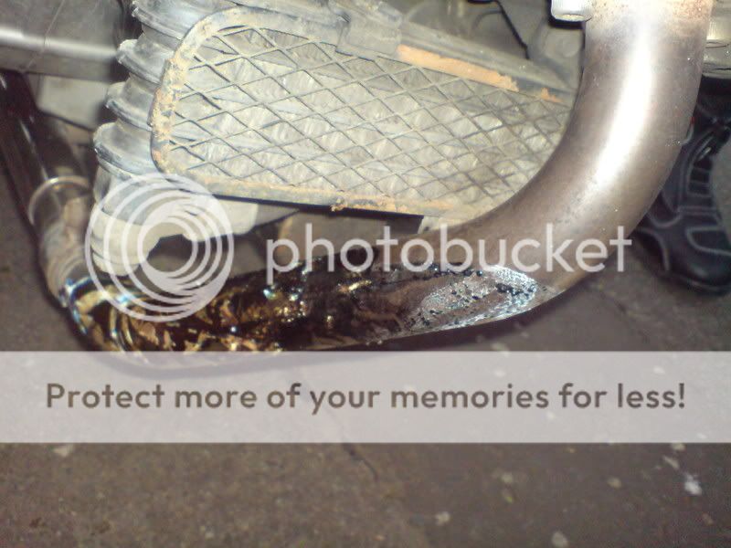

so about an hour with autosol and elbow work i got it back to this
https://i10.photobucket.com/albums/a105/rawkguitarist/DSC00220.jpg

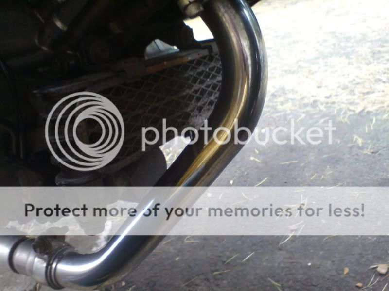

this was all around a few months ago, and i was keeping ontop of keeping them shiny... until 2day.
was taking the missus back to her and noticed a plastic bag flying its way towards me!
"shit what do i do" i thought??
if i didn't have the missus on the back a quick swerve would have worked.
but as she was on the back i thot, "i'll just ride over it"
so it goes under front wheel, and then i can't see it in my mirrors.
then i think it just went to the side and dissapeared to the land of bags.
couple of minutes later,
"hmm what is that toxic smell"
*looks down the front left side of the bike*
"hmm must be nothing"
*looks down front right*
"ohh ffs (well the full words not the shortened version)"
i saw this
https://i10.photobucket.com/albums/a105/rawkguitarist/DSC00301.jpg

So THAT'S what the black stuff I was scraping off my downpipe a couple of months ago was!!!! I always wondered... thanks! Very Happy
Fnatic
Joined: 11 May 2008
PostPosted: 05:58 - 20 May 2008    Post subject: Reply with quote
Same thing happened to my Ped. Bloody annoying... Smelt like shit. I actually think it makes you high. Beh, I still havn't got mine off... I think I need to sand it.
Rawker
Joined: 22 Sep 2006
PostPosted: 09:06 - 20 May 2008    Post subject: Reply with quote
a bit of wirewool will do the job

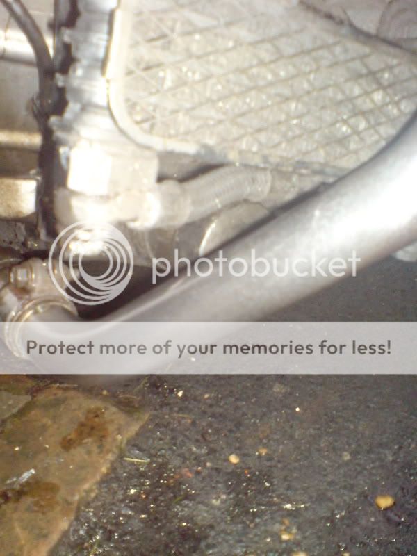

well i spent a wee while on it 2day and got it cleared!
first problem was it was stuck solid on and it wouldnt budge, so intelligence kicked in "why not start the bike so it heats the plastic to melt again"
so did that along with wire wool, autosol and a cloth.
before
https://i10.photobucket.com/albums/a105/rawkguitarist/DSC00303.jpg

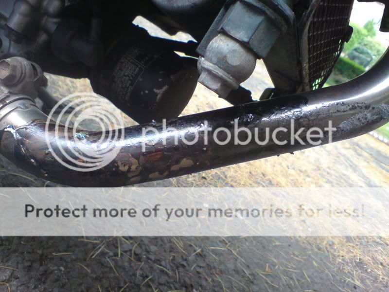

After
https://i10.photobucket.com/albums/a105/rawkguitarist/DSC00304.jpg
nice and shiney Cool
