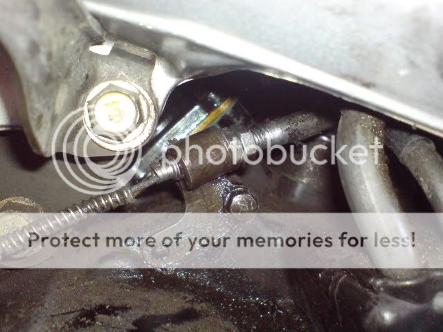

I've taken a piture mate, is that what i want to adjust?
https://i122.photobucket.com/albums/o276/Clone12332/DSC00007.jpg
I can't seem to budge them as they are very aquard to get at - i've also sprayed with WD40. And it looks like they are already screwd in as you adviced me to do?

In that photo you need to unscrew the thing, i.e turn it anti-clockwise. And no it won't be easy, because there'll be a bit of pressure on it from the clutch.
Or unscrew the adjuster that's on the lever. This effectively makes the cable shorter.

I'd guess it's clutch. If you want to get a bit more slack on the adjuster find what the cable moves. Normally it's an arm, grab the arm with a big pair of pliers and move it manually. This should give a load of slack on the cable and make it easier to adjust.

I can only move the nuts with my fingers as it's to tight to get an adjustable spanner or anything to turn.
