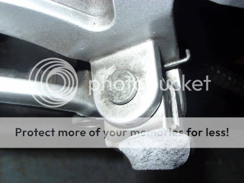

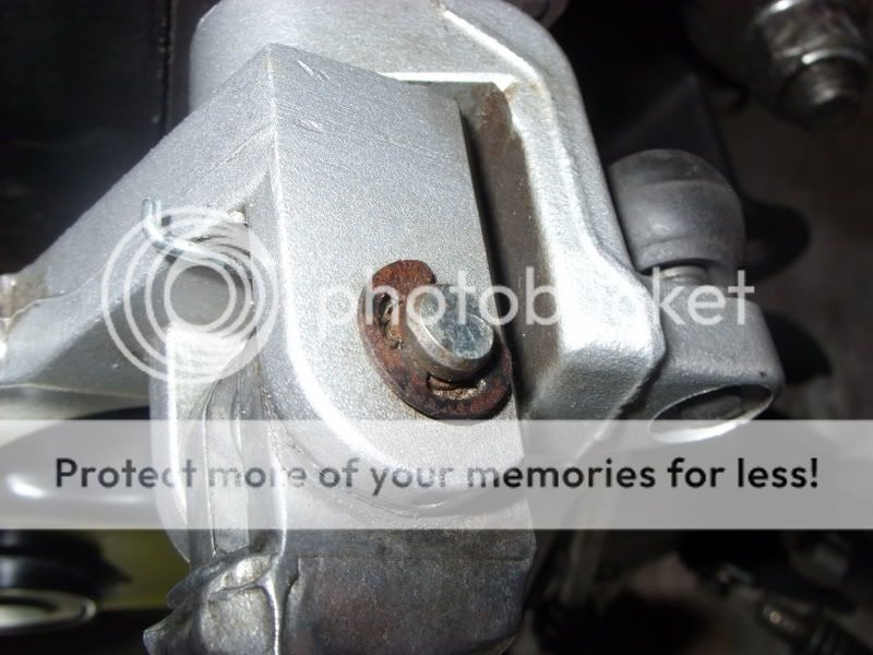

I have to replace my left footpeg as it has snapped off. The thing is, I have no idea where to start! Looking at it, I can't see any nuts which would allow me to loosen it. Here's a picture of both sides:
https://i4.photobucket.com/albums/y118/Wonderboy_001/SN851479.jpg
https://i4.photobucket.com/albums/y118/Wonderboy_001/SN851480.jpg
The pictures are magnified quite a bit.

Remove the circlip in the bottom pic,then push the bar/peg throught the hole upwards and the foot peg will fall off.

If you prise the black rusted (washer like) part off from the bottom the bolt going through should then just come off with a light hit.

https://i187.photobucket.com/albums/x13/fronterapics/SN851480new-1.jpg
Pics explain things easier. Laughing

Got the old one off now! Semi-fitted the new one, put the spring in, but I guess I'll need to buy a new circlip thing? (the rusty bit)

Shouln't need to,just re-fit the old one...
