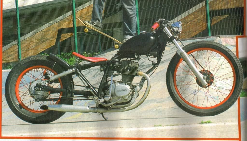

And after finding this pic i thought i might be able to do something cool with it -
https://i349.photobucket.com/albums/q399/beatnck2/Honda125.jpg

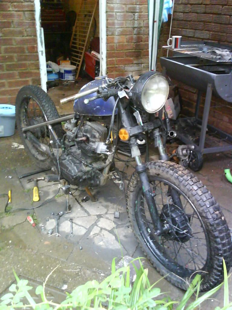

So, here she was when i got her home -
https://i349.photobucket.com/albums/q399/beatnck2/me008.jpg

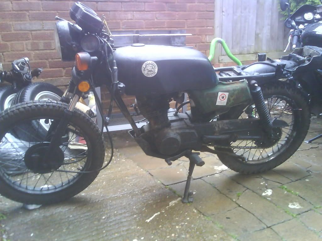

And as she stands now -
https://i349.photobucket.com/albums/q399/beatnck2/DSCF1773.jpg
There a long way to go yet, but the plan is to hardtail it, sprung seat, have only the minimum to get it road legal and a simple but classy paint job.

if your chopping the arse end off and doing some subframe tweaking then you can get it lower than that I think mate. see how high up the swingarm will go before the chain starts eating the bottom of it, then lift it back up about 3 cm and weld the bugger there.

Why hardtail it when you've got the shocks right there sitting there ready to copy the pic you posted above?
Just weld on a bit of tubing where the seat ends, and attach the shocks at that angle. A sprung seat will be necessary as well of course as the suspension will be rock hard. The peanut tank is nice too.

John, the pic showed the bike with just the shocks removed, so yeah, hopefully i'll be able to get the arse end lower.
I'd rather hardtail it (rather than copy the bike in the pic) as that way the wheelbase remains the same - the bike in the pic has had the swingarm lengthened.

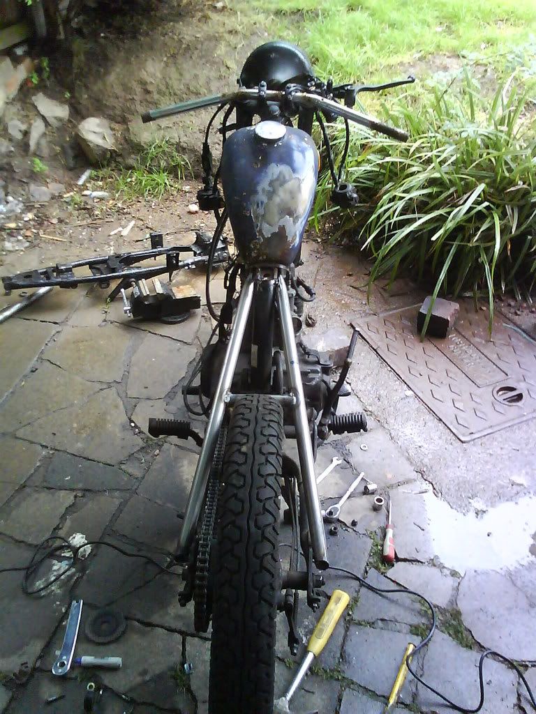

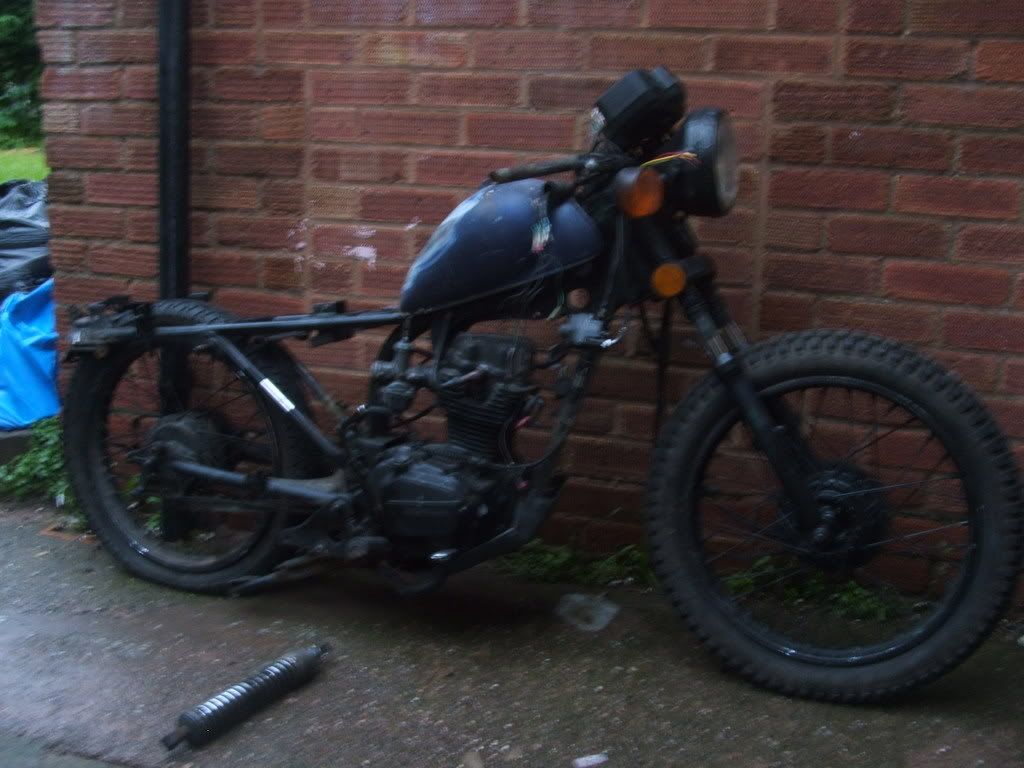

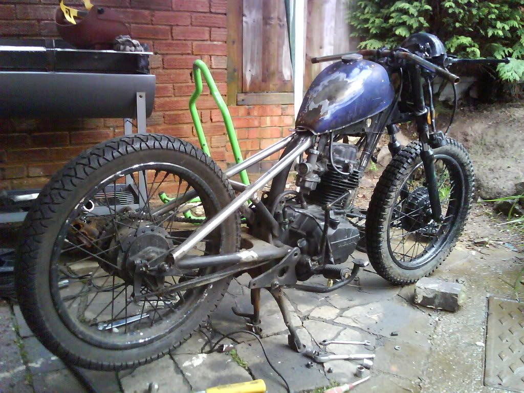

Ok, the frames is pretty much done now. There were some issues on where to weld the new tubing because of clearence issues with the rear sprocket, but its sorted now.
Next job is to finish off the frame, then start trying to make the fuel tank good.
So far im happy with progress, and its starting to look a bit more like a bobber i reckon Thumbs Up
https://i349.photobucket.com/albums/q399/beatnck2/DSC00301.jpg
https://i349.photobucket.com/albums/q399/beatnck2/DSC00300.jpg
https://i349.photobucket.com/albums/q399/beatnck2/DSC00299.jpg

that looks class mate! I never thought a CG could actually look good, but that's excellent!
virus
Joined: 17 Aug 2006
PostPosted: 19:26 - 06 Sep 2008    Post subject: Reply with quote
Looking sweet mate, what ground clearance you got there?
looks about the same as when we dropped the shocks out, but cant really tell because of the centrestand.
I feel a swancote run coming along once me you and jay have all got our projects done. Thumbs Up
The big question though, will you be running forwards?
Recon the current controls would be a bit too far back with the seat at that rough height.

Funnily enough we were discussing the merits of a turbocharged cg, unfortunatley both of the turbos are knackered and they are awaiting the next time the scrap man comes up the road blowing his bugle Shocked Laughing
Its running the lowest ground clearance possible without the chain fouling, im not really a fan of forward controls so im sticking with standard - plus you have to really keep standard controls on a bobber Cool .
